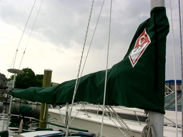

I found my 11oz Sunbrella on Ebay...

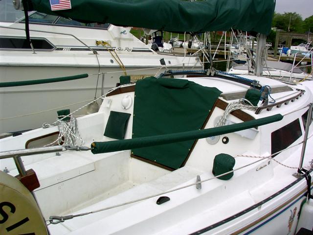

I lucked out and paid $80 for 20 yards long X 52" wide, it was the end of a roll from a distributor in Georgia. I unded up making covers and tents for everything on the boat.
Keep your eyes on Ebay, there are deals out there.

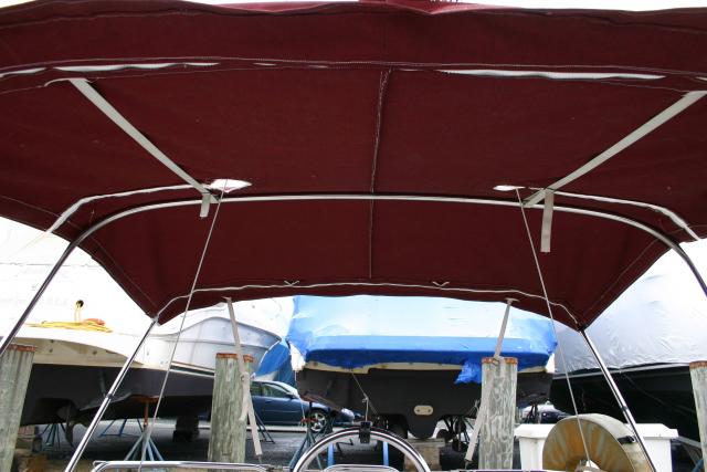

I'll let you all know how the purchasing experience goes with this ebayer. My Wife has an entire room in our house dedicated to sewing, but I thought I was going to have to buy my own machine and work in the garage LOL. I want to make a companionway cover, hand rail covers (S2's are different from most) and a cover for the forward hatch.
