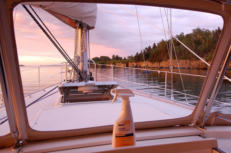

The best treatment I have found for dodger windows is Imar Strataglass Protective Cleaner.
It's not just me these are the only two products my canvas maker will recommend for use on his canvas work...
The only thing that has ever touched our dodger glass is IMAR and a clean, fresh out of the bag, Microfiber rag.
