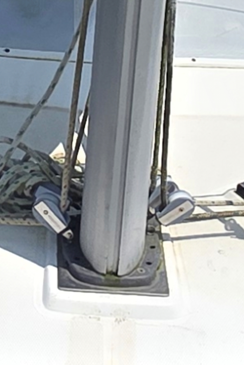

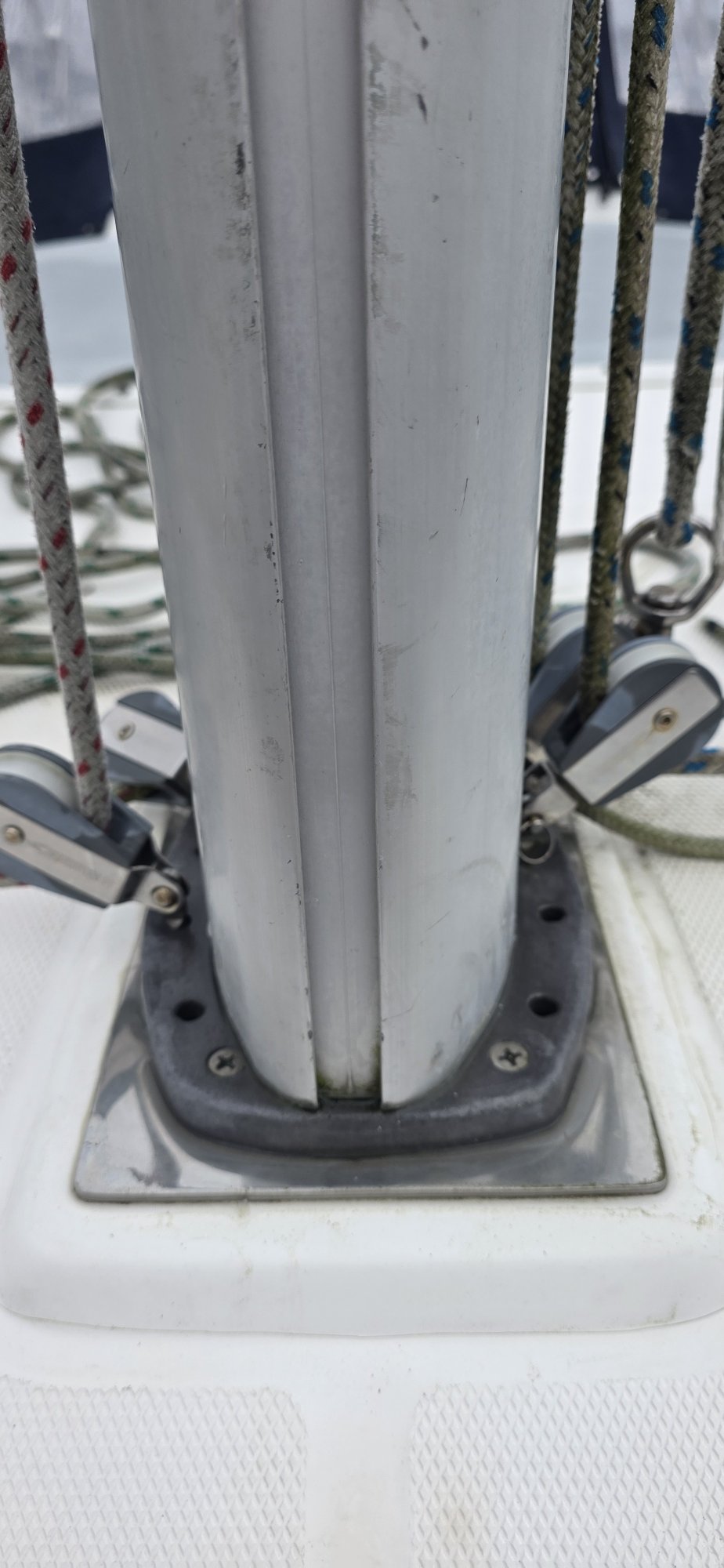

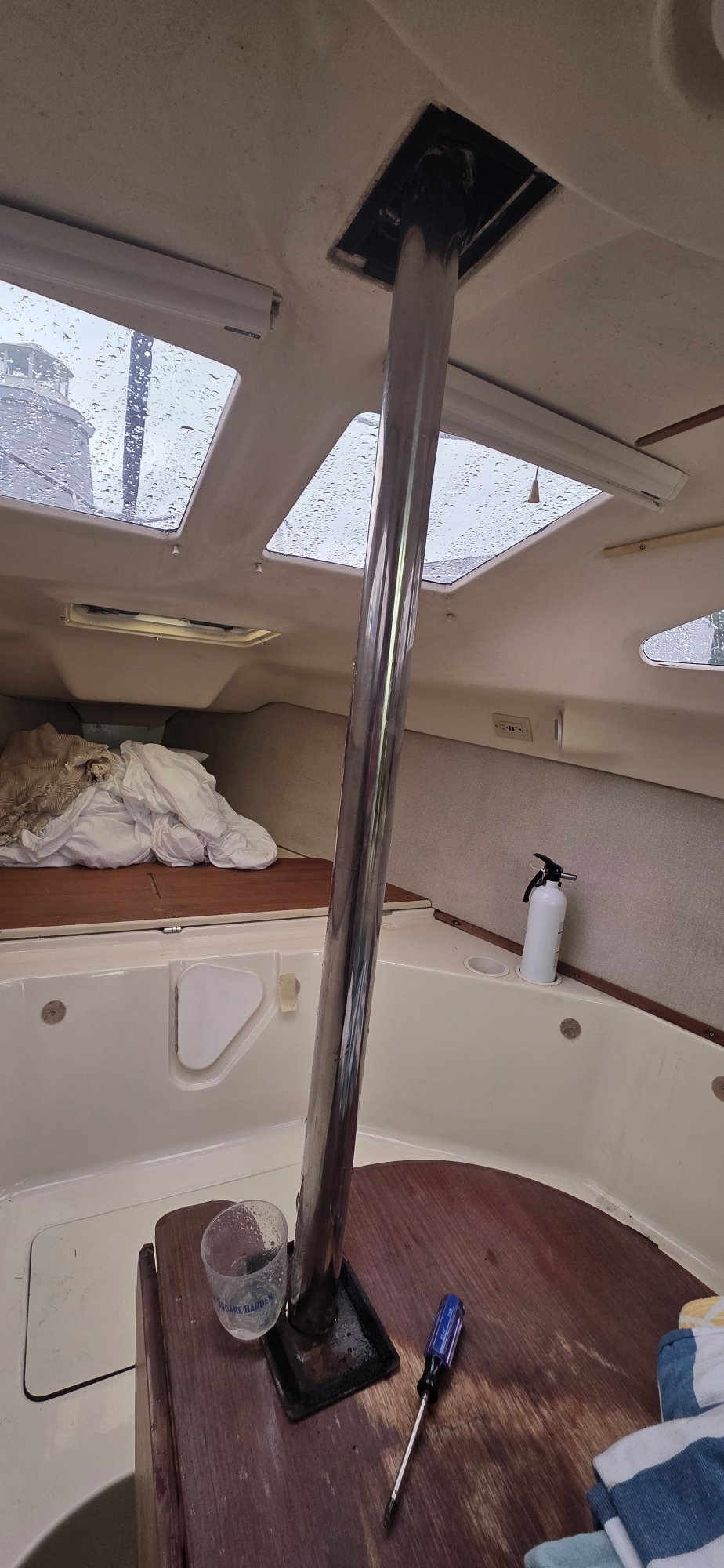

Have a lot of water coming through the compression post and leaking out of all points of entry. I have a hunter 280...seems like theres no weep holes in mast or step whatsoever.. How have others solved this...seems like a factory flaw. Drilling above the plate, as mentioned in some forums, seems like its not low enough or can never be low enough in order to solve this issue.
