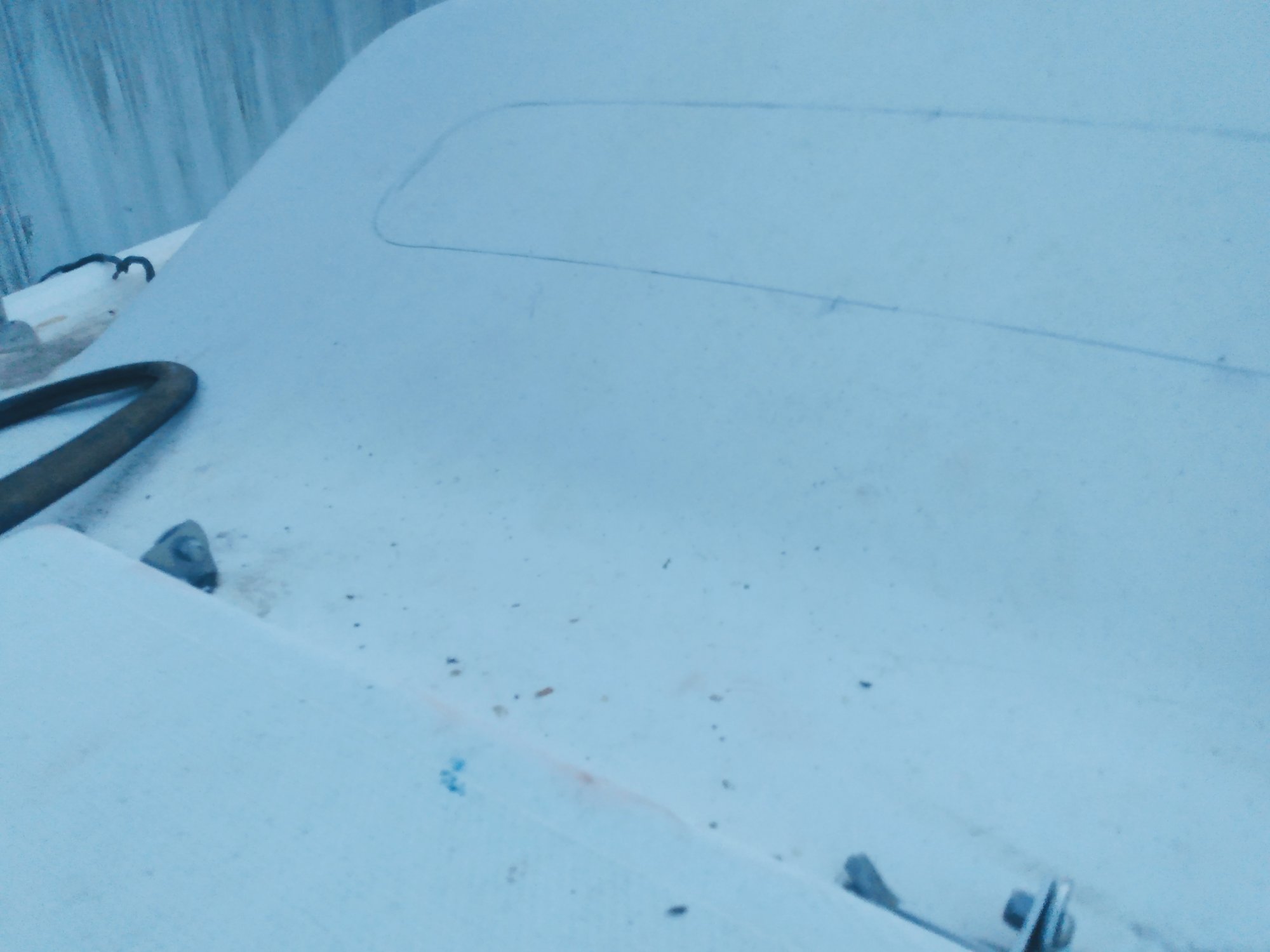

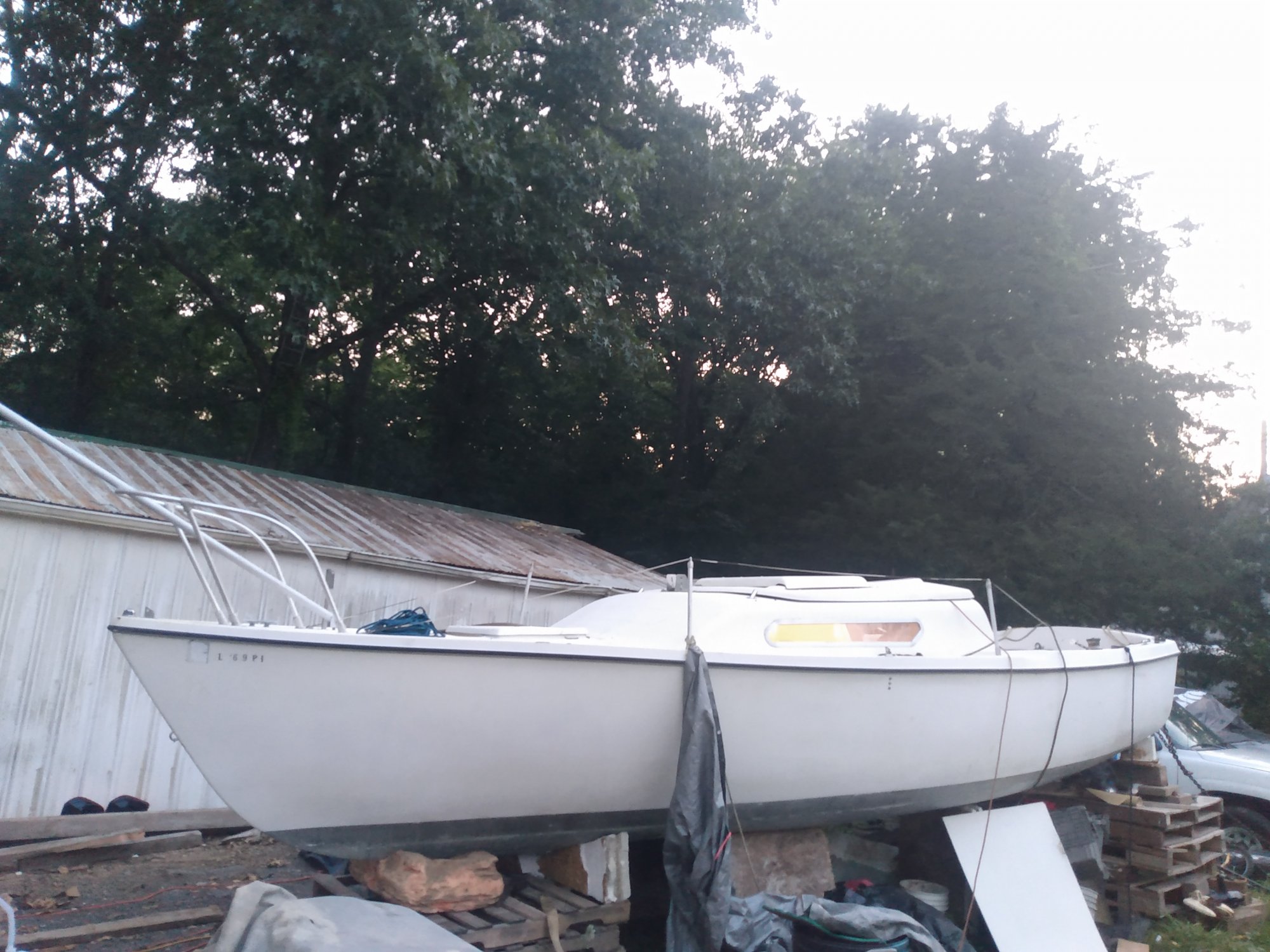

i believe i in fact am the owner of a venture 224. ill post pics of lola mae today. if you folks could verify my conclusion it would be most appreciated

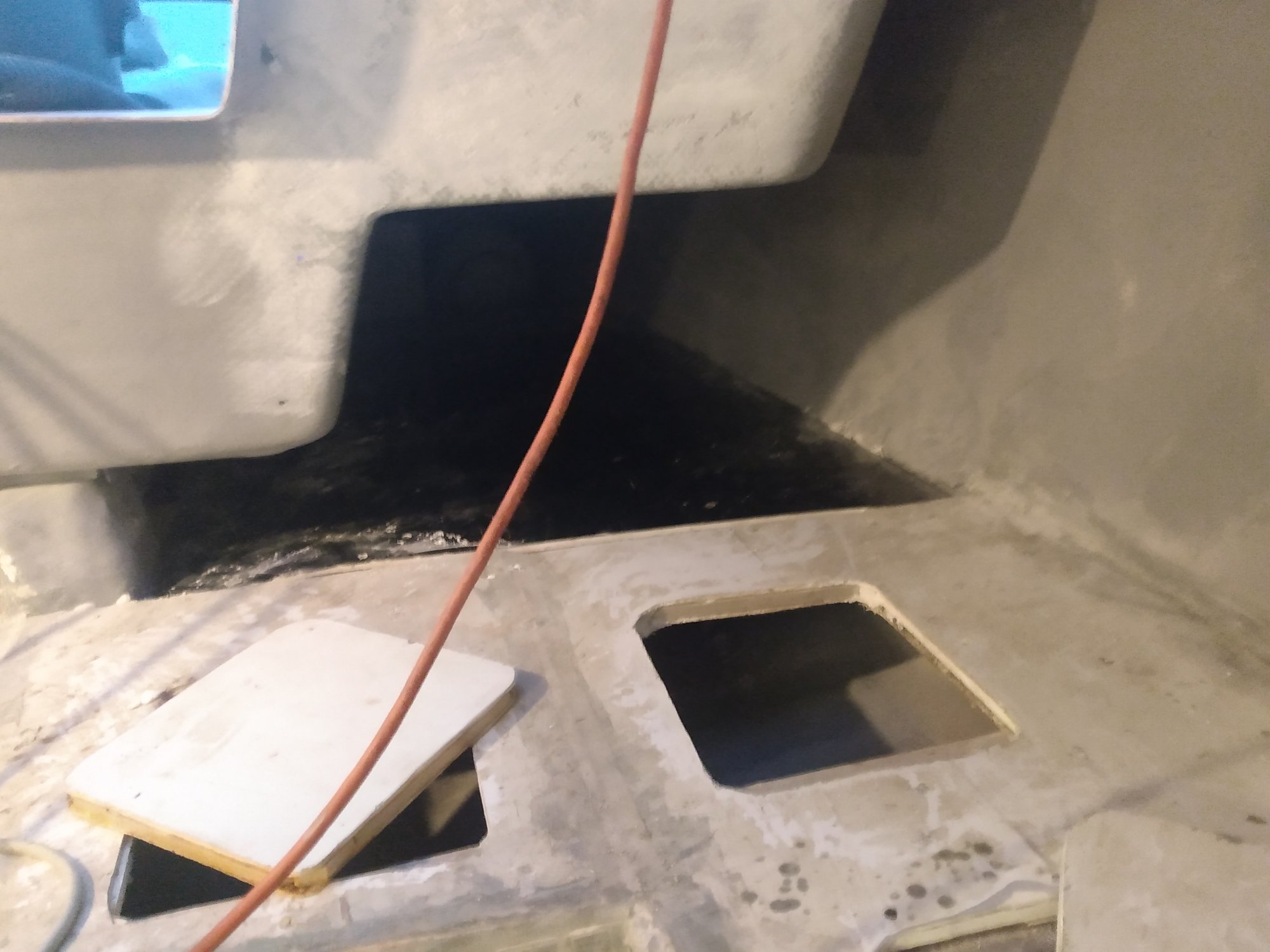

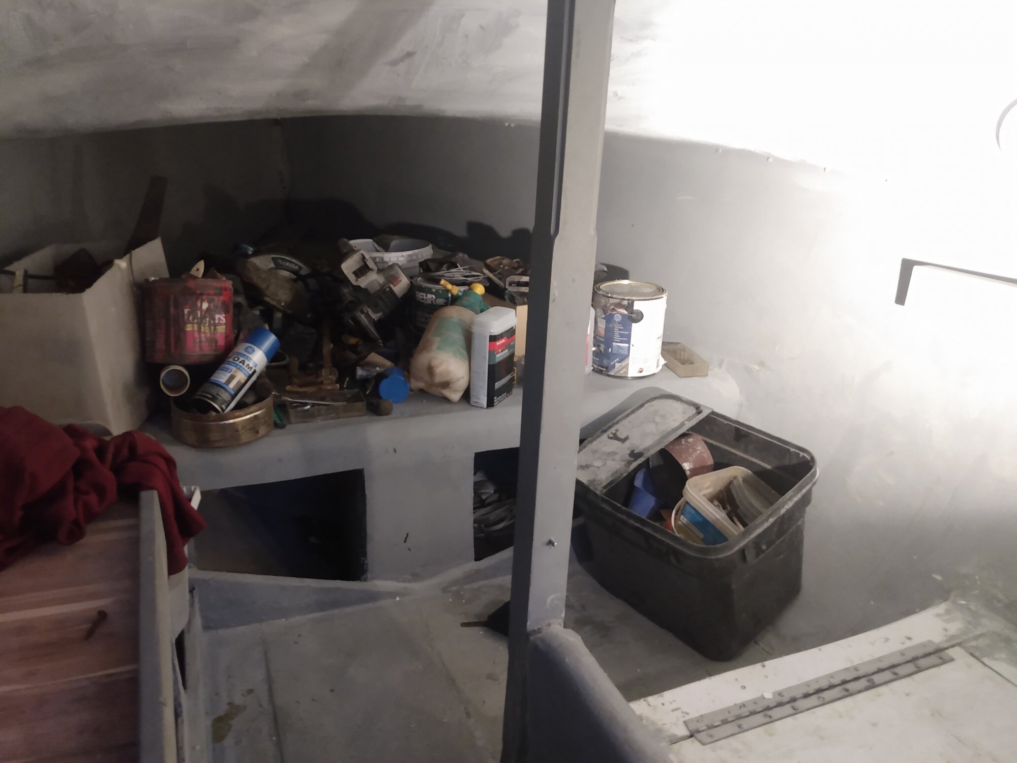

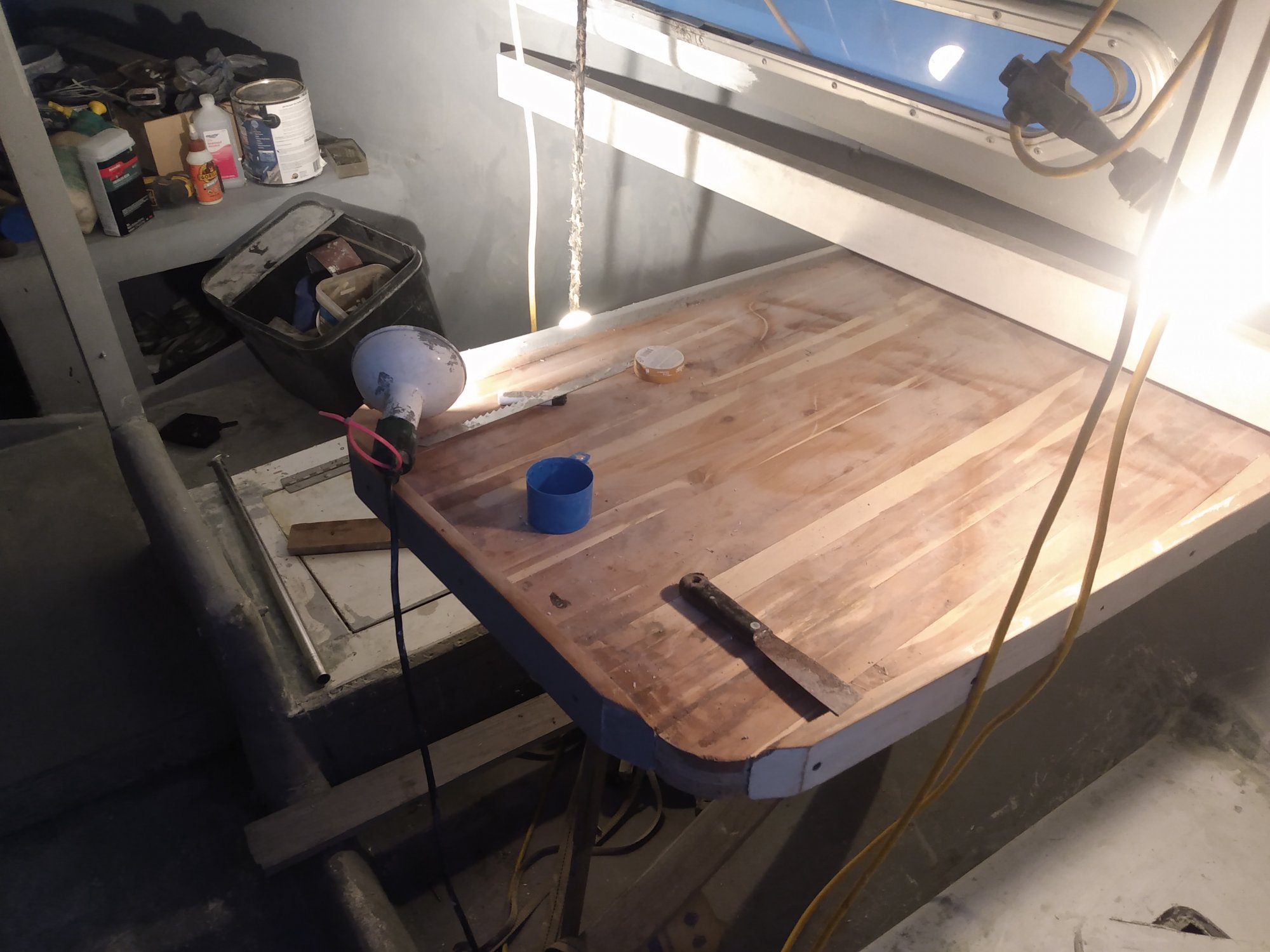

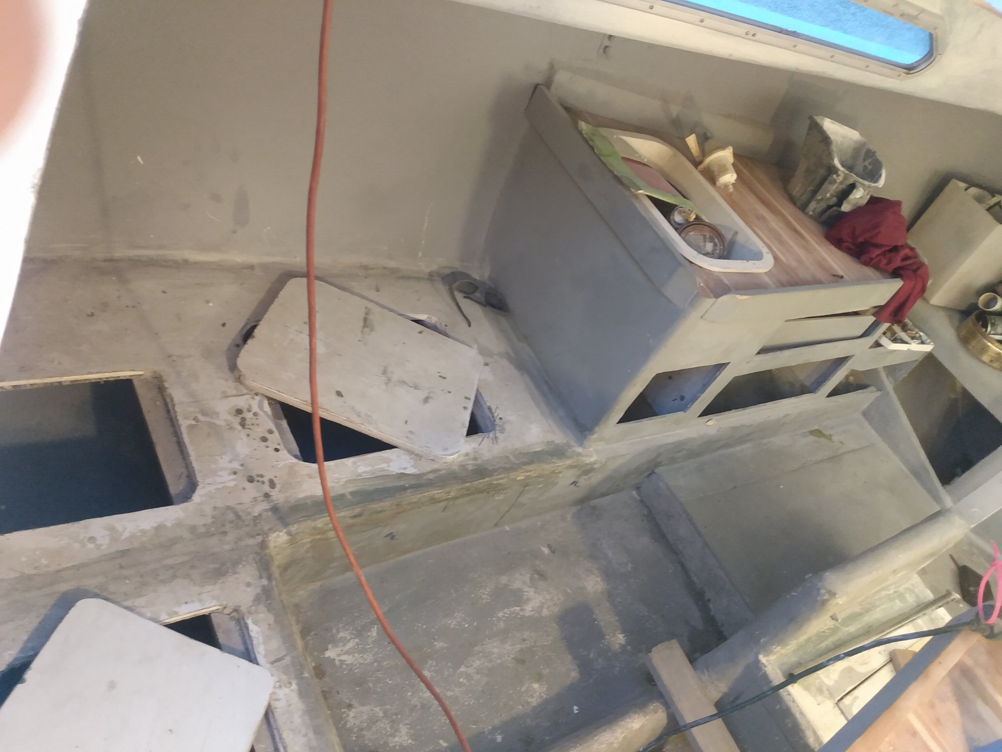

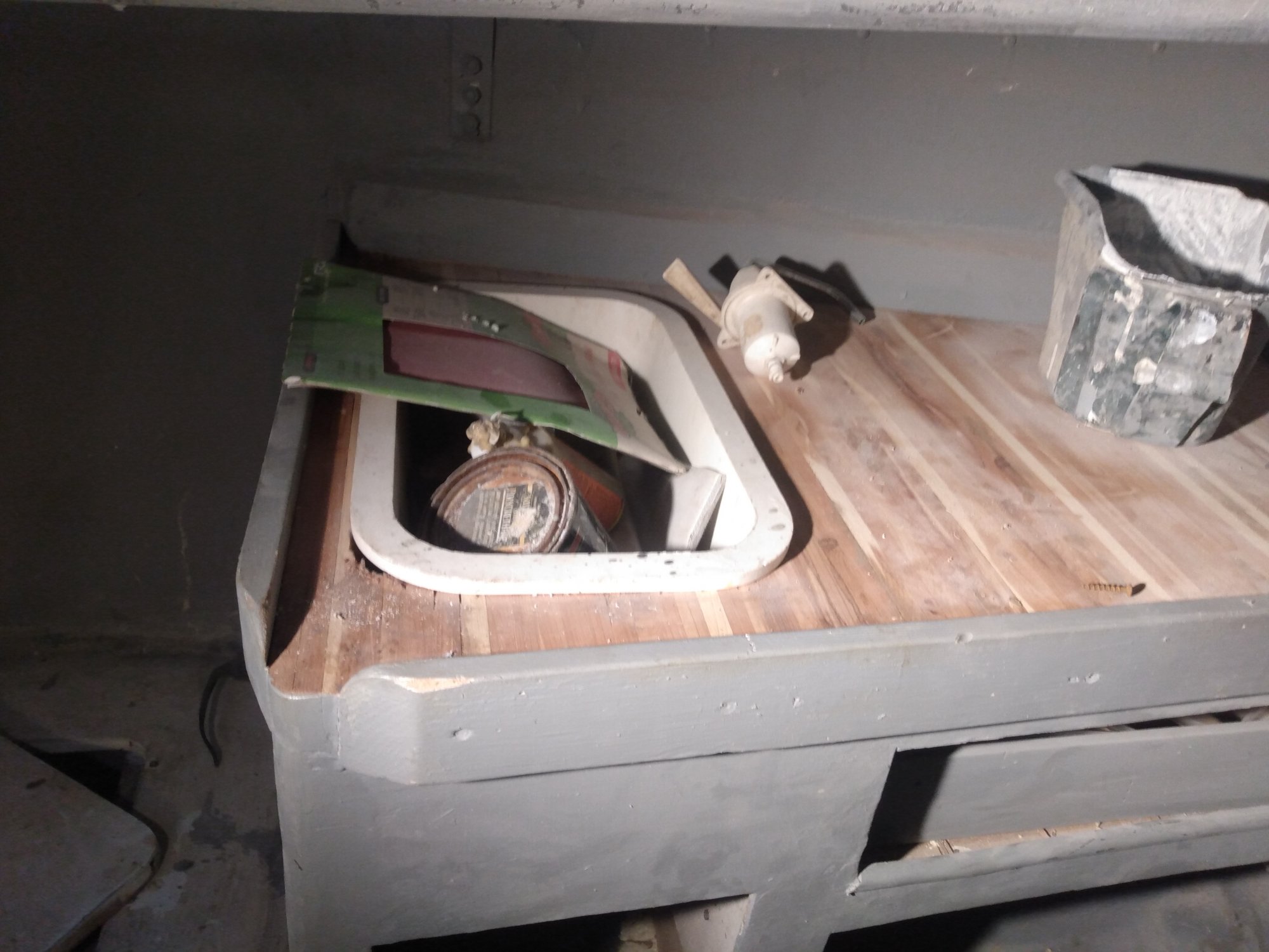

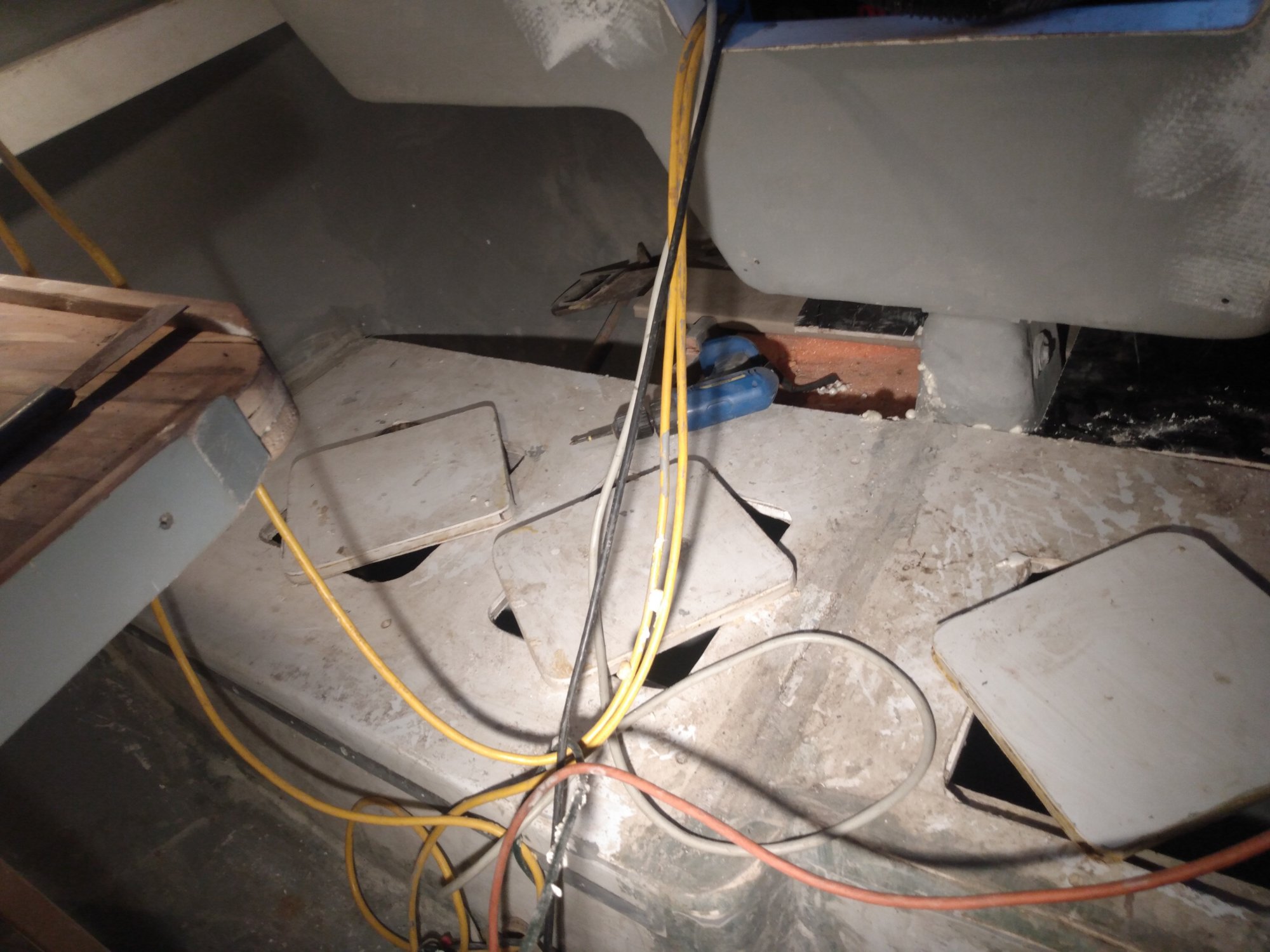

upon review i now realize these are terrrible photos. my appologies. as im refitting the interior i have used almost no wood at all. only the butcher block counters really. everything else is fiberglass or that composite material they make decks out of these days. marine plywood is just crazy expensive but i found i could get truckbed toppers and campershells that were fiberglass and were at least 3/8 thick or better for free so thats what i ve used. its strong and shouldn't rot so im kind of proud of that hack to be honest. its saved me several hundred dollars in refit costs. everything could use one more coat of glass but thats got to wait until next winter. im racing to get the lola mae sea worthy so i can drag her down to fairhope, al. i have a new grandson to meet and i intend to stay on lola and teach myself, the wife and youngest son some sailing basics when we're not with the rest of the family. i have a little 20 hp mercury to save my rookie self should i need it along the way. set up a small cooler area under the booth seat frozen food(dry ice). ive got a small inverter generator with a couple of marine batteries until i can go solar and both the gen and the outboard run on gas or propane. for now a good chart on the laptop, a fishfinder and a garmin for nav. non of its pretty or color matches(paint and matching upholstery is next winter). the keel looks like hell with 3 cracks with the top one closest to the hinge bleeding rust colored stains. its got one more season in it and it will get repaired in the winter as well. i know this well beyond "which venture 2? is mine" but i just wanted to bounce all of this off of some experience and see what yall thought. i dont know if you can see where im adding a window to the front of the cabin or not.

i still need a main and head sail as well. rigging and mast seem all there and functional

Def not a v22-2. Those have weird “scar boards” on either side of the forward cabin wall.
