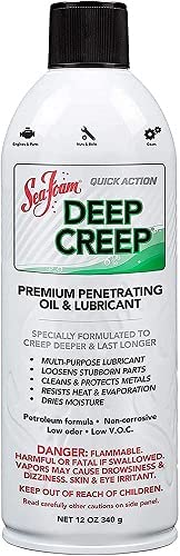

I’ll try a little antifreeze coolant on it. That’s always worked on really seized fittings before.
Brake fluid works too and rated #2 in a test.
There was a test using many fluids to release corrosion. This was number #1
PB Blaster was 4th.
Jim...
