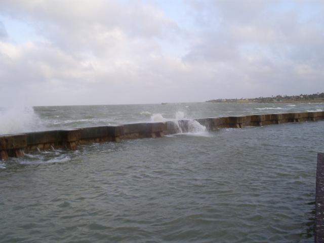

I wanted to drop by the boat and check the bilge and make sure there wasn't too much water. I was going to take a spin out one the bay and have lunch with my wife. But I couldn't get the boat unhooked and me on it at the same time. After I unhooked the bow dock lines I was hanging on to them for dear life because the wind was blowing the boat off the dock harder than I could pull it.
After I stood there for like 5 minutes waiting for a break in the wind, finally I pulled it back in and cleted it up. I think I could have gotten on but it would have been a difficult chore to bring her back in, so I chose to stay in. I don't think Jeannette would have enjoyed the trip anyway. So I did some work on the boat and then went home.
Does the wind ever get too much for you to even motor away from the slip?

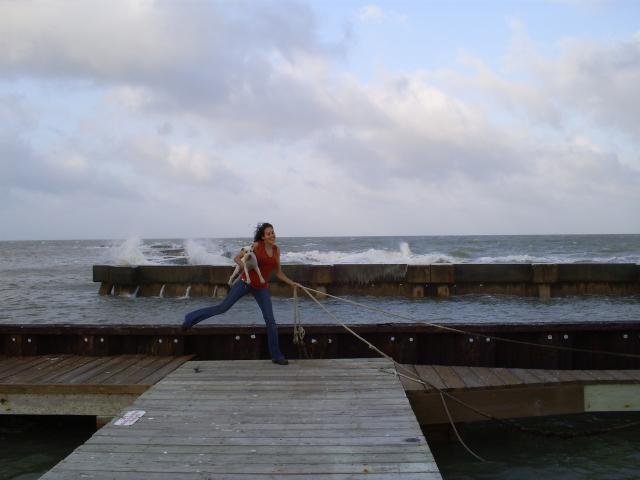

Leash the dog.
Teach your wife that you never pull directly on a line. The line always gets hooked around a cleat. To pull on it, reach down to the part that goes to the boat as far out from the cleat as you can and swig it by pulling perpendicular to the line and then pulling the slack in around the cleat as you let off the pressure. Tie a line to something heavy on the dock and both of you practice this. You'll be amazed what a heavy object you can slide around compared to just pulling.

I was like "what does leashing a dog have to do with docking a boat?" Then I looked at the pic. She was just posing in that picture with a rope that was on the dock. She couldn't have held our boat with both hands and both feet planted against the bulk head. The wind was fierce. I just posted those to show how the wind was blowing the waves over the breakwater. A lot gets lost in pictures. The wind was strong enough to blow my glasses off my face during a gust.

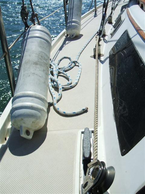

I do it differently on our C34: A midships spring line cleat on the forward part of our track, see picture below. The picture is of an anchor line being led back to a jib winch, also a good idea, but not germane to this discussion, just shows the cleat. From: http://c34.org/bbs/index.php/topic,4921.0.html Another good source for midships cleats.
Connect the spring line to the cleat, run it clear of the stanchions, use Nautiduck's idea of looping to the aft dock cleat, brings the boat sideways into the slip when in idle engine speed in forward. A great singlehander's concept and useful all over. Practice it and you'll wonder, like ATMs and microwave ovens and autopilots, how ya ever got along without it.
