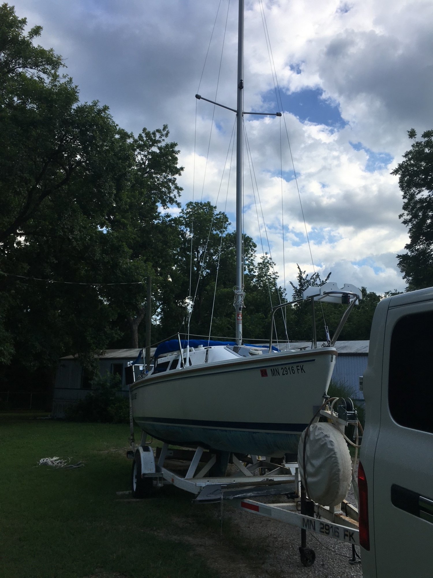

I posted the photo of the boat as it was when I bought it from owner late last year... so you can see where the bow eye is situated on the trailer. I don't know how he got it up to there ever.. or why it is like that?
So I knew this time would come and I wouldn't know what to do. When I took the boat off the trailer and into the lake, the bow eye got caught up on the bow stop and was holding the whole boat up by it for 10 seconds of so until I went far enough in the water to get the whole boat off of the darn thing. My truck was pretty far into the water at this point but was only way I could figure out to get the bow eye "unhooked" from the bow stop. I figured this is what would happen here too and It unfortunately was. Seems fine but I need to change either my technique or my actual bow eye placement or maybe move the bow stop up on the trailer... or get a new trailer cause it ain't gonna be easy on the trailer I have to do that.
Am I missing something or doing something wrong... or is it the bow eye that sit right on top of the bow stop that is the whole problem and just an impossible situation as it is right now? I attempted to get the boat on the trailer and the bow eye was like 2' lower than the bow stop and didn't seem even close to getting up there without trying to pull the boat up that whole way, out of the water, with the winch to force it up? Didn't really want to have to do or try that until I knew I might need to.

I'm a little confused on how it's supposed to be but this doesnt look that bad in the pic. I've heard of many C22 owners short stopping to make the boat move forward or back on the trailer. You might be able to back it up, put some tension on the winch line (with it properly routed above or below the roller) and then short stop it to move it forward again. Once again, I might not have a thorough understanding of what is and what is supposed to happen
Sep 30, 2025
222
Catalina 22 Davis Hollow - Lake Arthur
Sorry for the confusion. That is just a photo of before I put it in the water. That's a photo of the boat was when I bought it late last last year. Its now in the water and I cant get it out cause see how the bow eye sits right on top of the bow stop.

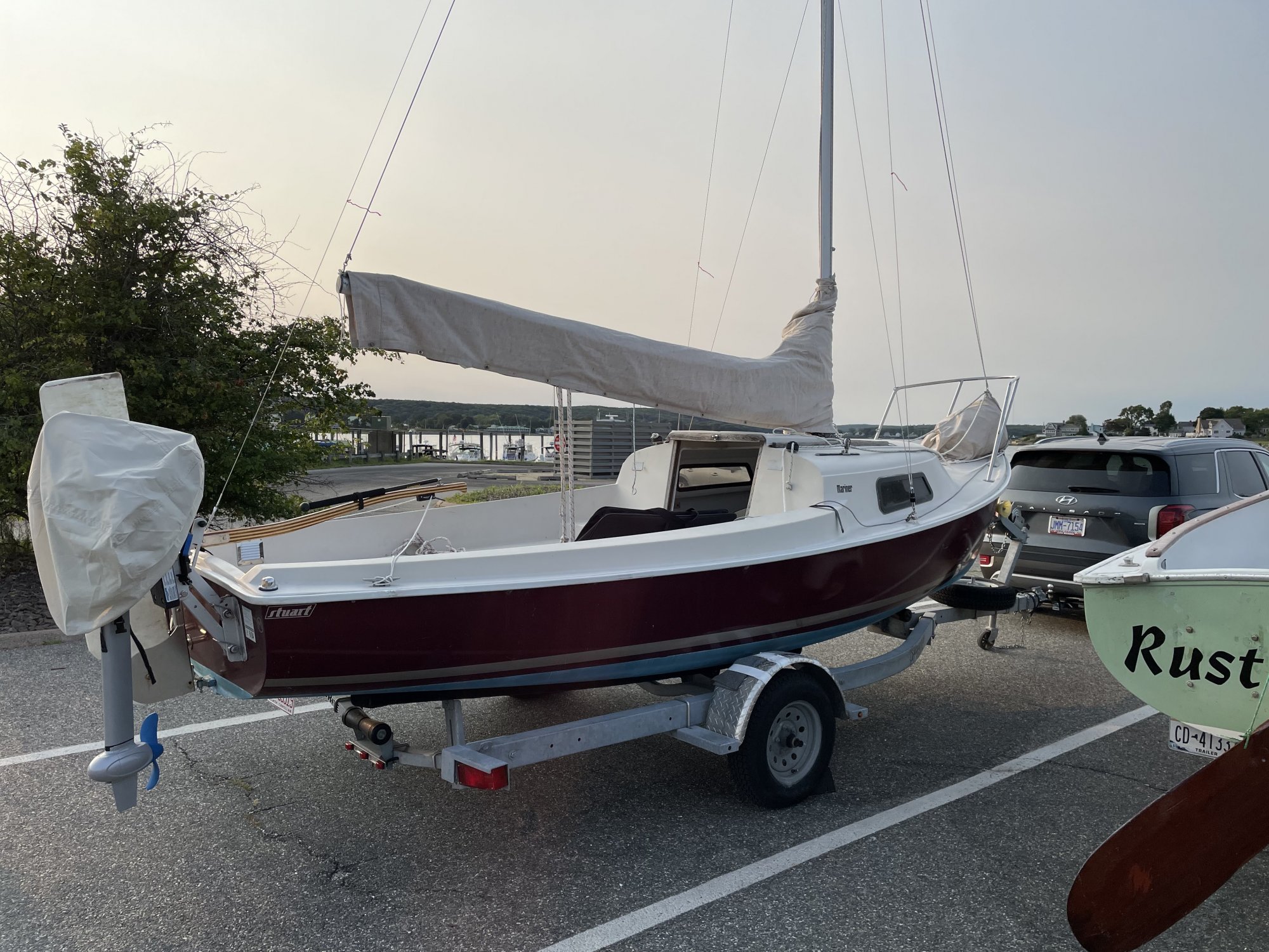

Put a tongue jack wheel on the extension to support it. Also, when attached to your tow vehicle on level ground, the boat trailer should be level - neither tongue up or down. Raise/lower the hitch ball as necessary to make it so - there are numerous models of hitch bars to do just that.
The photo is of Sweet P ready to launch. Note bow eye is below roller, trailer is level, and there is a tongue jack wheel for moving trailer without being towed. I had to install a 6" rise bar on my tow hitch to get the trailer level with the Palisade. In case you are wondering, the carpet on the wheel fender are to prevent the hull from banging when trailering - the clearance is that tight for easier launching. And the stern trailer roller doesn't support anything except the bow during launch and retrieval. Lastly, photo is pre-goal posts. I learned of the need during retrieval on this trip.

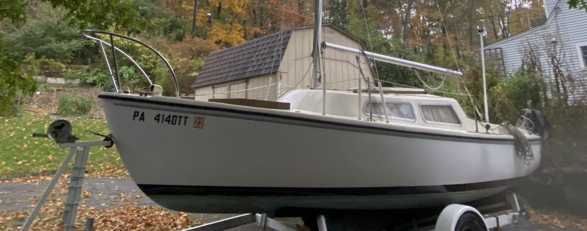

This is how my bow eye sits on the trailer:
I'm not seeing anything particularly wrong with that position. Am I missing something?
dj
Oh - just realized that was not the OP posting and that's a photo of a well placed bow eye and winch... so yeah. I am missing something... not the first time...

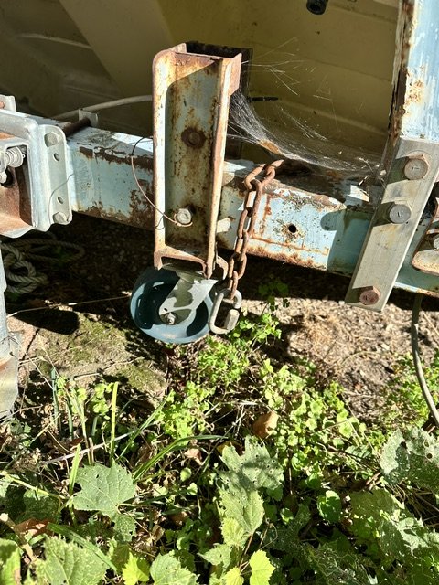

Okay so update. Thanks by the way for all the help and suggestions!
I tried it again as it was and I really had no luck with anything I tried on my setup. Its a weird setup. So I said F-it and just drilled another hole in the bow and moved the boweye down about 8". I then took the boat out like it was nothing. I did end up having to get the bunks pretty much underwater still but it was not a problem. Worked on it for a few days on the hard and fixed some stuff, and dropped her right back in the water as smooth as butter. She just slid slowly off the trailer and right into the water All I needed was to get that boweye down below the trailer V and it was so simple I couldn't believe it. Did it all single-handed to and didn't even break a sweat. :cool:
Now just curiosity....why in the world would the PO have had it like that? Is there some weird launch technique or different types of ramps or put ins that the bow eye above the trailer v would work with? I just cant wrap my head around why it was like that and how anyone could make it work like that?
But all is good now and I don't stress at the ramp.
