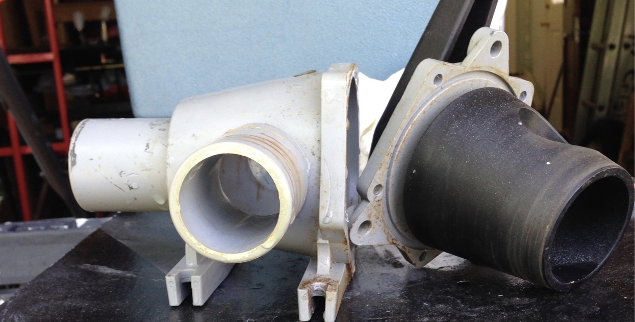

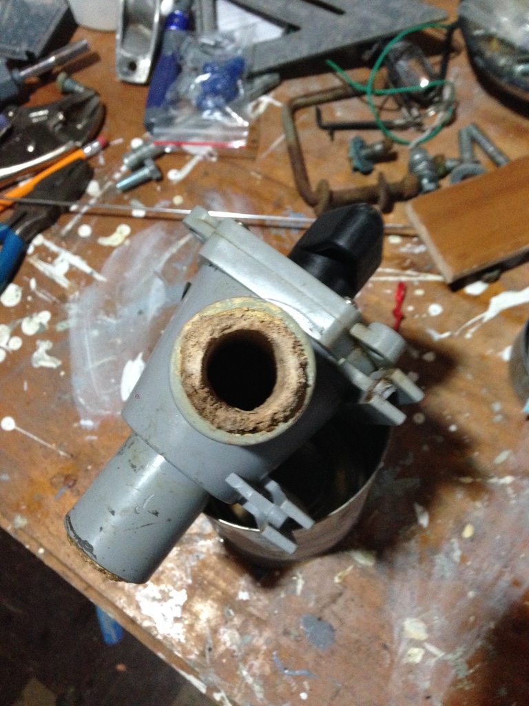

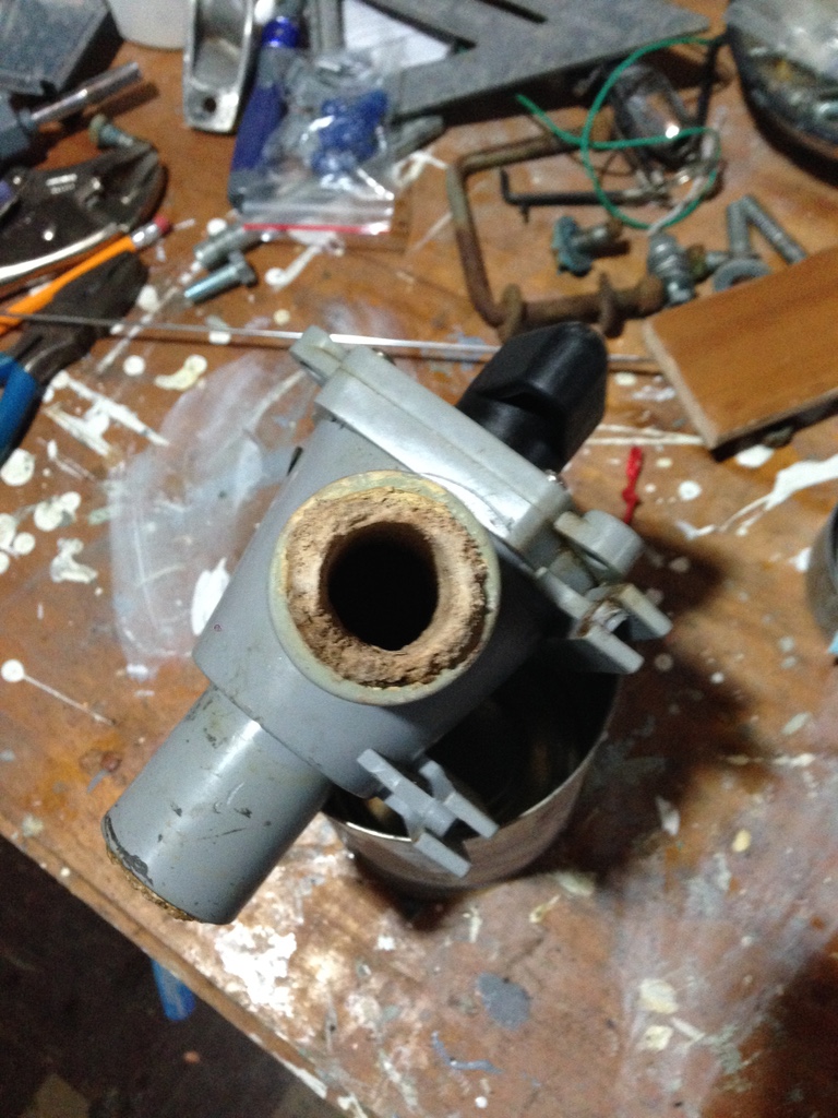

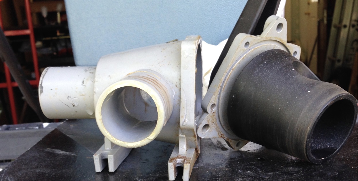

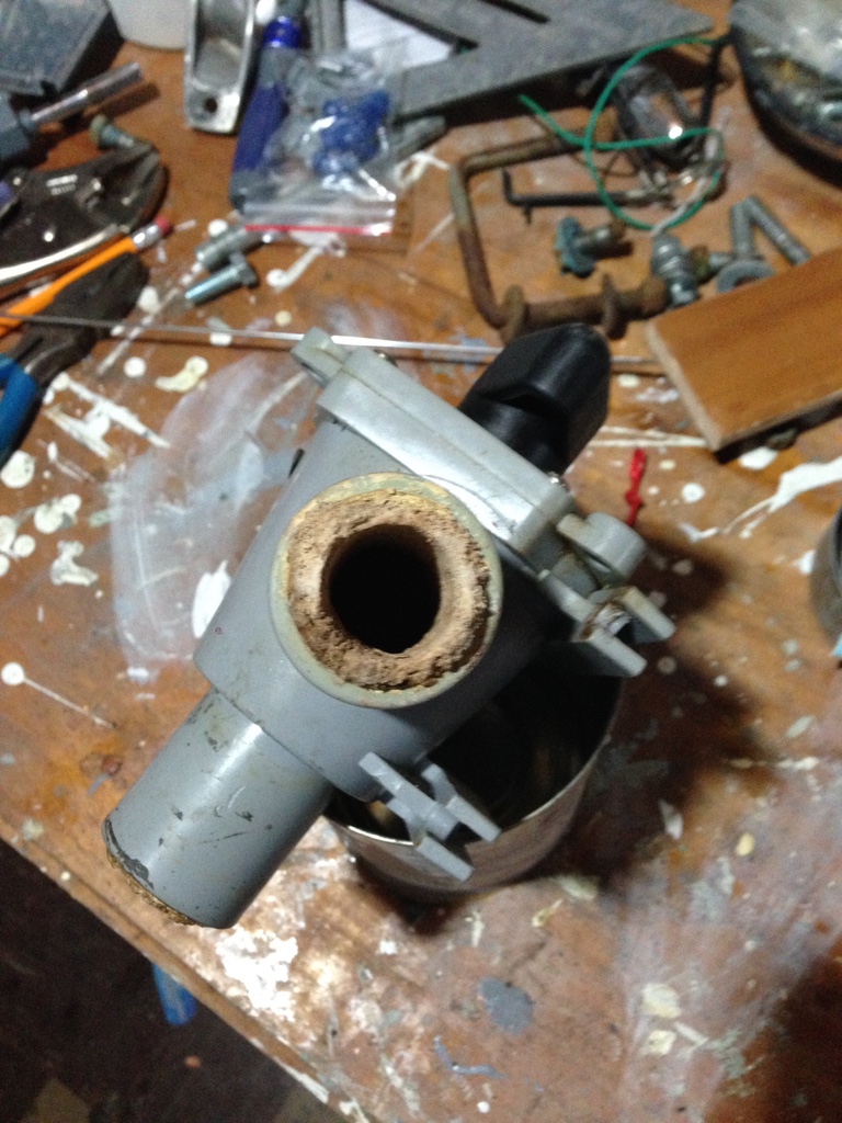

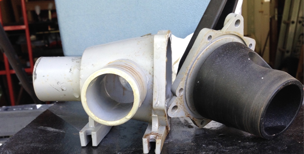

Saltwater and urince cause calcification in the sanitation system. This will clog pipes and seize valves. A coat hanger may not work. What does work is Muriatic acid. This will dissolve the calcification and allow the valve to open or unclog the pump. I had this happen with my direct discharge through hull. I injected some Sew Clean into the hose and the valve loosened up and worked. It did take a few to work.
When I bought the boat the Y-Valve was almost completely calcified. I soaked in a bucket of Muriatic Acid and it cleaned up nicely.
