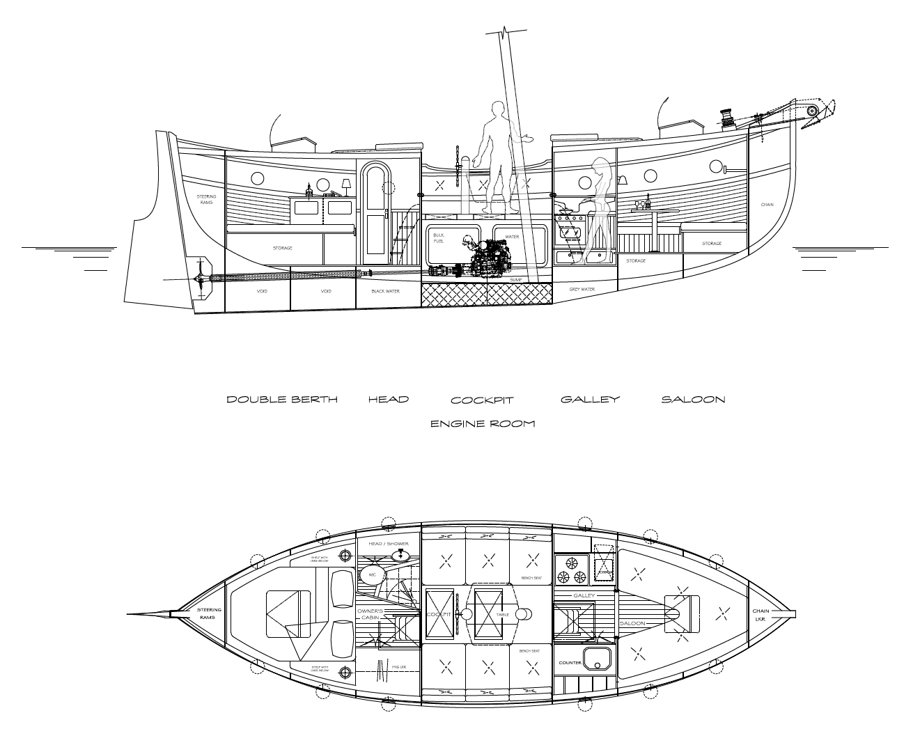

There are plenty of comments that come to mind. “Why would ya?” Or “The Feather” by Henry Gibson (
On a serious note, the Bow rudder as seen in the photo has been discussed among boat designers (Bow Rudder Possible?) and tested like front and rear steering on cars or canard winglets on planes with varied success. These innovations often generate discovery that a ‘good idea’ requires other changes to make it work. Sometimes making the fixes negates the perceived benefits.
I say, “have at it”, on your boat.

"Being a double ended boat there is perfect balance when heeled. In other words, unlike a transom stern boat on which the heeled centerline shifts to leeward at the stern, with a double ended boat the centerline stays on center when heeled. On a transom stern boat, when rolling the shift of the CL astern (but not at the bow) induces yaw, which results in difficult steering control. By contrast, the inherent balance provided by a double ended hull shape does not induce any added yaw, therefore providing greater steering stability, and much less weather helm under sail."
33' FREYJA - A Pelagic Sailing Yacht
There is some interesting information on double enders in the site linked above.

nice design Will. like the drawings.

Oh come now Jon. Haven’t you wished your could slip that yacht into the prime minimal space left between a couple of yachties on the pier in front of the restaurant. Just come up parallel, rotate Rudder and slide in between the tie up hogs.
@jssailem
I don't think that is a bow rudder. YOu can see the prop is just before the rudder. I think that is a boom sprit for a yawl or ketch rigged boat protruding off the back and not a bow sprit.

i did notice on will's post that a shapely woman is in the galley while the male captain is commanding his vessel. that's an old school style. must be another clue. the canoe stern vessel is about beauty, style, ........ and many call their sailboats "she". could be on to something.
