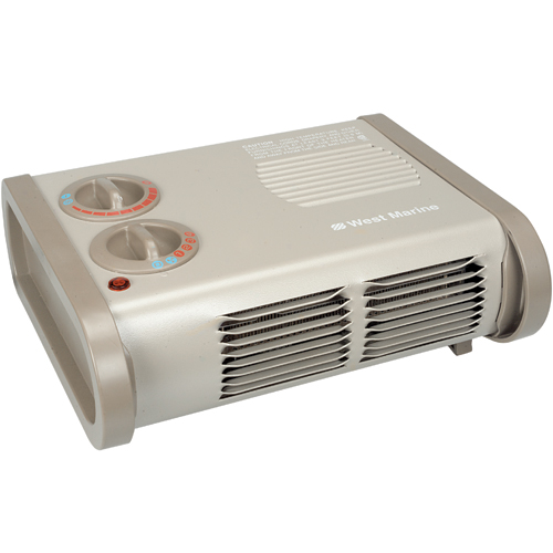

I live aboard in the PNW on a 50ft sailboat. It has a 5000 BTU Webasto forced air heater that blows into the salon from under the companionway, nice and toasty when at anchor, but expensive for daily use in the marina. I added a 2nd 30 amp service to drive 2 electric heaters I keep under the salon table. One is the oil filled radiator type, the other a thermostat controlled ceramic type. I also have a 3rd small ceramic heater that I put outside my shower door before and during my showers. Its on its own ELCI breaker on the boats main AC circuit. I don't bother heating the cabins, I like it cool when I sleep. All three electric heaters are rated at 1500 Watts, but 2 draw 10 amps at 115V, the third is 13 amps. My water heater also draws 10 amps BTW but only cycles on once or twice a day and not for very long.
I turn the heaters off/down at night, and it takes them awhile to rewarm the boat in the morning. On really cold mornings I may turn on the diesel furnace to speed the heating.
