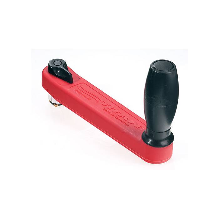

Hi, maybe a dumb question, but are winch handles interchangeable on sail winches? Ok that question is probably too general. To be more specific, I'm thinking of purchasing Lewmar's Titan locking winch handle (#29145311) and using it with a Harken winch (#HB6A).
1st, will it fit in the Harken winch?
2nd, will the lock feature work?
There doesn't seem to be any general literature stating any kind of compatibility between winches and handles.

The winch handle will fit in a Harken winch. The sockets have been standardized for decades. The locking feature is only a small piece of steel that rotates with the thumb lever that slides under the socket. If for some reason it doesn't lock, the handle will still work. Mostly I find the locking mechanism to be a PITA. In 40 years of sailing I've never been on a boat that has lost a winch handle and that includes a lot of races. I get more frustrated with the locking mechanism when I'm trying to release or install the handle, much faster to just stick the handle in the socket and not deal with the locking mechanism.
If you are worried about being without a handle because someone was careless, the floating winch handles are fairly in expensive to carry as a spare. Even though they float, you will never be able to find one that has gone for a swim, consider them expendable.

It'll fit. Buy it. Not because it floats though, I have one of those Titan's and it floats..... barely.... hard to see in the water. I like the palm grip handles. But I have 8 or more handles. The good ones are good. The poor ones only use if you have to. I don't know anyone that doesn't have one of those red floating Titan's... Lewmar owns Titan now. Harken and Antal make the most beautiful, in my opinion. I bought an 8" palm style when I installed my new dodger a few years ago and there were clearance issues. I have a big heavy Chrome 10" Lewmar, non locking, but it has palm grip. Really like it... it's heavy, though, never had a problem with non locking issue. I have a couple others, one Harken and two lewmars and a West marine (made by lewmar) with fancy touch lock mechanism. It's cool, I like it.... PS isn't impressed with the touch lock though.

Selecting the 'best' handle really depends on your boat and the type of sailing you do. On my boat, this is my favorite handle
The 10" model provides plenty of leverage. The palm grip allows you to grind with two hands. The locking function is important and easy to use (just squeeze the handle) . And yes, I have lost winch handles overboard. When racing, doing frequent tacks and jibes, it's important to be able to quickly get the handle out of the winch and then into the winch on the other size and then QUICKLY get the sail trimmed in.
