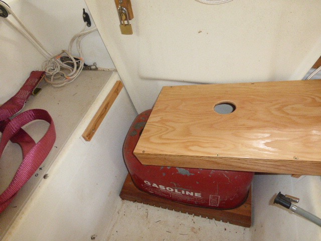

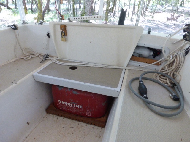

This is what I did. 6 gallon is fine. 9.9 Johnson sips gas. Motored from Martha's Vineyard to Fairhaven and still had 1/3 tank.
I used composite deck spindles for the frame, decking for the top and white plastic board for the front. Stainless hardware. Gas line run through 1" hole cut with hole saw then edge routered. Tank was a PIA on deck and dangerous if ever in a knock down.

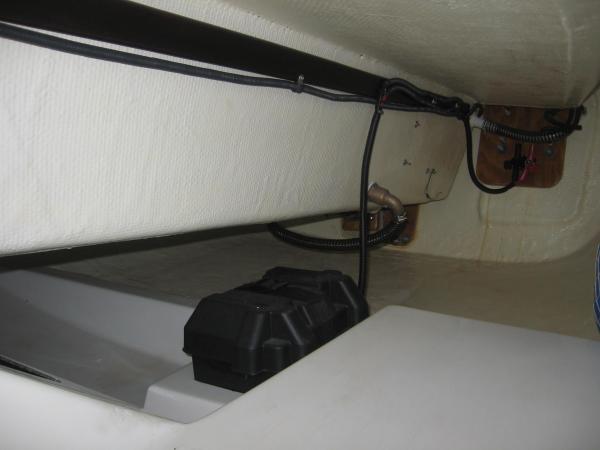

I built a permanent fuel locker that holds a 6 gal tank and two 1 gal fuel cans for emergency reserve. I have a fuel/water filter mounted in there too. The fuel line runs through the open area inside the back of the boat and exits the transom near the engine mount. The fuel line that is inside the boat is inside a larger hose, that is sealed off from the inside, so there is no way any fuel or vapors can get inside the boat.
Great job!!! With M25 isn't open all the way to the aft/stern of my boat. I have a fiberglass wall with large blocks of Styrofoam behind it, maybe like 2 to 3 feet.

Similar idea to others using a 6 gallon tank, which is more than enough for an extended weekend including no wind sightseeing, fishing (trolling) etc.
One point I would make is a 6 gallon tank fits well in that area, but if you're not planning an extended trip nothing says it has to be filled with the full 6 gallons!... just sayin. :)
I like this idea also. How is the cover/top kept in position? Also, I have a 3 gallon tank and I'm now planning on getting a 6 gallon and use them as needed. I plan on doing quite a bit of motoring so I shouldn't have any challenges of having old/stale fuel in either tank.
Likes: RussC
cover sits on cedar strips bolted to the sides. it just lifts off to access tank etc. the tank sits on a base frame, also made of cedar, which is routed out for the tank to sit in securely. drain slots cut in the bottom.
Thanks RussC for the additional details.
