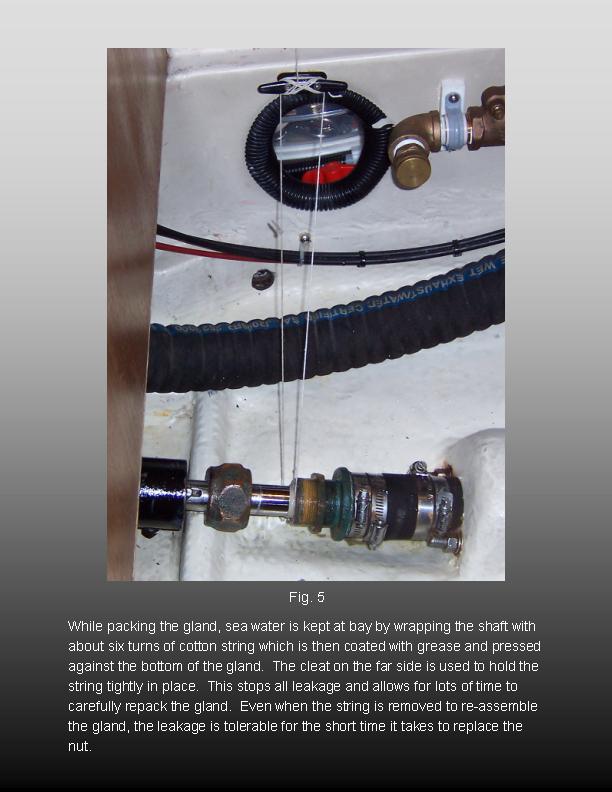

Greeting @milens777 and welcome to the site.
All of the above is good info BUT the best procedure is to STOP the water ingress rather than getting you sox wet.
If your gland is out in the open like this one, you've got all day to do the job.
