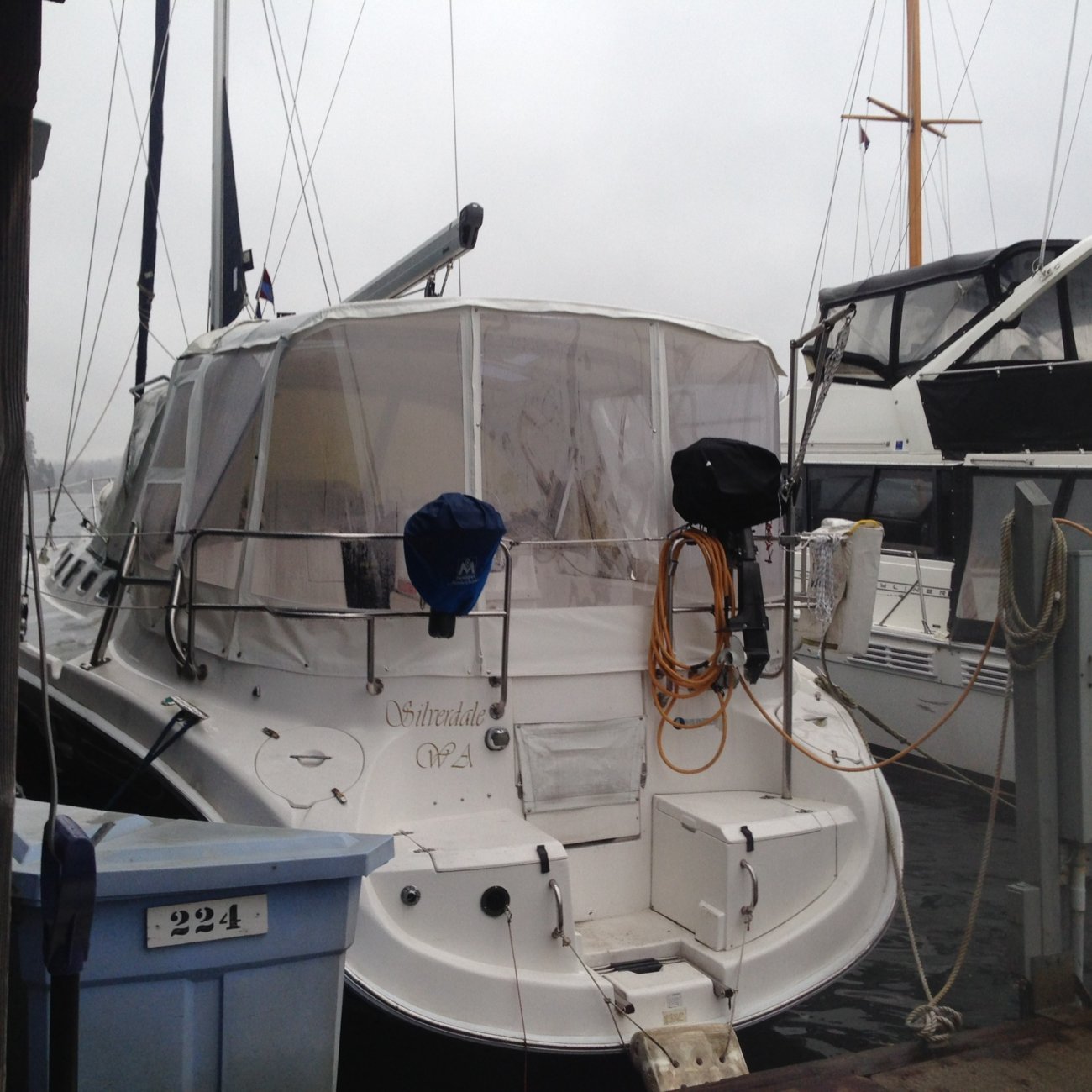

Yes. My walk thru transom has the ladder accessible from the water assuming the helm seat is in the at sea position. There are also grab handles that can be reached from the water as well.
Mikem
Dec 20, 2009
824
Hunter 466 Bremerton
Walk thru transom with ladder and grab handles visible. A real safety bonus. 751C489C-8813-45F7-9F67-93609CD31528.jpeg

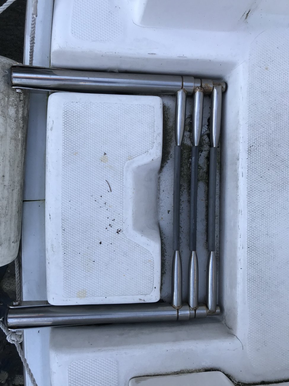

@Mikem if that ladder is anything like ours (exact same design) tell me how you were able to loosen up the clips that hold it closed to open it easily, I can't open ours by hand I need something to use as a lever to open it, but yes there are grab handles that are easily reached from the water.
Oct 29, 2016
1,929
Hunter 41 DS Port Huron
@Mikem not clips per se but the ladder lays in the recesses of the transom, ours seems to lock in place tightly.

I’ll take another look tomorrow. The few times I’ve used it in the past it deployed easily.

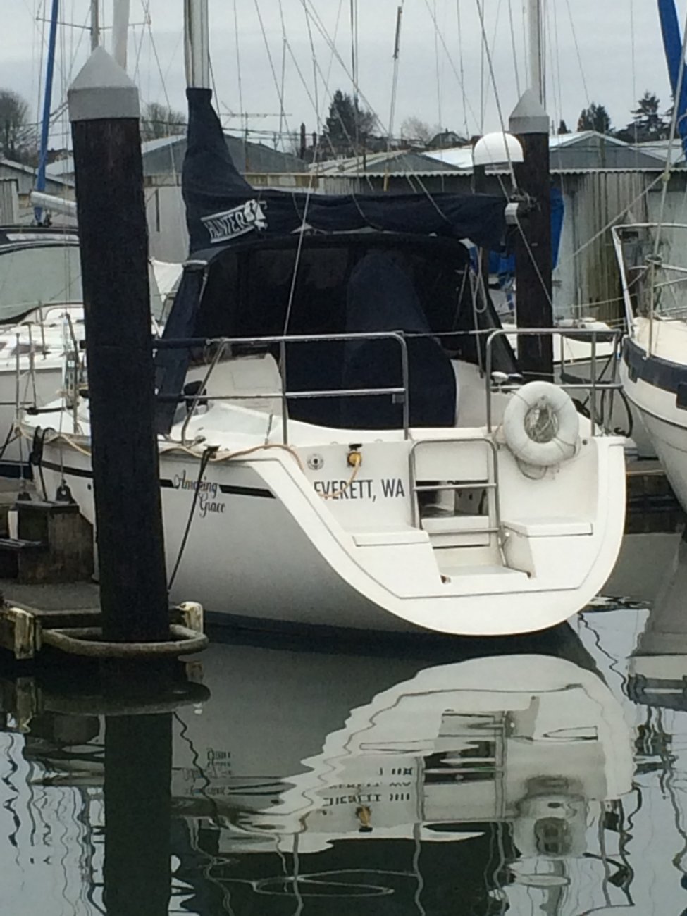

Ours cannot be deployed from the water. You can see the latch on the left in this photo. way too high to reach from the water.
However I can probably reach the lowest rung with my hands from the water, but would need to pull myself up with arms only.
Here is what we do. Our ladder will stay in place with just gravity holding it in place so we tie a line to a rung so the end of it is a few inches above the water (with a big knot in it for grabbing.) A tug on the line and the ladder tips into the water. In the photo, you can't see the line because it's on the LH side.

@Mikem exact same setup, ours once set down into the recess it seems to latch wonder why, will have to look closer, another item for the list.
