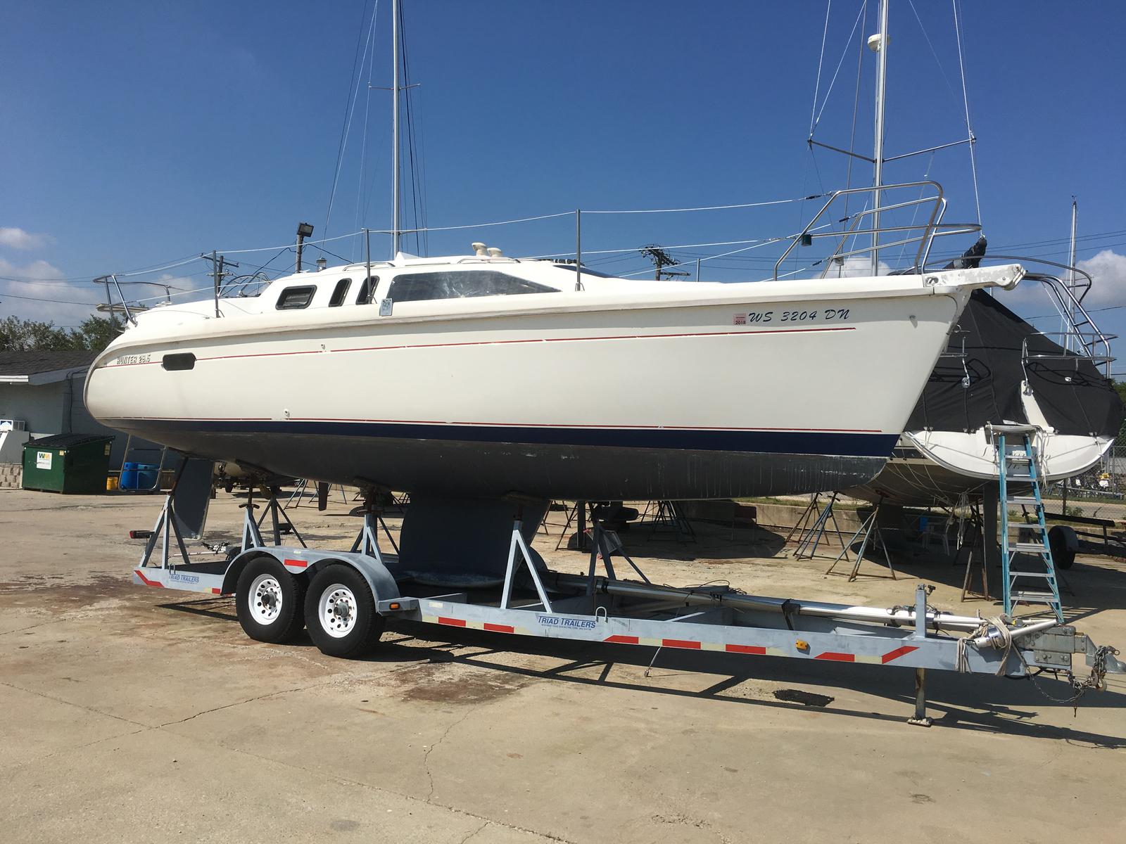

Looking for advice on a boat we are getting. Hunter 29.5, It includes this trailer. Is it possible to launch this type of trailer by a ramp? Or do I have to pay the marina $$$ every time I want to move it via travelift?

That trailer appears to be a transport trailer and looks like it is missing the bow support pad. A ramp launch trailer needs rollers to be able to launch and retrieve the boat. That boat I believe it's weight is too much to safely launch by a trailer.
The pads cradle the hull at different levels and can't be lowered or the boat would become unstable. The pads are placed at strategic points to support the boats bulkheads. Plus how to you instead to step the rig? The rig has a lot of waight and needs to be craned on to the boat.
If I recall that boat has a draft of approximately 4' and sitting on a trailer looks like you would require at least 5-1/2 feet to float off.

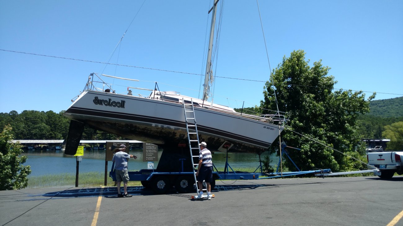

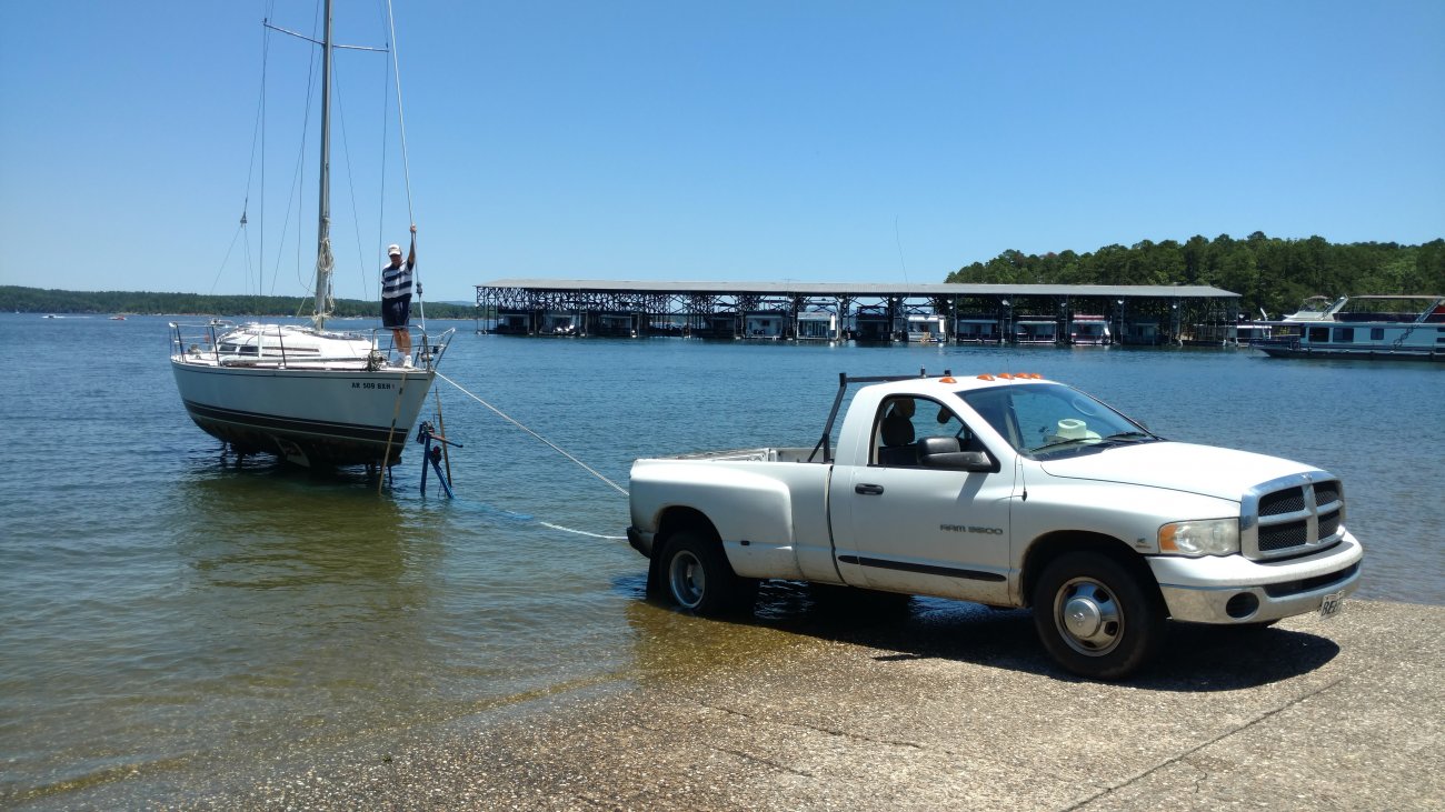

Yes, it can be done. Here is a pic of me pulling out a 30' boat with 4.5' of draft.
Notice how nice and level the boat is in the first pic.
I was somewhat surprised when we did get the boat up the ramp.
Take Twille's note of caution seriously. "Tie a line around the keel to the front of the trailer to keep the boat from floating back on the trailer while you are pulling it out." Don't ask me how I know this, I would really rather not relive that experience.
