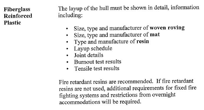

Has anyone out there looked into having a Beneteau 50.1 meet USCG Criterion for inspected vessel? I’m thinking of upgrading my Oceanis 45 ... and if I could run charters with more than 6 guests, that would tip the scale.
I understand that if the boat is fiberglass ... I‎t must be certified flame retardant. Also stanchions must meet certain specs ... etc ...

Most production boats don't meet the requirements for a USCG COI. I owned a ran a inspected sailing vessel for several years and there is a lot involved. You have to pass and inspection every year and a renewal every 5 years. Besides the hull needing to be made with a fire retardant fiberglass. You need a whole slew of safety features, like engine room fire suppression that is connected to the engine, only type 1 PFD, and if you operate more than 2 miles from shore, a life raft. The boat will also have to under go a stability test. Additional cost for insurance. On my Friend Ship Sloop, I was inspected for 17 passengers. I operated on Lake Champlain. My insurance was $3400 per year, which covered my required deckhand. Yes you will be required to hire a deckhand if you are operating a inspected vessel. You and all crew will also have to be enrolled in a random drug testing program that is certified by the USCG. I used to hire 2-3 kids every summer to work as deckhands. It cost me $600 per year just for drug testing.
The best thing to do is look up the local USCG inspector, and have a talk with him. He can

Good Points. The most difficult challenge might be getting the required information from Beneteau. I received the 124 page USCG document on getting a COI for small passenger vessels. If you want to see it ... I can email it to you.
