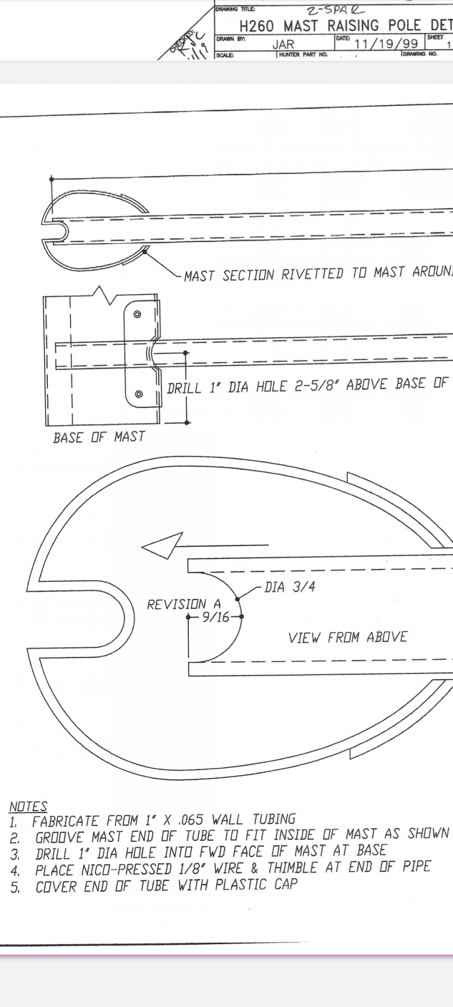

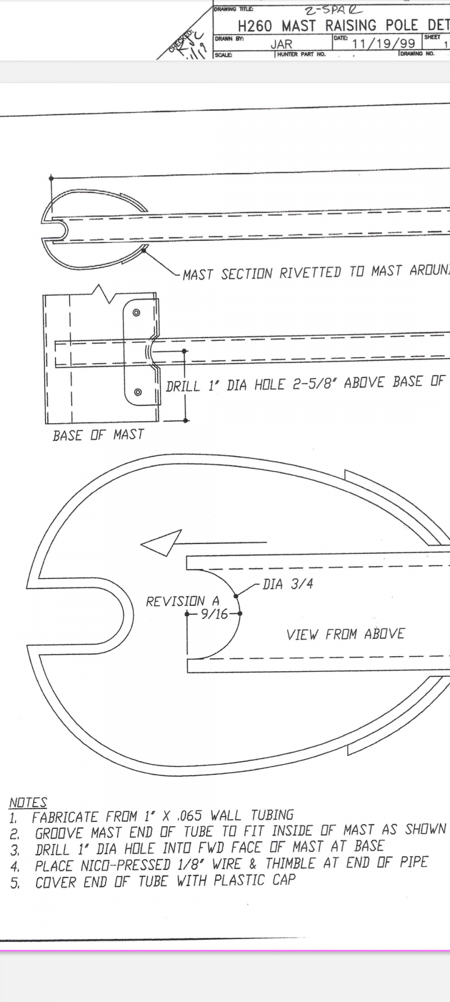

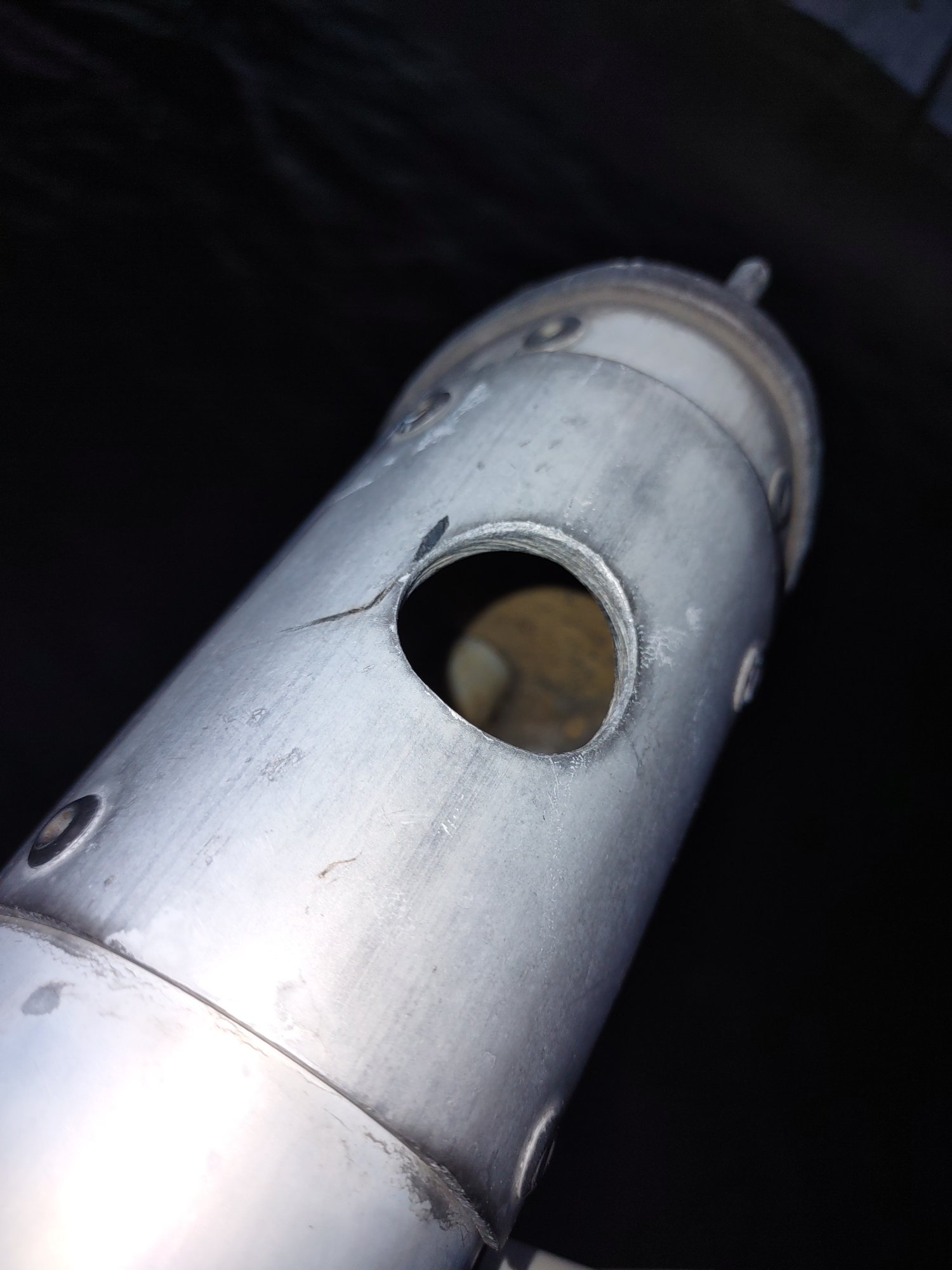

can someone upload pics of Hunter 260 mast lifting pole (gin pole), so I can tell if my homemade version is right?
Oct 8, 2023
116
Hunter 260 Kemah
Can anyone please upload high quality photos of the end of mast raising pole (gin pole) for Hunter 260, so I can tell if I have made mine right when I make it? It seems from the plans the notch should have diameter of 3/4 of inch (so 12/16) and this should be cut so it is 9/16 deep --- so the radius (half the diameter) is 6/16 and it should be placed 9/16 deep --- which seems to mean the notch is a half circle and then a bit more straight wall. I can't find a good enough photo to confirm this which would be wonderful to get. I hope that makes sense. I think the h26 gin pole is bit different. So, anyone please have good photos of end of h260 gin pole they can share?
Thank you. - D

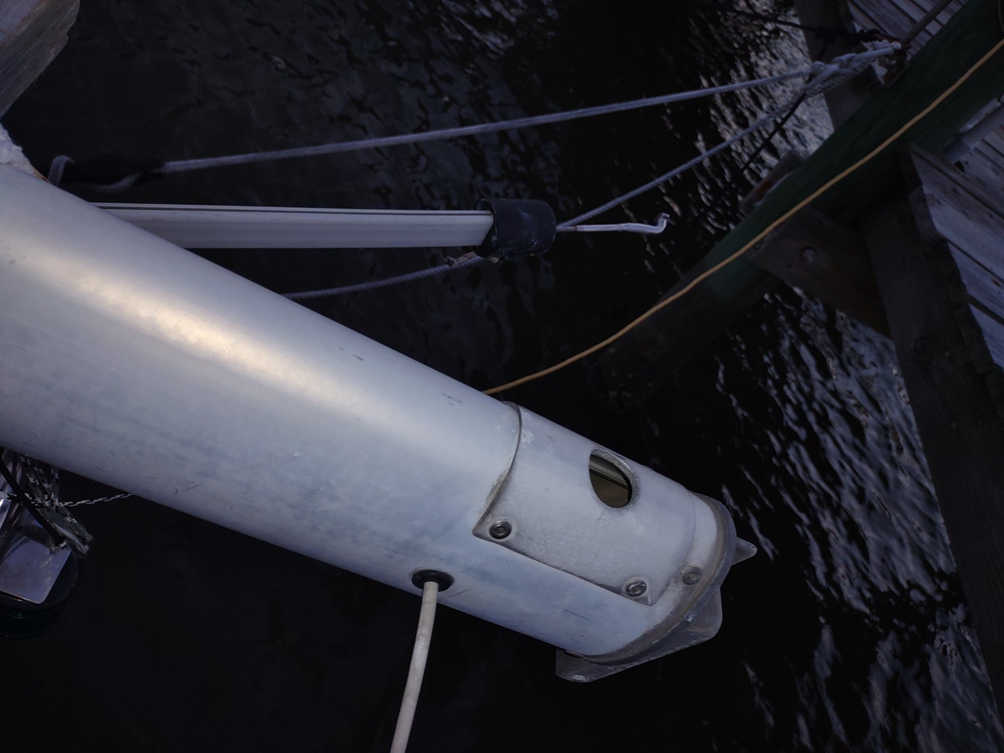

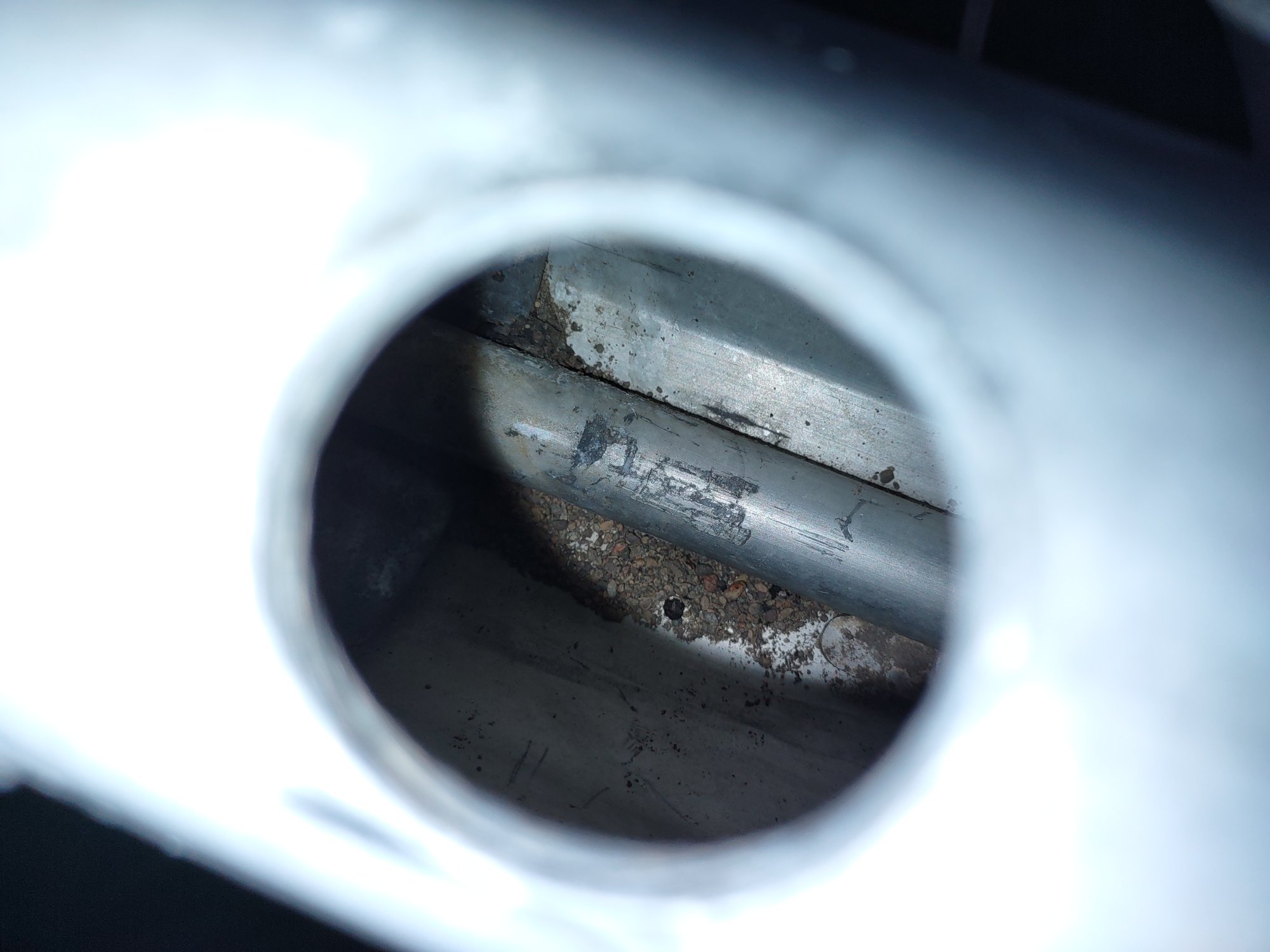

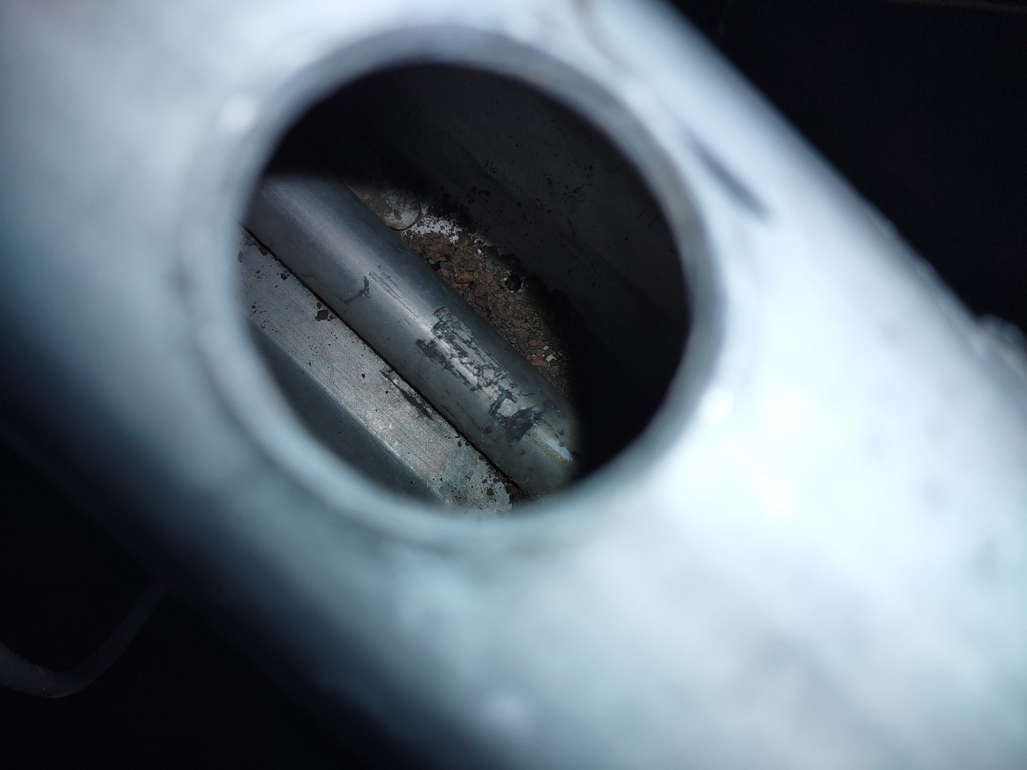

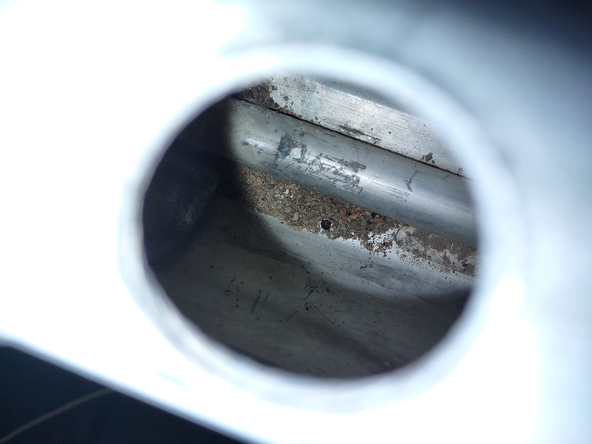

Hunter 260 Kemah

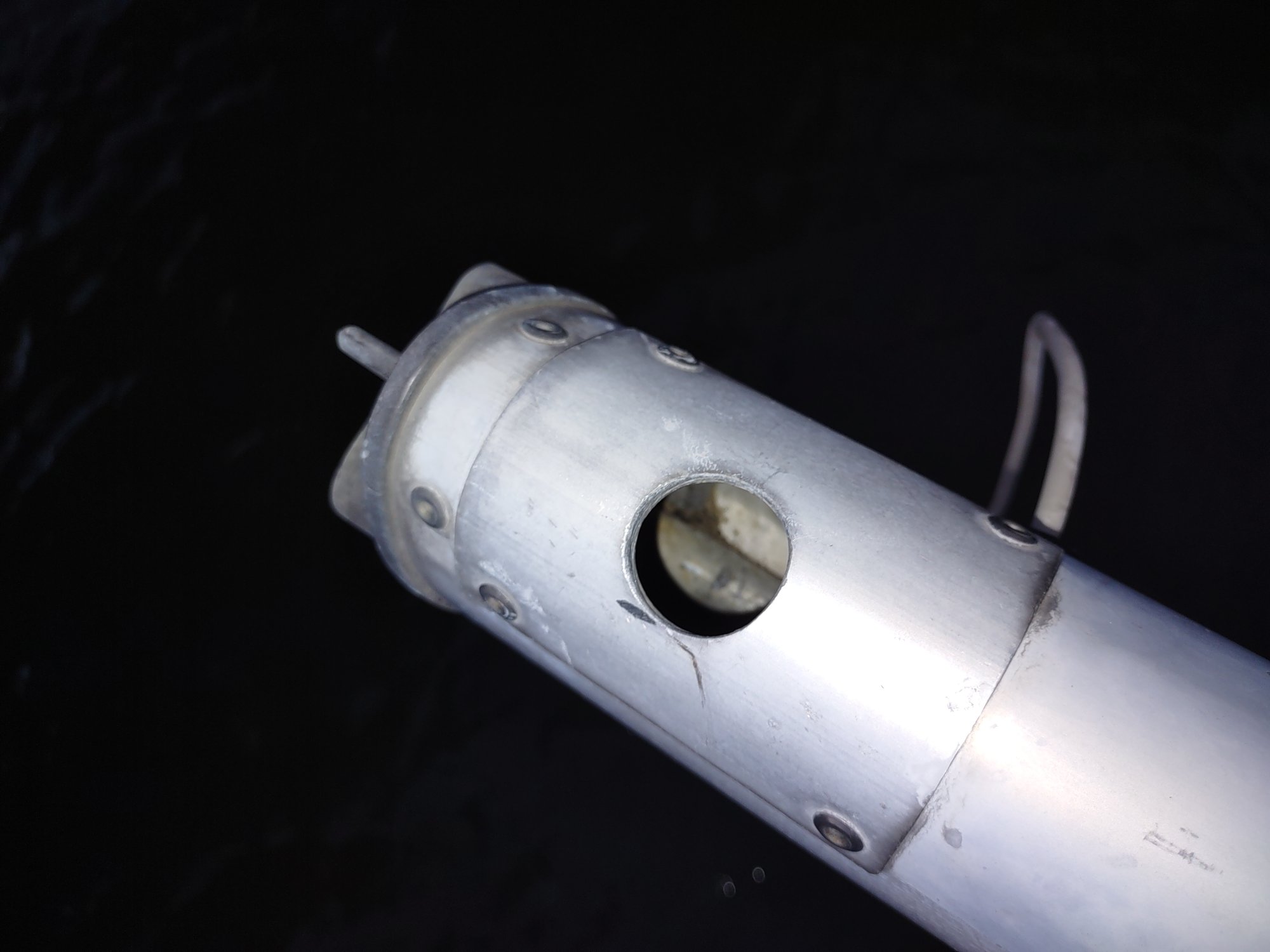

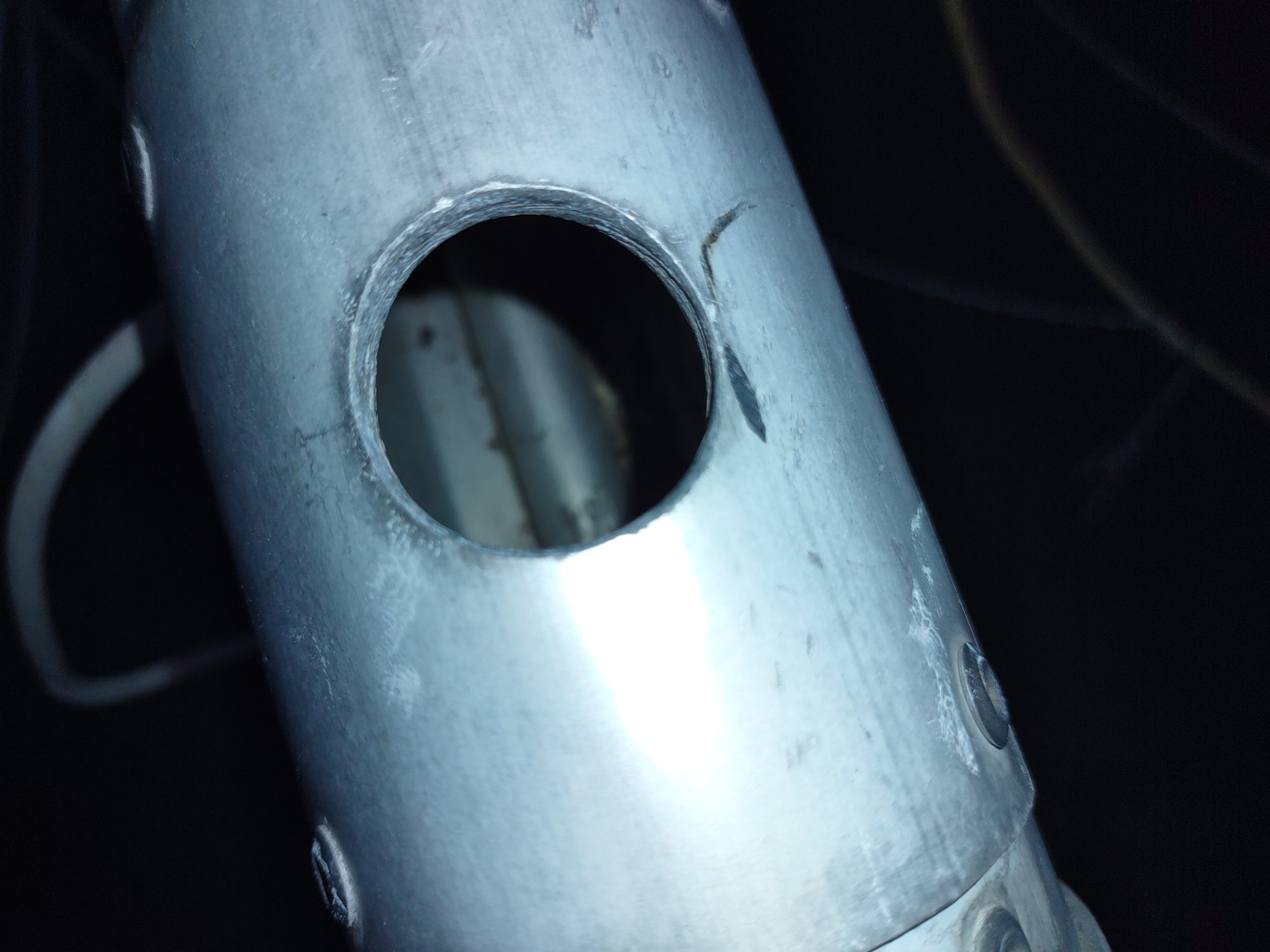

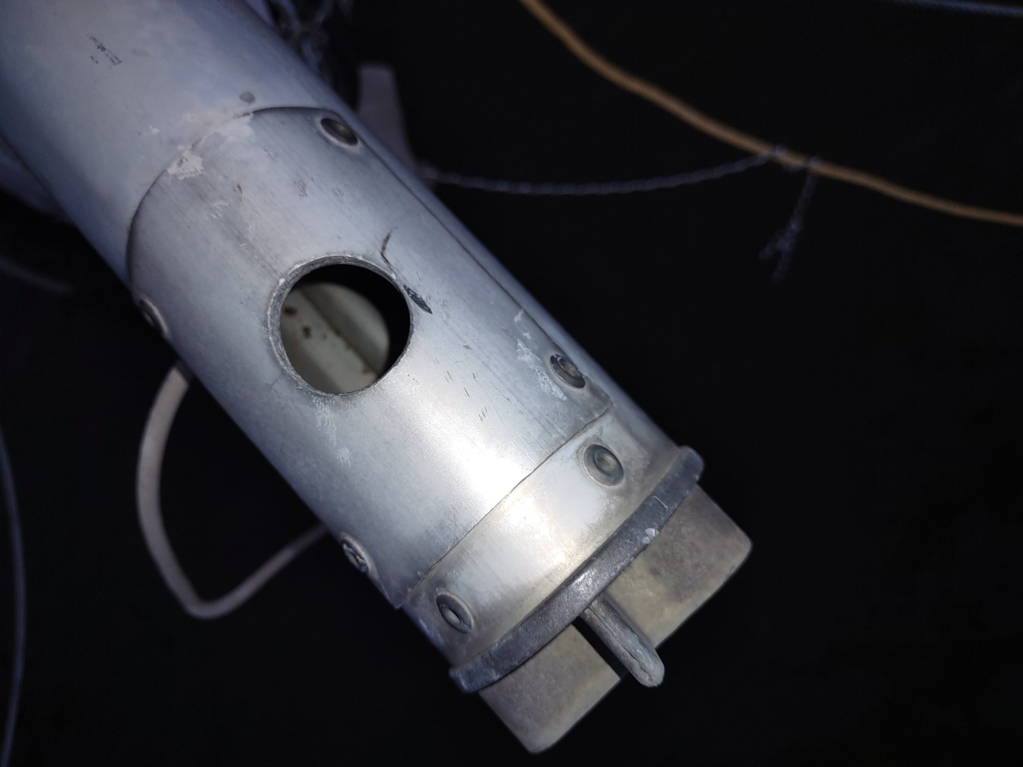

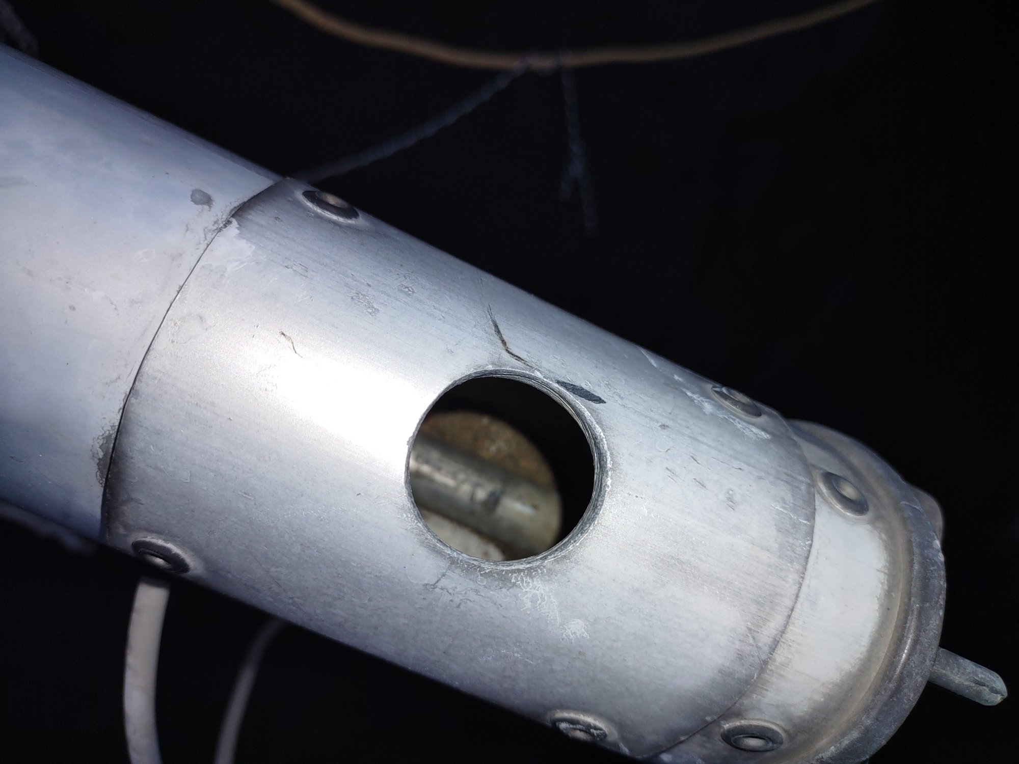

Photos of gin pole hole of h260....
