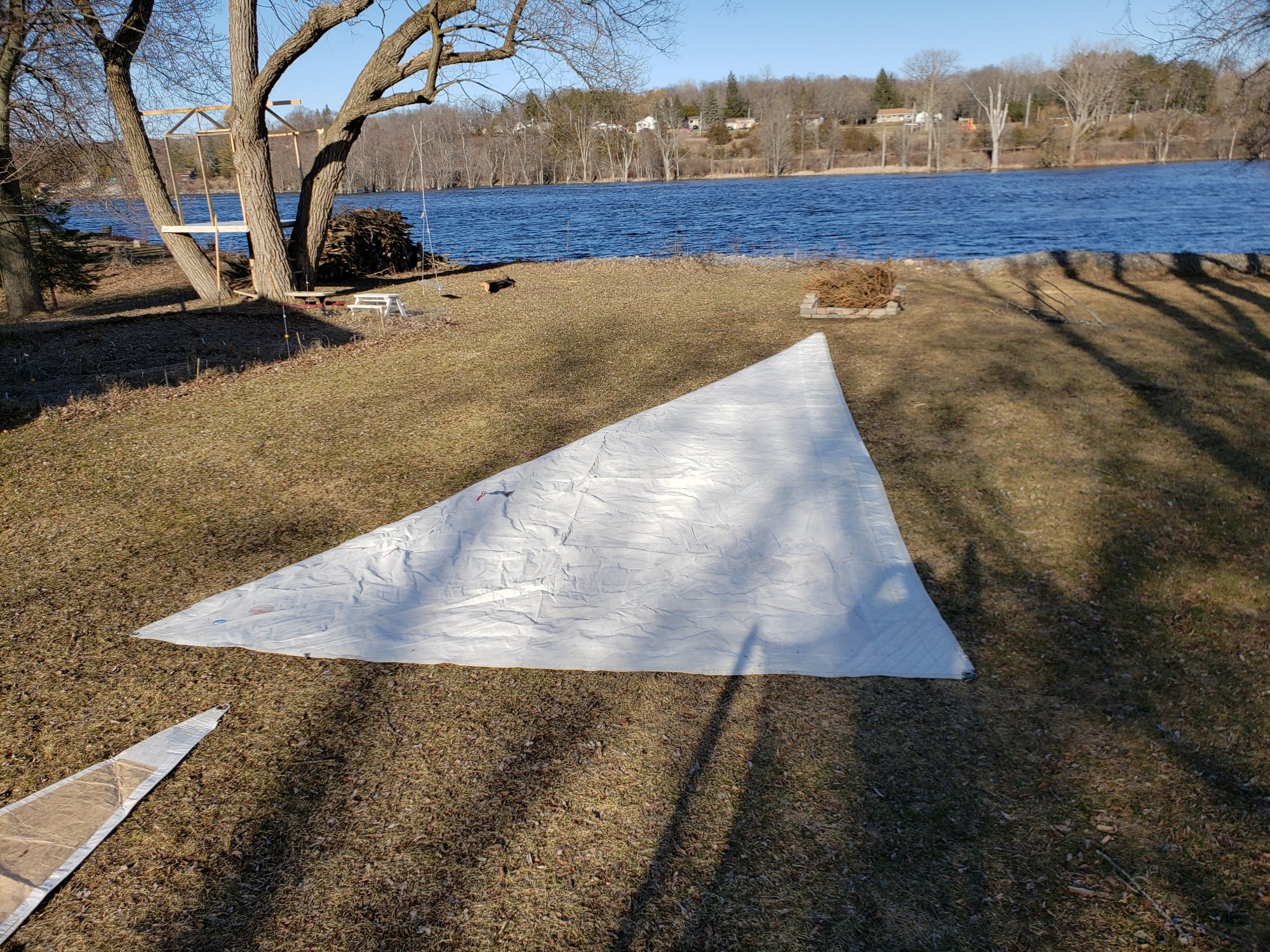

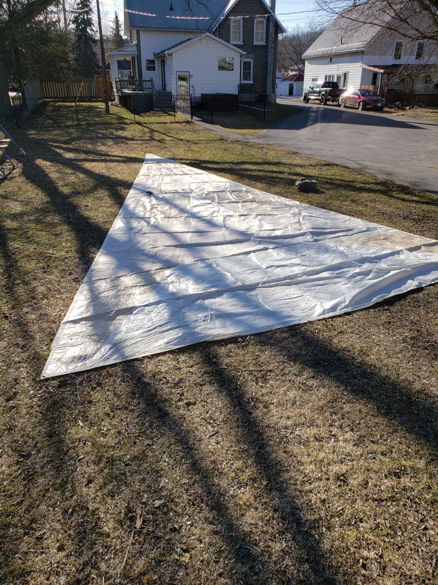

Welcome! My boat is a 1984 Hunter that I bought last summer, and I'm finally getting a chance to go through the sails before the season starts. The genoa that was on the boat has some damage and I was thinking of taking it in to a sail loft fore repairs, but before I did I wanted to also look at the spares that came with the boat and make sure I'm investing in the right piece of cloth. I'm new to ownership so I know little about the maintenance aspects of sails. The boat had two spares and I've included photos and measurements (luff x clew-to-tack).

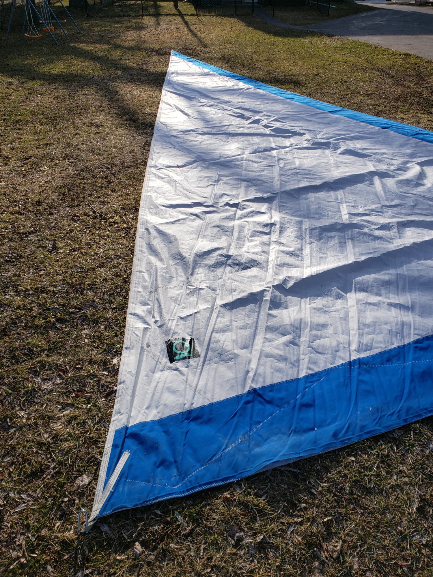

The Quantum with the blue sun shade came mounted on the furler, but the stitching holding the shade on are shot, so at the minimum it needs to be re-stitched and the bolt rope has torn off at the top few inches. It is 44'5" x 15'10".

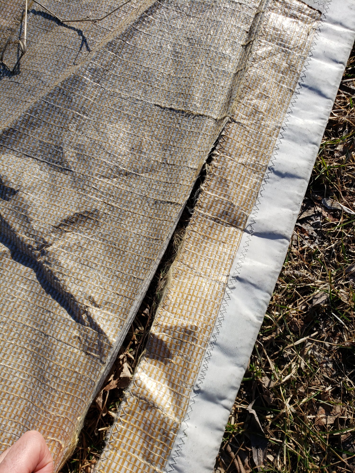

The Hild genoa is 35'8" x 21'8" but I'm unfamiliar with the material it is made of. It generally looks like it's in better condition than the Spectrum (but what do I know) except for one tear, shown in close up in the photos. Is this indicative of material that is generally worn out or could/should it be repaired? There's no sun shade, does this type of material not need it?
Finally a Johnson genoa that bears a sticker saying it's already been re-conditioned. It's 33'4" x 15'5" and again, to me the material looks like it's in better shape than the Spectrum. It has a white canvas where the Spectrum has blue, I assume this is the sun shade.
I'm confused to how the three sails vary so much in size and aspect ratio and I'm not sure which is actually the best one for my use, which is leisurely weekends family trips. Anyone have advice on which one I should be putting my money into and are the others really worth hanging on to?

If you take all the sails to a local loft they can give you well found opinions on each sail. In terms of general guidance, the sail with the tear and gold fibers is a Kevlar laminate and it is probably good for making hand bags, it is shot. The Quantuum sail looks to be in decent shape. The UV panel needs to be replaced or restitched. This is a common repair.
The difference between the Johnson Sail and the Quantuum sail is probably sail cloth and a slightly different cut. I didn't do the math, the two larger sails (by area) are likely #1 Genoas aka 150% sails. The smaller sail is likely a #2 or 135% Genoa. The other difference can be in cloth weight. Lighter cloth for larger sails for lighter air and heavier cloth for smaller sails for heavier air.
Still, your best bet is to take them to a sail loft and have them take a look and advise you. Then pick the option you can afford. Try an independent loft, they may be less interested in selling you a new sail. Kingston Sail Loft would a good choice.

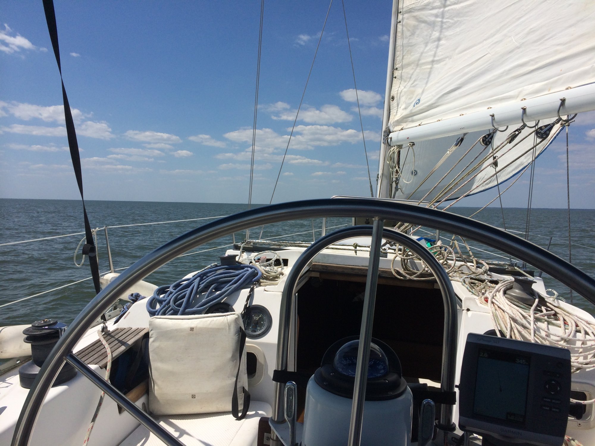

I think a loft's advice is in order as well. If you aren't going to do racing, consider a sail with a higher cut clew so that you can easily see, especially if you sail in a higher traffic area.. A little overlap is fine to make up some for the high clew.. The 34 can be a little tender, so a 150% sail would not be used very much.. I would guess that a 125% would be fine.. Picture below is my high cut. You can see that the visibility is great.. Its luff is around 42 feet..

First pic looks to be a Kevlar sail normally used as a racing sail and most likely not a good fit for your use. can't coment on the other two photos, the sail with the uv cover appears to be the work horse of all of your inventory. The sail with the uv cover appears to be a 110 or 130 % and probably a good fit for your needs.

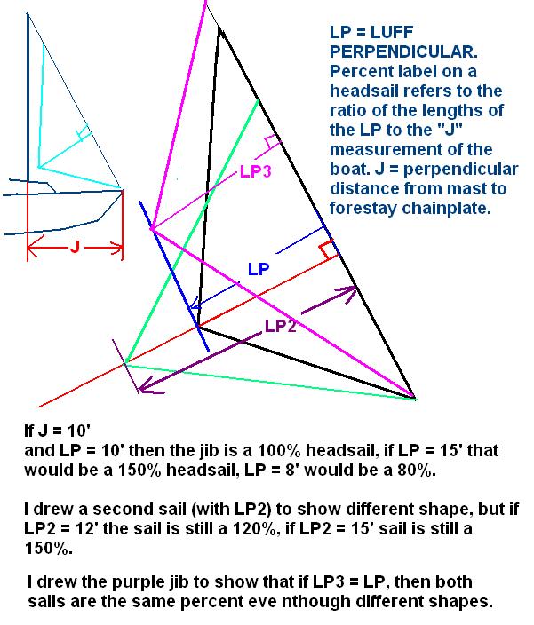

Sounds like you did not measure the LP, but can i assume the longer measurements are luff lengths? If so looking at https://sailboatdata.com/sailboat/hunter-34, your forestay length is 49' less whatever length the furling system uses, then only the larger jib 44.5' would seem likely to fit this boat. The other luffs are too short. A smaller sail can/would have a shorter luff, but not that short.
As to adapting a smaller sail to a furler system, your sail maker should tell you:
1. any sail you are going to use on a furler needs a sacrificial UV cover
2. if the sail's luff length is less then the the jib full hoist length ( which makes an allowance for your furler coinfiguration), then the jib needs a strap installed at the head.
3. The furler tape sewn to the jib luff needs to extend onto the strap.
