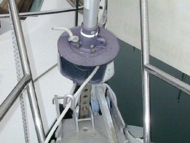

I'm looking at purchasing a boat, but the roller furler doesn't work properly. The unit is very difficult to un-furl and re-furl with a genoa on it. While tied up at the dock on a windless day, the only way we could unfurl the genoa was with one person pulling on the furling line, while the other hand operated the furler at he bow. Rolling it back up was the same. No matter how hard we pulled, it didn't want to move. I guess we could have put in on a winch, but I figured that would just break something.The broker is trying to tell me this is caused by the algae growing on the furling line. I find this hard to believe since the furler has an open spool and no areas where there a tight tolerances. Can these units be dis-assembled, cleaned, lubed and then re-assembled? Will the swivel at the top need servicing too?
