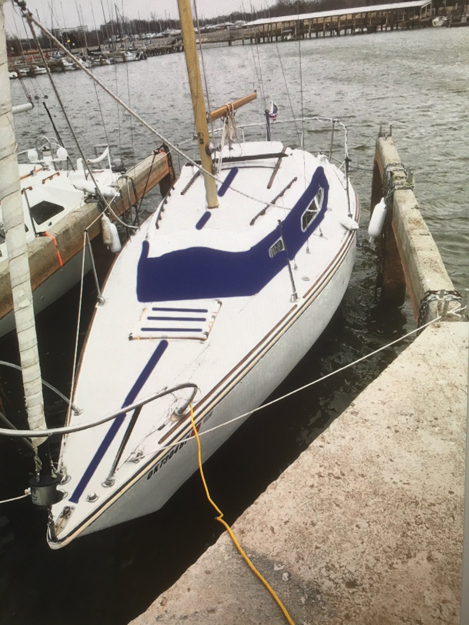

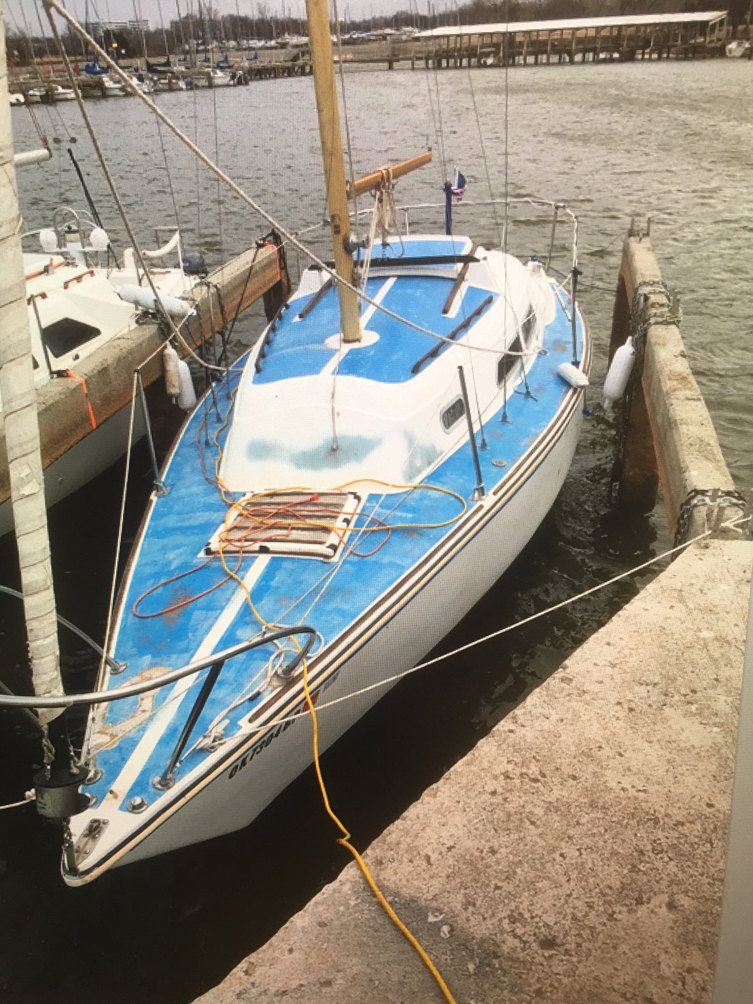

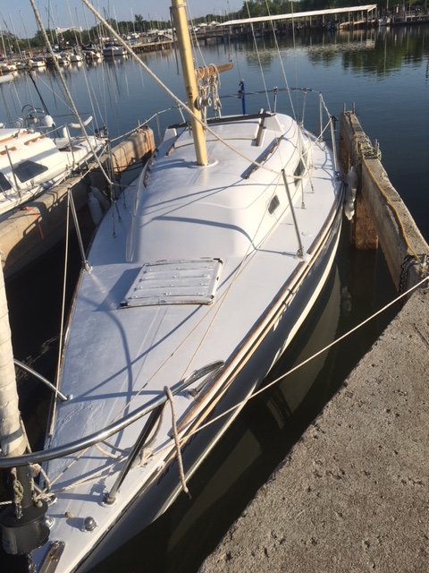

That’s just it. The old cockpit floor was a very light blue and was so hot to stand on yesterday. After it was painted white and I could stand on it, it wasn’t hot at all

I used a semi gloss with the added sand. I used a gloss on the outsides. If it turns out to be a problem I’ll repaint it. Thanks
