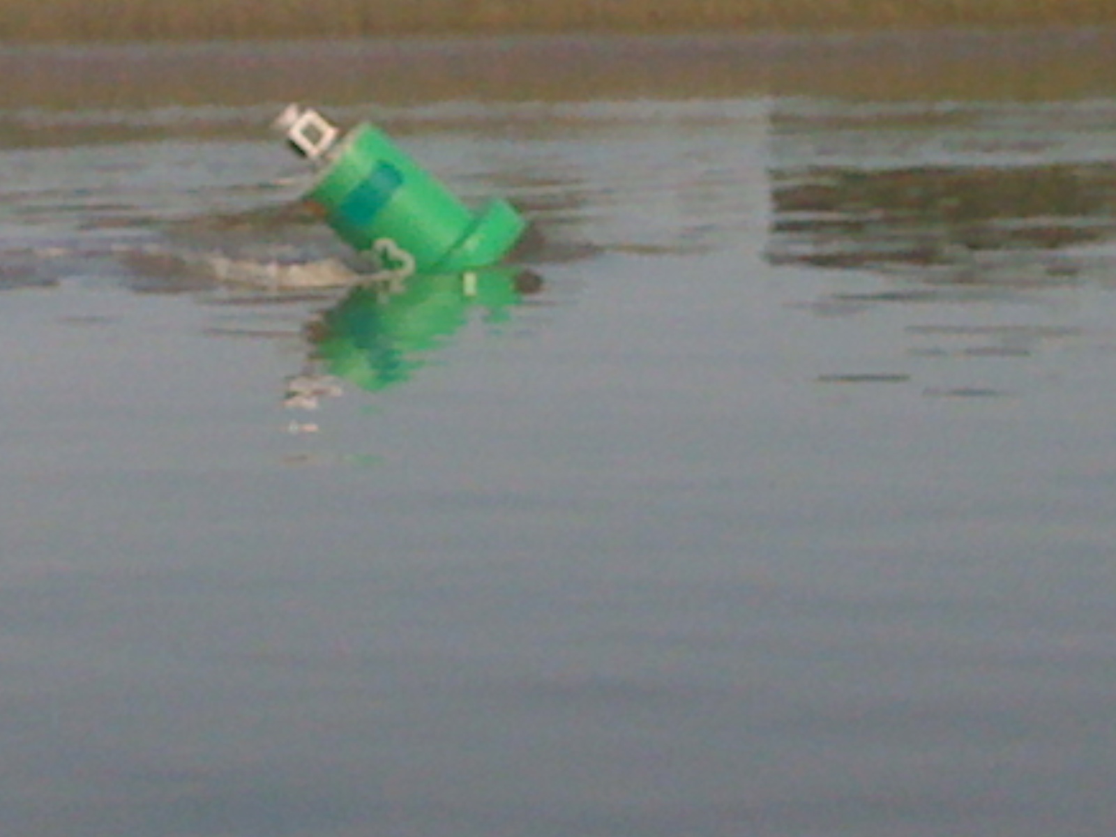

Also, motoring against a current over in the Carolinas ( forget which river) in the boat with 5.6 hull speed, snapped this pic-GPS said we were doing 1/2 knot over ground!! Some times running against a stream is like beating your head against a wall :)
