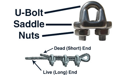

Use wire clips to set up a temporary section for the split backstay or like someone already said use a halyard. I like having a few of these around as I never know when I would need to rig a shroud or stay.View attachment 122077
a note or two here ...on Benny's example ...the saddle......remember never saddle a dead horse........( the dead horse is the tail/bitter end of the wire rope in this case and always try to leave enough space between the clamps to be able to add one more if the need arises

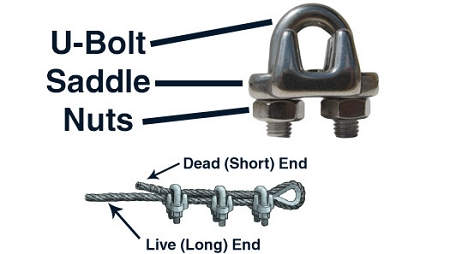

Good picture if you are going to use these wire clips. Always remember, "never saddle a dead horse". In other words, never put the saddle on the dead end of the clip. Some people alternate the clips but that is not correct.. Edited: Woodster, you beat me to it!
Mar 20, 2012
3,983
a note here on Benny's example ........remember never saddle a dead horse.
one might ask, "why is this important?"... because the saddle offers better support for the working part of the cable, whereas the the U-bolt part of the clamp would crimp into it and cause a weak spot in the cable when the nuts are tightened...
Sep 15, 2009
6,244
S2 9.2a Fairhope Al
why is this important?... because the saddle offers better support for the working part of the cable, whereas the the U-bolt part of the clamp would crimp it and cause a weak spot in the cable when the nuts are tightened...
because the u bolt will let the bite slip in the clamp and the saddle will not
Mar 20, 2012
3,983
in destructive pull testing, the clips being installed backward have been known to slip, but when they are tightened so they dont slip, or even over-tightened, the wire rope breaks where it was crimped by the u-bolt.... installing the saddle over the working part gives good support so crimping doesnt happen, and allows some of the loading on the first clamp to pass thru and be shared by the second clamp, and in extreme loading, a very small portion to the third clamp.... a crimp in the cable does not allow this sharing to happen, and so the majority of the load is all in one place.... at the damaged spot in the "system" .
any vibrations or flexing of the cable plays very hard on the crimped and stressed wires of the working part of the cable..... none of these issues are present in a dead end/tail being crimped by the U-bolt part of the clip....
