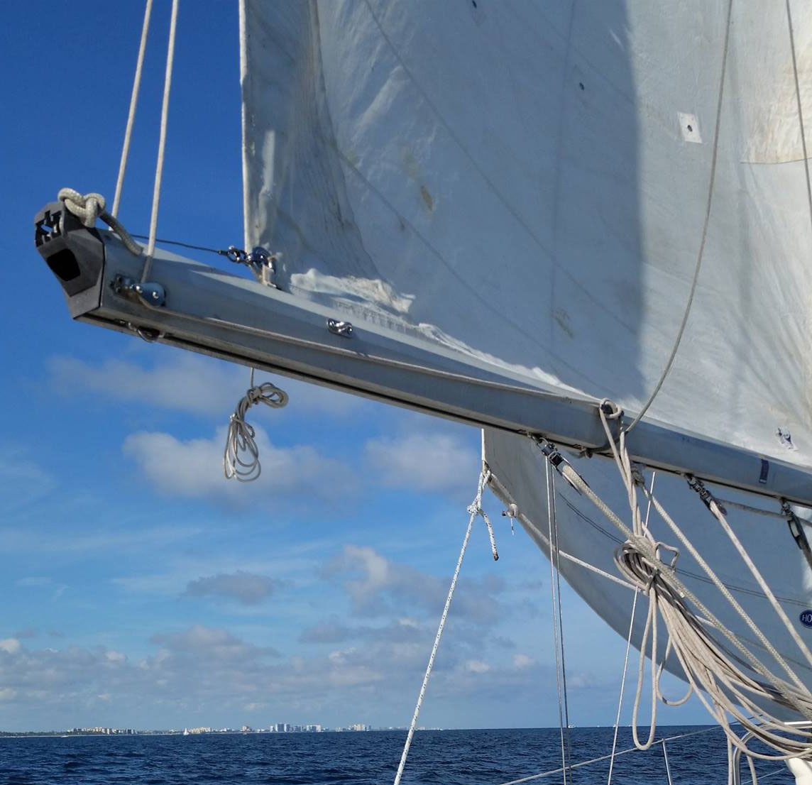

Nice and simple, but no cheek block or cleat on the H23.5 boom.My topping lift runs through a small cheek block on the starboard side of the boom end, and then to a small regular cleat just forward of the block on the boom.
Ha - this is exactly what YOU proposed last year - lol! I simply "ran it up the flag pole" just to see what might shake out. I was looking for a way to avoid tying and untying anything, which made the jam cleat at the front of the boom attractive. However, I don't think @Rick Macdonald likes the idea of going forward to release the topping lift, and I can definitely see his point. The H23.5-H260 is different. There is no deck, only cabin top, and that first step up is a doozy...and - you have to leave the helm. I would prefer to release the TL at the helm. But I can also see where control at the mast might be convenient at times. Happily, I think I can have it both ways by adding a "clam cleat(?)" at the aft end of the boom (if such a thing can be done) and then rig it like you have it. Then (at the helm) I can pull the line out of the cleat to lower the boom, and then pull down to raise the boom. Likewise at the mast I can pull or release the line via the jam cleat. But I'm not married to this idea. Let me know what I'm missing.That is just like you originally proposed.
