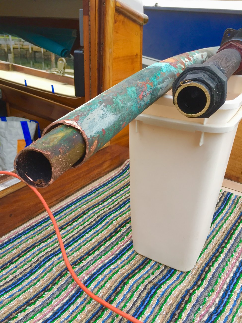

Yes, I have seen an Alden iirc, that had concentric copper exhaust, water in outside annulus, exhaust on the inside. Sounds like maintenance nightmare but new owner worried cut a section open and good as new.
That was me, Leslie. In fact, they used to build wet exhaust systems that didn't have this exact problem.
This 1961 exhaust was built of two copper pipes, one inside the other. It had to fabricated to the boat, bent, and the ends in the outer pipe brazed so as to form a separate water chamber, around the hot innder exhaust pipe.
The the fabricator added taps at each end forming an outer chamber isolated from the inner exhaust pipe.
The end just aft of the exhaust manifold connected to a hose off the raw water side of the exchanger. This pumped raw water around the inner pipe, cooling it, and then the raw water exited out of the double pipe just before the high loop under the aft deck.
Out that exit, the raw water - via a smaller copper pipe, entered a cast iron muffler where it was mixed - safely below the high loop, and exited the stern.
No way for raw water to enter the inner exhaust and flood the engine.
What worried me is that there is no way of knowing the condition of the inner pipe. When it failed, raw water pumped in before the exhaust pressure built, would immedietley flow into the exhaust manifold and engine.
Sadly, it had a century of use left. But how would you know? Cost alone makes this system obsolete.

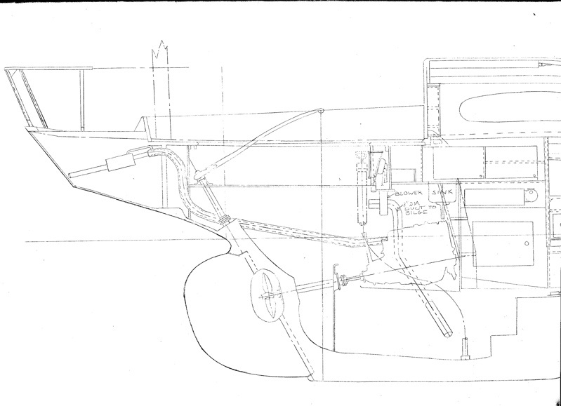

When I designed my system, for that reason - volume - I went with a larger capacity water-lift muffler. As a typical old CCA design, the 'resting' volume of raw water is at a max. The extra volume keeps all the flow back in the bottom of the muffler.
Then to not worry about back flooding(and adding more water volume), I resisted the temptation to put my exhaust outlet in the counter where it wouldn't show.
I stuck with the 1959 design drawing thinking Alden design had a long track record of engine floodings, and picked this location.
Even with the high loop before the exit for added protection (my new hose high-loops all the way up the aft deck), I see a potential for a plug of water to get pushed up, especially if the outlet were re-located to the counter.
In a seaway, running downwind (something we do for hours and hours), if the outlet stays under for several waves, a plug may push - and over the high loop,...and you have a siphon.
So I kept the high outlet location, raised the raw water vented loop to just beneath the bridge deck and so far so good.
Even this high location still goes under for short periods. Any sort of seacock wouldn't work for me. It wouldn't be easy to get to, too much potential to not use it - or use it and forget it.
