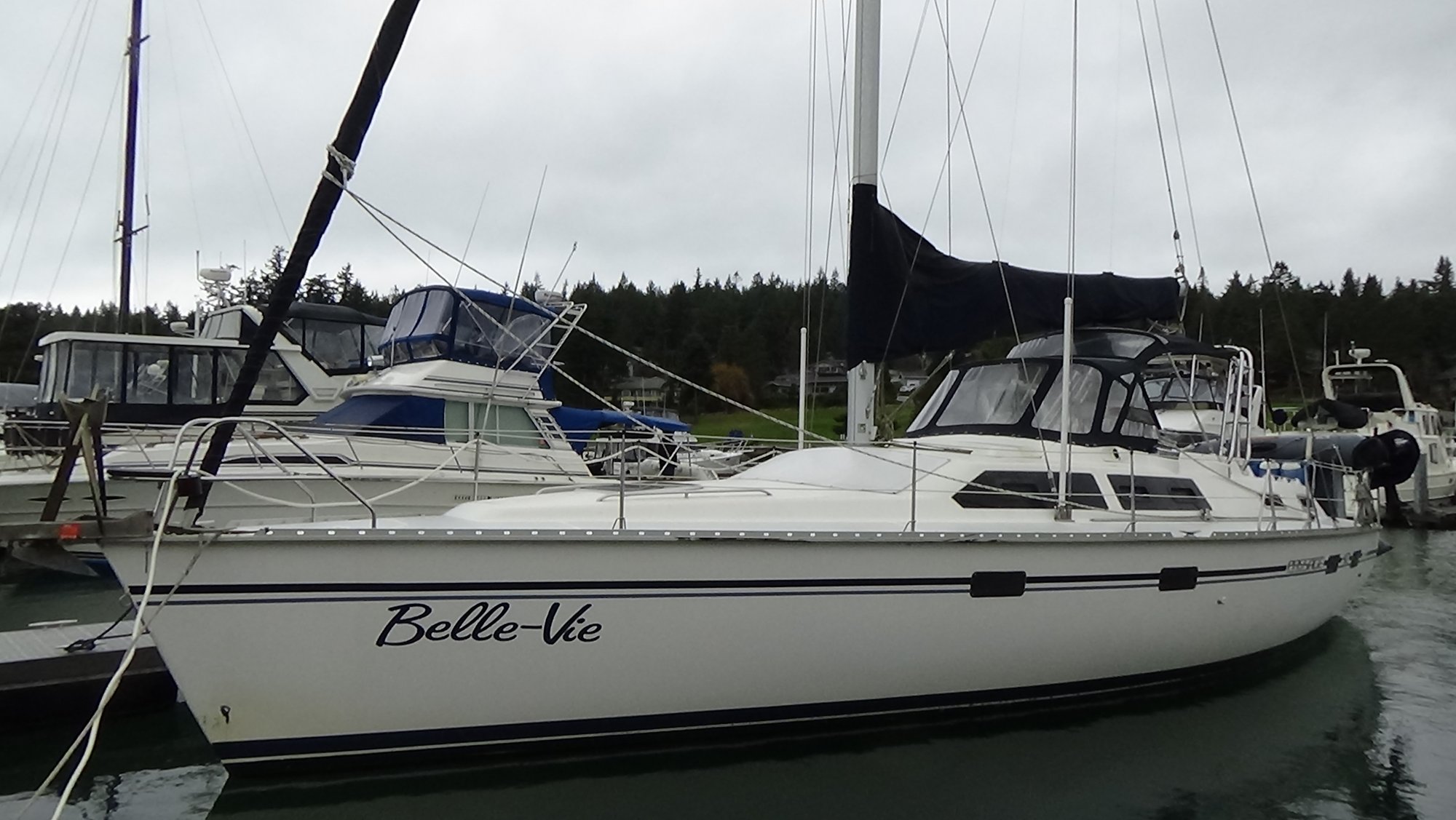

No problem here backing into our slip. Belle-Vie backs very nicely. No need to do so, so normally enter bow in.
