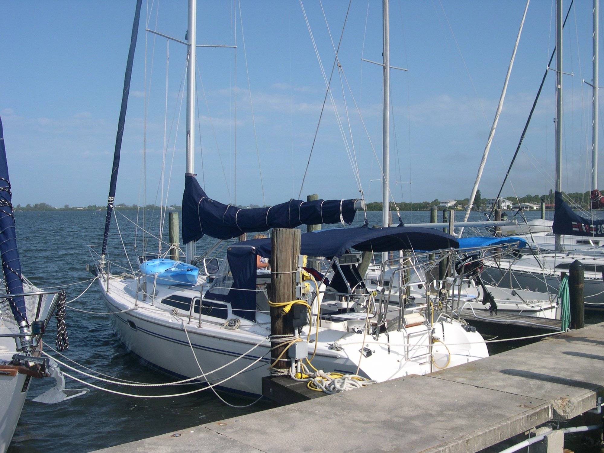

Sometimes it depends on the marina. If the finger pier is long enough, I prefer bow in. But, if the finger pier is a short, stubby thing, then stern first is the better choice.
