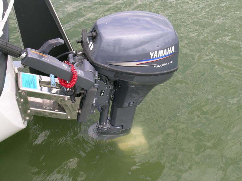

I have the 2002 Yamaha 9.9 4 stroke X Long Shaft High Thrust OB.
It had the remote throttle but I found response to throttle adjustments were too slow and inaccurate. First thing I did was put the throttle back on the tiller handle.
I have the Yamaha chart which lets you figure out what OB you have, sounds like you might already have the X long shaft.
Send me an e-mail if you want a copy.
