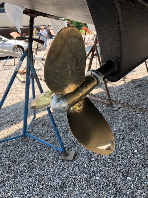

HI All, I have a 2007 373, 3JH4E Yanmar, 3 Blade Max Prop. Have a 30MM shaft, with a 1/2" anode on front of the max prop, see attached.
Would like to use a wider anode. question. Can a spacer be installed on the output connection on the engine to increase the space available for the anodes? Specifically, can the shaft be slid back further into my original dripless mechanical stuffing box (Volvo Penta I believe)?
PS if anyone is wondering I polish my blades using sandpaper up to 200 grit, 2 buffing compounds and Simichrome. Absolutely no barnacles on prop, here in CT.

I'll be the first to ask Why do you need more zinc. That prop should be in a showroom, nice work.

Answer to your question Yes I did it , I added a flexible coupling between the coupling which moved the prop out 1.250 " giving room for bigger anode. No vibrations ,and the shaft/prop is now electrically isolated.
I also machined the shaft key longer and cut the shaft 1/2" so it was only sticking out .750 longer as my shaft is 25mm. On another note where the shaft tube exits the fiberglass skeg to the tube is at 90 degrees. This is a very weak design , myself and many other Beneteau owners have had this crack around the tube ,allowing water to run up the tube and start leaking into bilge. My fix was to glass around the tube to the skeg giving a nice radius and eliminating the 90 degree weak spot and making the tube stronger. Coupling was R&D marine

Clean the back surface of your MaxProp and firmly butt the anode to your prop.
