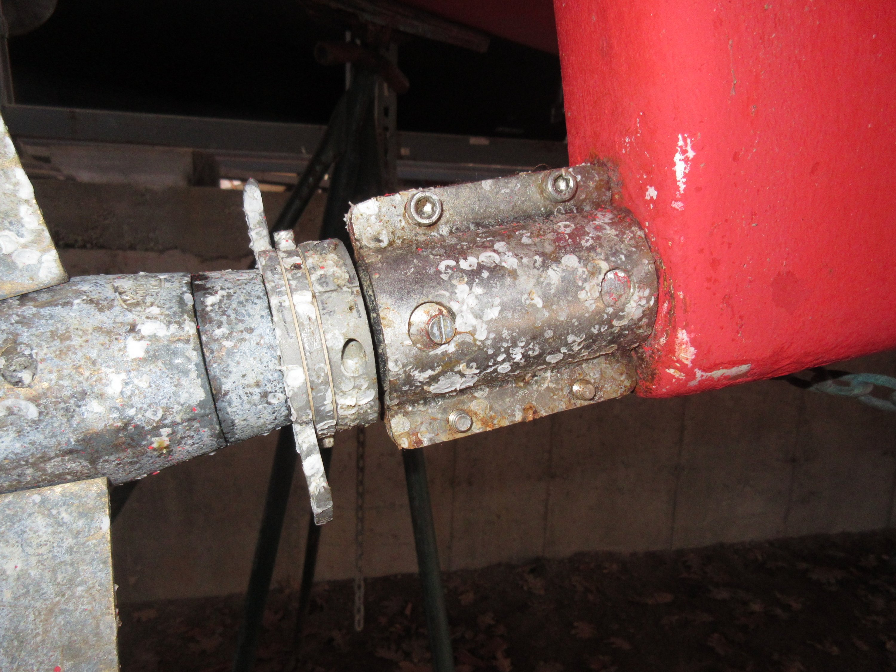

Can anyone tell me what this isin front of the prop?

Wow.. looks like a coupler or splicer for a short piece of shaft .. I've never seen one applied that way.. or maybe a holder for an additional or longer cutless bearing to stabilize the overhang of the prop. if it turns with shaft, it is a coupler.. if it is stationary, an additional bearing or some other magic thingie.. ?

Looks like a line cuter for keeping lobster pot lines from getting caught up in your prop.

Between your line cutter, and your shaft zinc and the exit of your cutlass bearing I don't see enough clearance to allow for water flow from you shaft. Not sure how the Catalina30 works but I would lose that line cutter and make sure I had flow from my cutlass.
Well, you're probably right about the bearing but that's not a Catalina 30.

It certainly looks like the molded Beneteau shaft strut and I bet that clamp arrangement is someone's idea of a repair brace for the stern shaft tube. The screw showing from the brace port is the trap screw for the cutlass bearing. If that is a Beneteau you really need to lose the line cutter, there is no room for it.
It's a Beneteau 393. Can you elaborate on this? Looks like a mess to me. What is a repair brace and why would it be needed? I am buying this boat, the survey is scheduled for the 27th. How difficult is it to replace a cutlass bearing? The boat is lightly used in beautiful shape otherwise.

That is not what the stern tube that contains your cutlass bearing should look like. You will need to remove your prop to replace the cutlass bearing, but at this point you can't even inspect the cutlass bearing because of all that stuff someone has added. Here is roughly what a proper system should look like. I would definitely find out why that brace has been added, and inspect the cutlass prior to closing

I have a Beneteau and the shaft exit from the skeg hardly has room for a narrow shaft zinc let alone a rope cutter.
I'm wondering if somebody botched a cutlass bearing replacement and tried to do a rube goldberg repair. That whole shaft exit is just not right.
It almost looks like the original prop shaft was replaced with one that was longer. The actual cutlass bearing sits mostly inside the skeg and is secured by a couple of external set screws. There should be no need for that device that looks like an external clamp. That is certainly not an orifinal factory installation.

I have a question about Beneteau's cutlass bearings. That assembly on my shaft was indeed a line cutter that had a custom coupling mounted over the housing for the Cutlass Bearing. I removed it for cleaning and am not going to re-install it but the Cutlass Bearing is very dry and the prop shaft is tight making it hard to turn by hand.
How easy should the shaft turn through the cutlass bearing? What's it's construction? I know there is water flow from the stern tube and I assume it's pretty dry from sitting on the hard over the winter. I just don't want to launch only to be hauled to replace it.

When the trans is in neutral the prop should turn easily.
