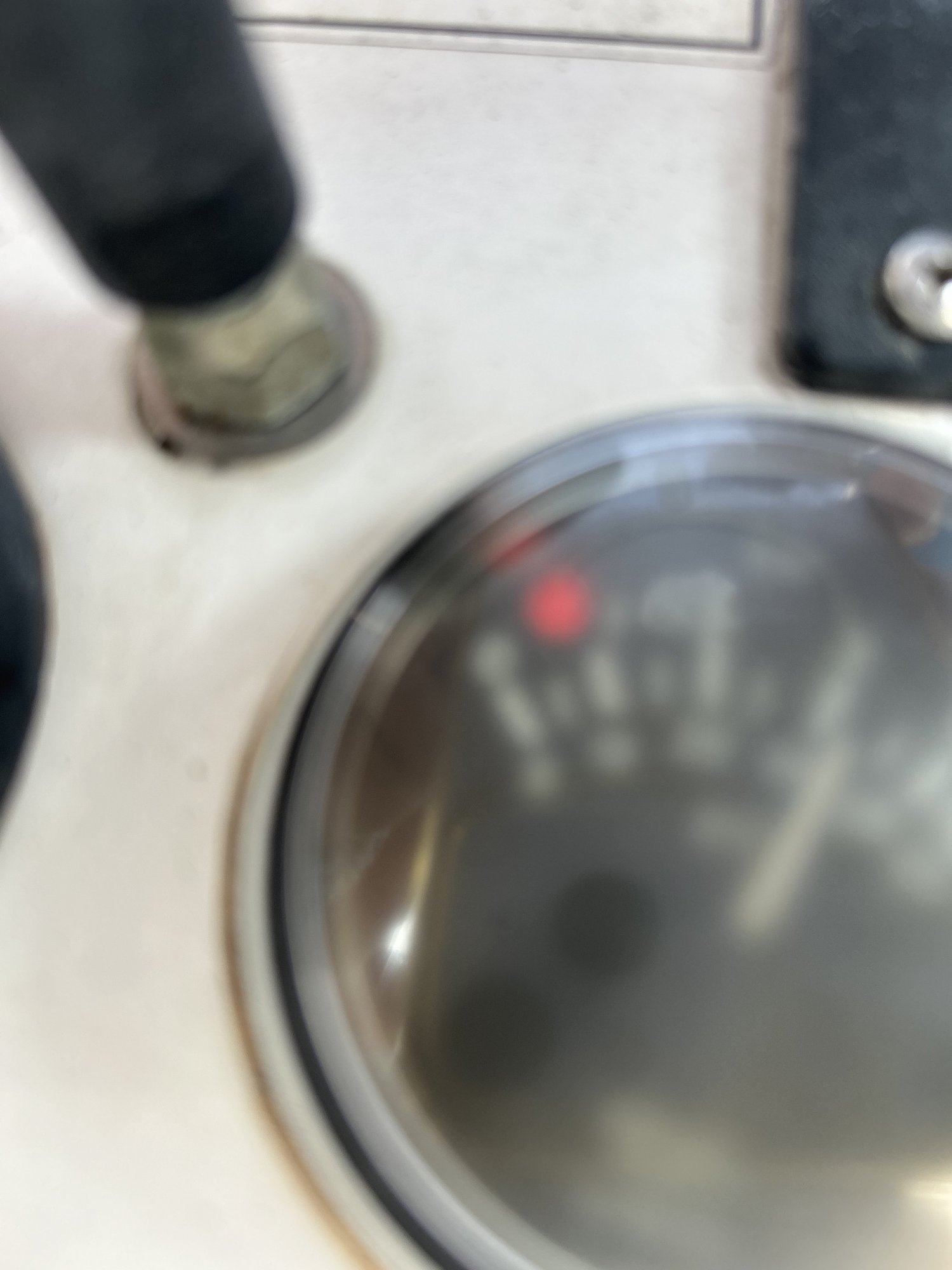

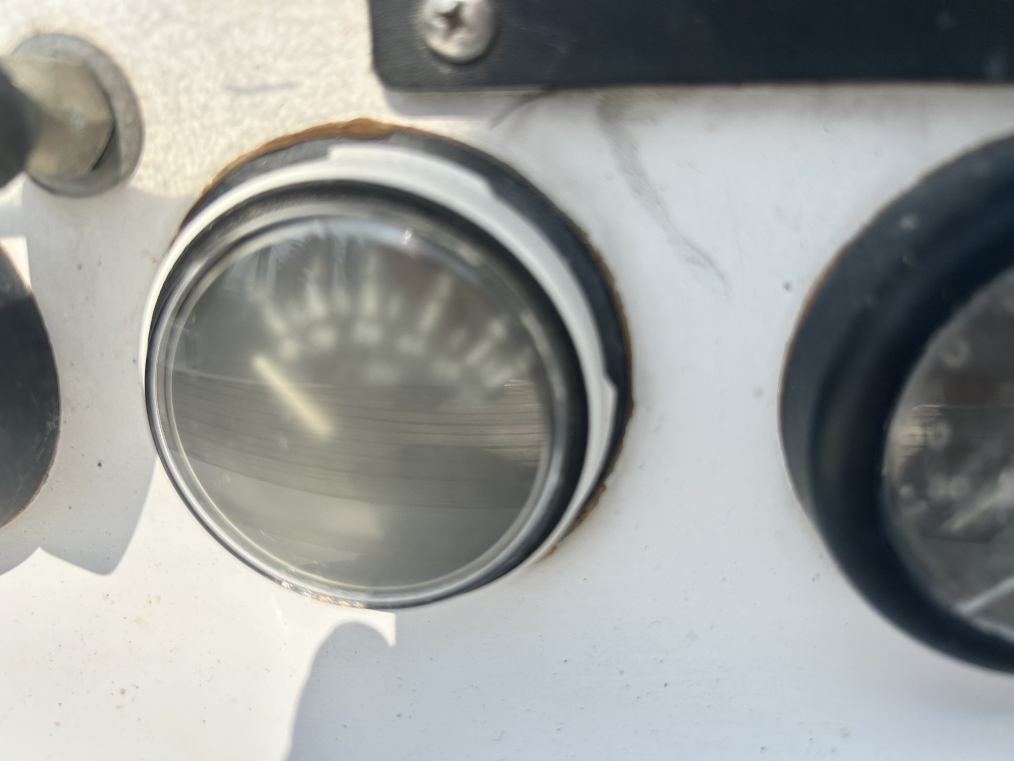

I have a 2005 Beneteau 393 and cannot read what this is. I was out today and the red light came on and I’m not sure what it is.
The 1st pic is the gauge. In question it is the 2nd gauge on the left on the 2nd pic.

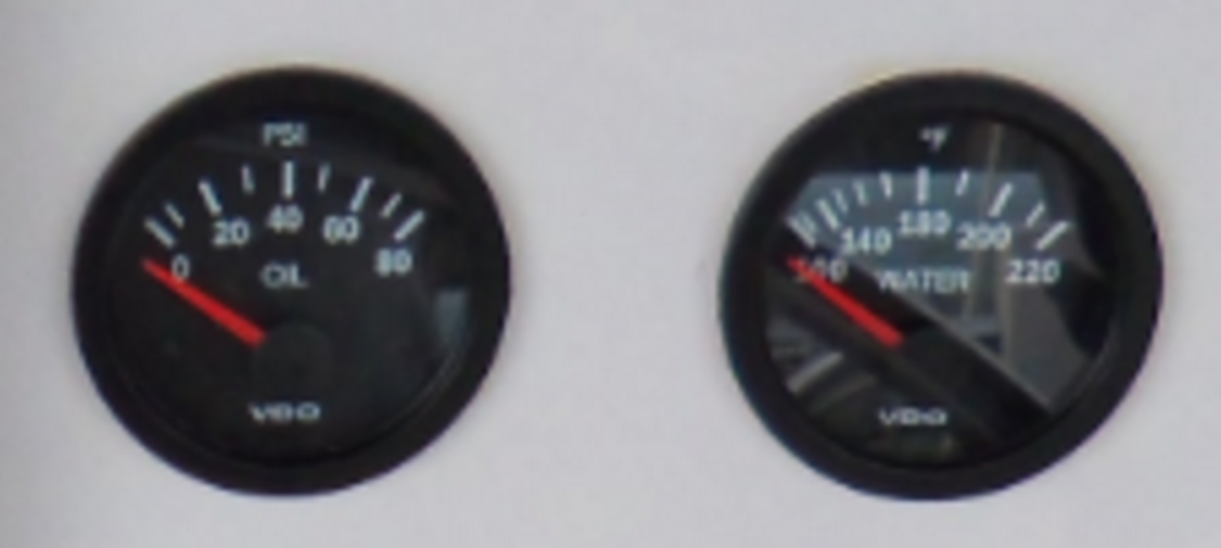

The gauge you show is the water temp gauge as the scale is not linear. Oil gauges are linear. Here's mine shown below :
If you've got a red light as well, you've got your work cut out for you.

You may be able to use a plastic cleaner to polish the lense so that you can read the gauge.
Exposure to UV light and marine air has fogged the lense.
I use the stuff from an auto shop. It is used to polish car headlights. Lasts for a season.

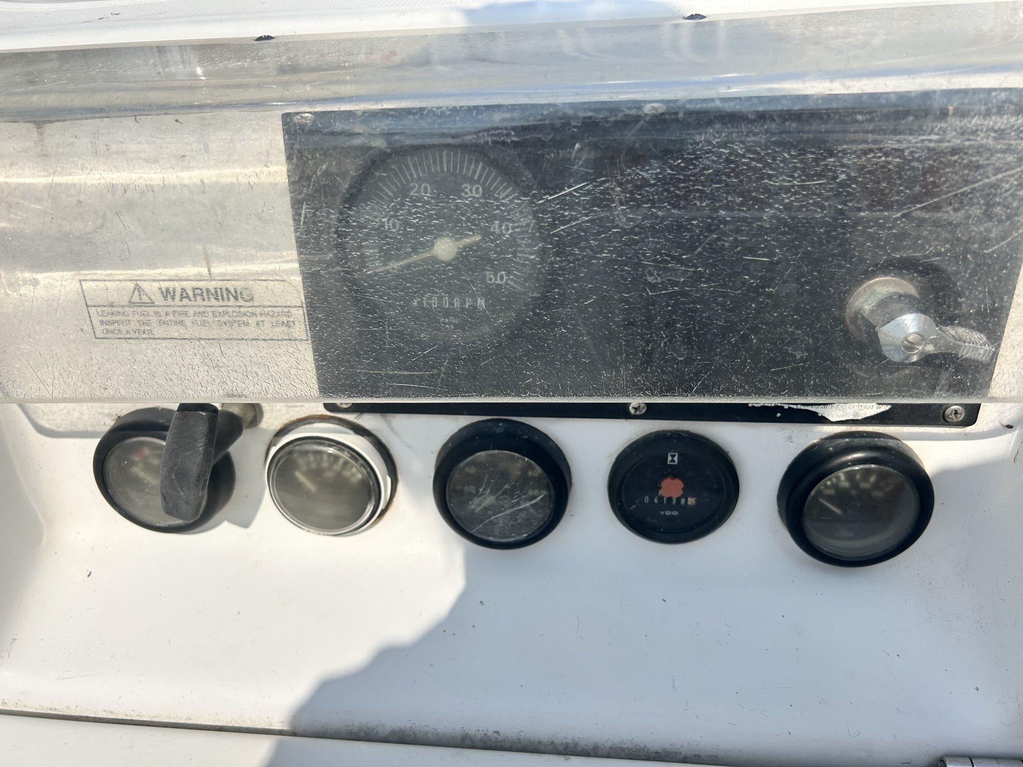

This is a “WAG”, from left to right:
1. Fuel level guage
2. Unknown
3. Oil Pressure
4. Hour Meter
5. Water temp
What other gauge would be included, alternator output??

OP will need to get some Better photos for us to help him, but I do think it is an oil pressure gauge.
Far right gauge scale is 3-digits, so I am thinking water/engine temp.
Next one is engine hours
Next one looks like it has same numbers on both side of the scale..so I think some sort of electrical gauge (volt meter)
Far left looks like fuel gauge…
So that leaves oil pressure. At least that is my guess.

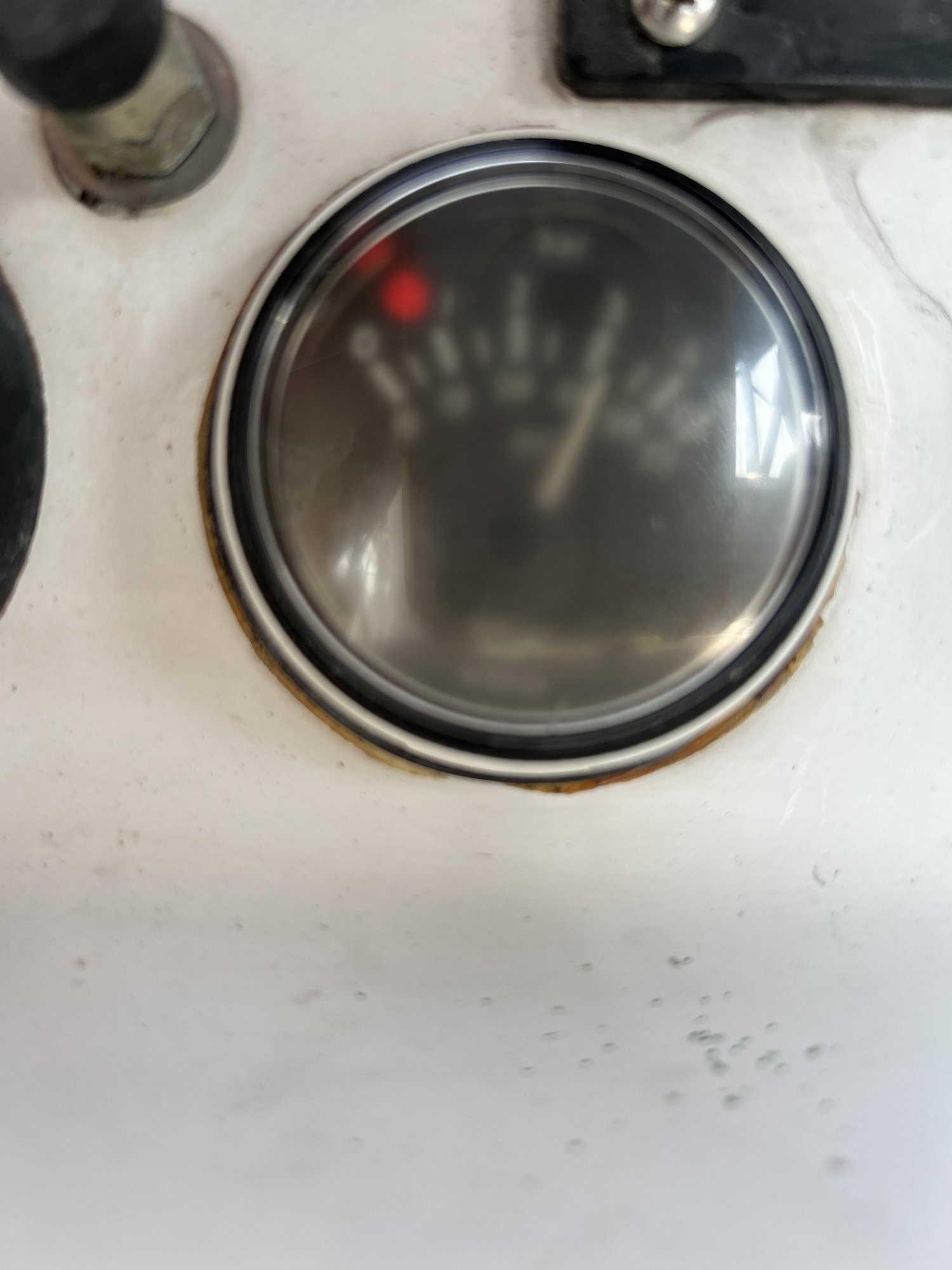

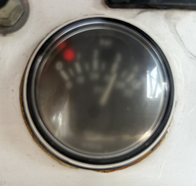

Ok so I have figured out the order of the gauges. I the engine and gauges are Tamar. Left to right. LTR. Fuel, oil pressure(not original gauge), AMP, HOURS, Temperature
attached is the oil pressure gauge which is sitting at three on the upper scale and 60 on the upper scale when the engine turns on. This is the picture still not the best showing the light on.

Yes you are right it is the oil pressure. See a thread below with more details. Thoughts.
23,827
Red light means the gauge setting is set to warn when oil pressure (assuming that is the gauge) is too HIGH or too LOW.
Low oil pressure is an indicator of a lack of oil, or perhaps a clogged oil pick-up. Check for volume with the dip stick. Too much oil can be as harmful as not enough.

If the oil level is perfect and the gauge is saying no, then perhaps the gauge is bad?
Replacing the gauge is easier than examining the oil lines. Be sure to get one that works with your oil pressure sender.
23,153
Assuming the engine was not running in the photo, the fact that the oil pressure gauge is reading pressure may indicate a bad sensor.
Greg
Sometimes gauges will stay in position when the ignition switch is turned off until the engine is restarted when the gauges will start reading from their zero positions again.

Seeing as how you can see the needle of this gauge with the silver bezel :
....................... and the thought is that it's the oil pressure gauge, please do us a favour and fire up the engine when cold from sitting overnight and let us know where the needle sits within a few seconds of the engine starting. It should immediately jump to the operating oil pressure. A temperature gauge, on the other hand, will take 5 - 10 minutes to get to operating temperature. Please also check that gauge #5 does take 5 - 10 minutes to come up to operating level. This eliminates all assumptions.
Seeing as how your #2 gauge has a nice shiny surface on the lens and yet is still cloudy, it shows the acrylic is fried through and through and cannot be repaired. VDO gauges are tops in reliabililty and not expensive as replacement gauges.

The engine was running at the time. I do think it is a bad sensor. It is not original, someone before us must have replaced it. My next step is to check the connections and do a meter read on it.
