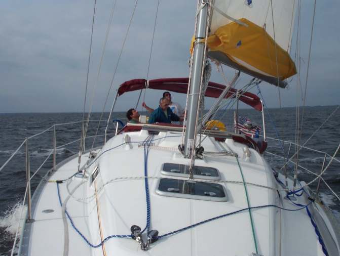

Single line preventer
A picture is worth 1000 words, as they say. Although not in use, the system is shown well in this picture. The line going back to the cockpit, coming from the side where the boom is, makes 4 or 5 turns around the winch and the rest of the line (5-10 ft) is left loose before it returns to the bow block. This single line preventer keeps the boom out but, when an accidental jibe occurs, it acts as a boom break. I don't recommend to cleat the preventer line because it may create very high forces on the boom. In fact the line and the blocks in my boat's system are relatively small to make sure they break before the boom. The preventer can also be used to speed up jibing or keeping still the boom in light winds. I have used this preventer in my Beneteau 361 for more than a year and have had no problems with it. In fact, it was very helpful during our trip from Florida to New England when we were broad reaching or running most of the time and it had to work several times. Of course, every time an accidentally jibe occured, we had to re-set the proper side of the line on the winch. Installing it is a one beer job once you have figure out the hardware needed.
