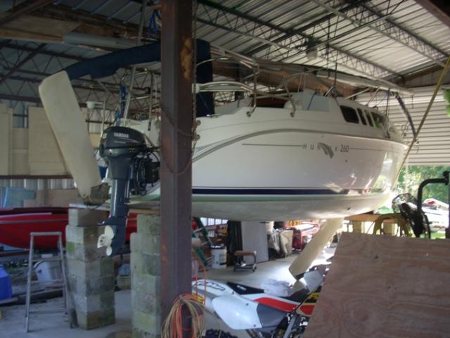

There were some reports of mount issues on the 26/260 that make me check on mine often(no signs of an issue on our '04). Your boat is sensitive to weight and since it's a displacement hull it'll only go up to it's hull speed potential (6.2+/-). Our 8hp high thrust Yamaha OB takes it there at about 80% throttle, add a head wind and simply add more throttle to keep it there(up to a point of course). Trying to push it past hull speed is really a lost cause only adding more weight and considerable strain on lightweight components.
Our boat was already rigged with the yamaha 8hp/HT/elec start/tilt/alt/pedestal controls and it's an ideal setup for a 260. After 5yrs of experience with it if I had to repower, which we don't, it'd be the exact same setup.

The powerhead of the 15 may be too big. We repowered our h26 with a High thrust Yamaha 8 four stroke. It was a tight fit, but the power tilt was awesome. The high thrust 8 was much better than the original Tohatsu 8. We were very happy with the new engine.
