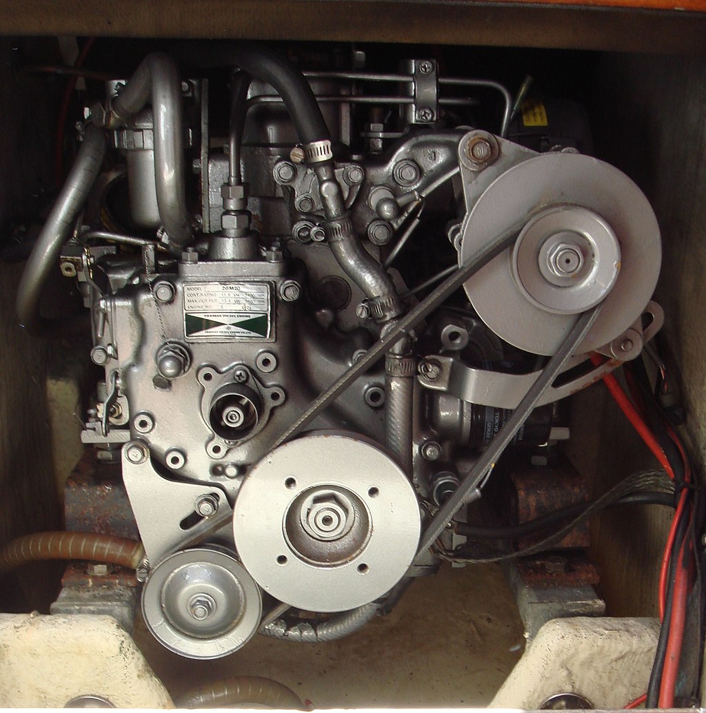

But I still wonder if the waterpump from the 2YM15 would work. Look at that pump and location here...
Now compare that to the 2GM20F...
I'm not sure it would work either... likely take a custom bracket... and the extra depth of the waterpump mounted forward might be an issue. But damn, the accessibility would be great. Heck, I'd consider an access port in the wood cover of my engine now, to gain that sort of quick change ability for the impeller.
I will try the bracket idea though... and a longer hose on the input side.

By the way - that motor in the photo is not an F. It is a direct seawater cooled model.
You sure about that... it has the heat exchanger on the top, just like mine, and the same hoses and pump. The seawater goes into the heat exchanger, but the heat exchanger has water and anti-freeze in one loop that runs to the engine. But I will admit that mine doesn't have those black/green hoses along the side to the top and into that hole below the engine. That appears to be some coolant bypass of some sort.

Quite certain. The photo you posted at 4:22 today lacks a coolant circulation pump. The main belt drives the alternator only. Also the id tag says 2GM20 (no F). Maybe the photo is not your motor?
Are you in Anecortes now?
Charles
Ah ha. I do believe you are indeed correct... and no, that is not my engine... I stole the image from wiki.
And looking closely, you are right, it does not say 2GM20F... the F is missing. I thought you were referring to the video.
My nomenclature plate clearly has the 2GM20F with the F being quite obvious, and the layout of the heat exchanger and other plumbing quite similar to that shown in the video.

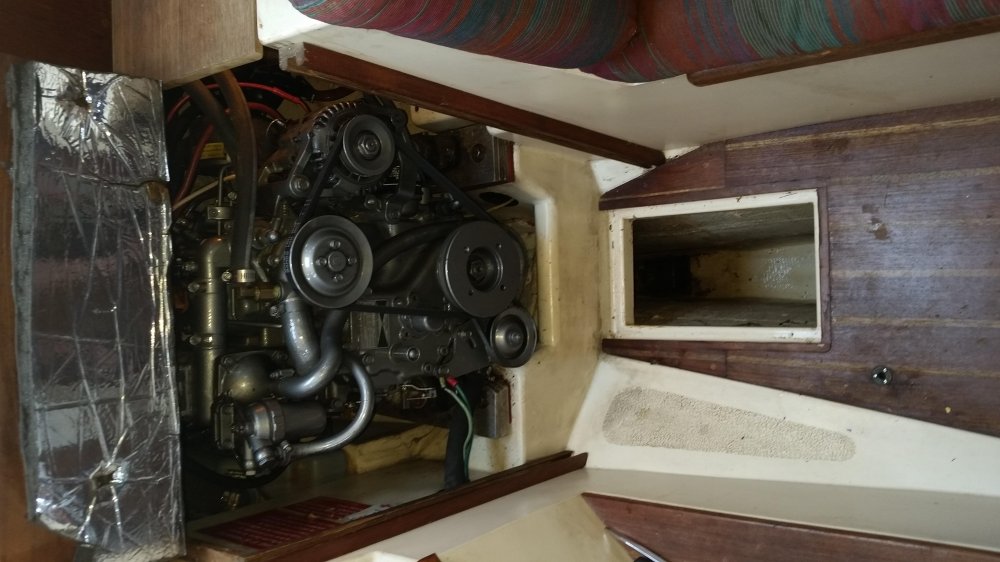

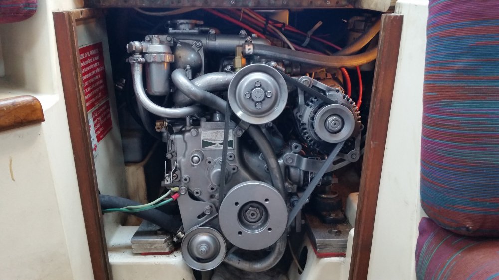

Just for grins, I thought I'd post my engine, so you can see that it is indeed a 2GM20F.
Look close, you can probably read the serial number. :biggrin:
And just for grins... here is that baby with the bilge showing... yes, the bilge is damp... I just changed the impeller... and uh, it was a bit damp in those hoses.
How odd... it got rotated... Well pretty sure it will still run. GRIN
