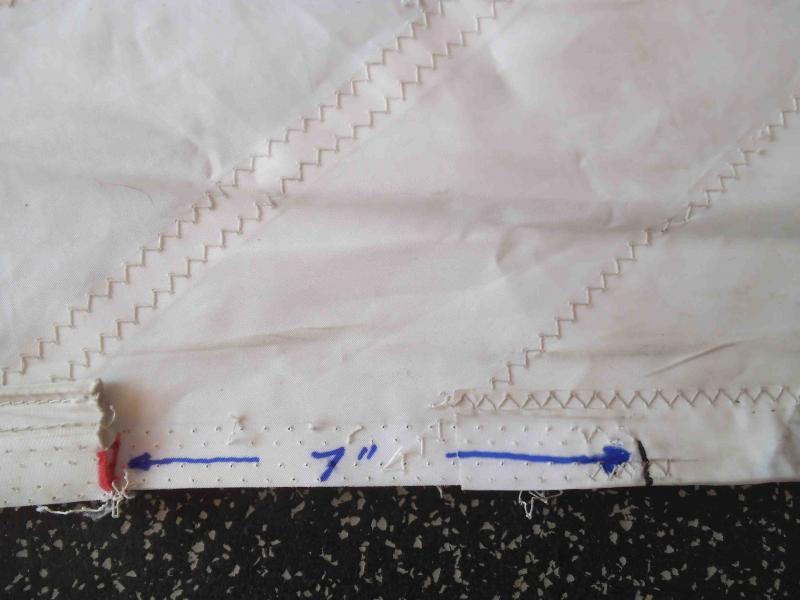

My first step was to cut the stitching that joins the #6 luff tape to the sail. Planning to use the same luff tape again, so I left the tape attached at the head. I was surprised to find that without the luff tape attached, the sail naturally laid so that the bottom end of the #6 tape piece (the end near the tack) is now 7" shorter than where the end was before. The luff of the jib is (was) 43'. I am aware that real bolt ropes shrink, but I hadn't thought that #6 luff tape does the same. In the attached picture, the black mark was the original bottom end of the tape location. The red mark is where it now naturally lays unattached except at the head. The tack is about 2 feet to the right in the picture.

Most continuous support tapes dont normally shrink nor stretch over time. If the tape does shrink it is easy to stretch it out to OEM size due to the small cross section geometry of the tape with a halyard winch.
Simple speak: continuous luff support tapes dont usually shrink ... more of a probability is that the sail fabric has relaxed or has become permanently stretched.
Jib OEM support tapes arent preloaded (shortened) as are boltroped (3 strand 'ropes' inside the luff sleeve). A sail that is designed to have a continuous support tape is designed so that the point of maximum draft occurs WITHOUT the extra luff tension needed by a boltroped sail.
If your current (loosened) luff tape is shorter than the sail (laid flat) dimension, then simply add a small piece of new support tape to either the top/head or bottom/tack of the sail and 'overlap' the tape (cut away the sleeve with the braided line on the section that fits into the foil groove - you can overlap the 'secondary' sleeve, the one that doesnt fit into the foil groove) --- the overlapped remaining 'tape' (less braided line) will adequately support the loads. Melt the ends of the various sections of tape so that they dont fray or unravel.

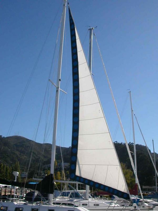

My sail has developed a bad case of Blue Dot Pox. Picture attached. How can I fix?
Seriously; to resume with the thread of several weeks ago, turns out that the extra 7-8" my old jib gained when I de-stitched the shrunken luff tape did indeed make it too long for the strike length of my furler extrusion. After going up the mast a couple of times this week to make repairs to the roller furler (topic was bantered about in a couple of other threads over the last week or so), today I was able to hoist the sail. Got it up, but absolutely no luff tension could be added without risk of again popping the swivel head over the top end of the extrusion. So slack wrinkles all along the luff. I have decided to shorten the luff by cutting 8-9" off at the head and then hand-sew in new head webbing. This may lead to some bad joss along the very upper section of leach ... but I'm not intending a top performance sail here. Just one that does reasonably OK.
This is the sail I also had asked for info how to cut more fabric from behind the luff to help compensate for years of sail cloth stretching and now too much belly. Today during my test sail, winds in central San Francisco Bay I would estimate were 15-20 kts. Sheeting in, the tell-tales were streaming back nicely at say another five degrees closer to the wind than they were before the mod. Restored to new sail performance? Not by a long shot. But a noticeable improvement anyway. I see I could have removed more fabric from the luff. But the project was worth doing. And I've now got Blue Spot Pox as a secondary benefit.
