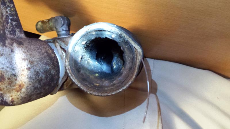

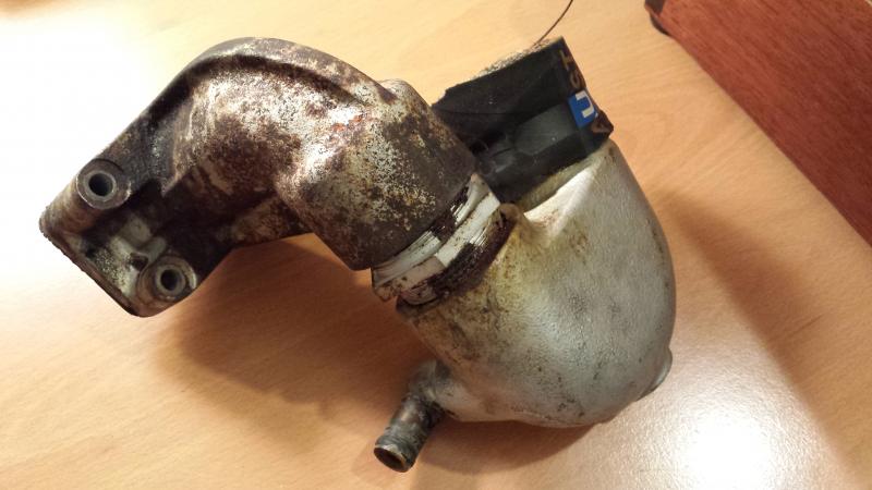

First of all, many thanks for all the input. The likely problems were either (1) fuel, or (2) the exhaust system. The problem was that these went down quite different paths, different levels of troubleshooting, time, expense, etc. I did a level 1 fuel troubleshoot first, that is, replaced both fuel filters, added fuel and new biocide, bled the engine, but no avail. I could have done more with the fuel issue, but decided to go directly to the much more significant mixing elbow. The access to that side of my engine on my boat is almost ridicously bad, almost like Hunter didn't want owners or mechanics to work or replace anything aft of the cylinders.
Anyway, Bayshore Marine in Annapolis sold me the mixing elbow, lower elbow, reverse threaded joint, and gasket for 370. The idea of trying to remove only the mixing elbow and clean it was out of the question. My friend Warren agreed to assist and we went to it in hot and muggy conditions below. I spent many hours lying on top of the engine block in very difficult circumstances, but in the end we managed to remove the entire exhaust column (difficulty level 4), install the new column (difficulty level 9+), and then the 3 hoses I have on my system, which are the 2'' exhaust hose, and the 2 5/8'' hoses that enter my cockpit locker and are joined with a vented loop. Attaching the new 2'' hose from the muffler to the elbow involves a tight run with a very stiff hose (difficulty level 6).
So after getting everything put back together and losing about 3 pounds in sweat, I had the simple task of connecting the 5/8'' hoses to the vented loop. In the process, the OEM plastic vent snapped off. Ugh! No firing up engine, had to go back to Bayshore the next day and pick up a Scot Vented loop, another 50 bucks.
So yesterday, everything reassembled, hose clamps hopefully secured, I hit start and whoom, the engine fired up beautifully. It had a sound like a purring that I hadn't heard before. I ran it at different RPMs and noticed that the excessive vibration at idle had almost disappeared. I think I have been slowly killing my little 2GM20F with deadly back pressure.
So for those who say that an engine won't just stop because of a clogged mixing elbow, it will, if the elbow is clogged enough. And this symptom mimics the symptom of bad or clogged fuel, except as one of you rightly said, you don't get soot in the exhaust just because of bad fuel. I only hope that the back pressure didn't cause any other issues that I will find out later.
So what did the mixing elbow look like when we pulled it? See photos. It's hard to see, but the inside of the elbow looked to be about 100% clogged. We couldn't see any opening at all. There were also large chunks of coke in the hoses, falling out all over the place, and I mean quarter and larger size hard chunks, almost like rock.
