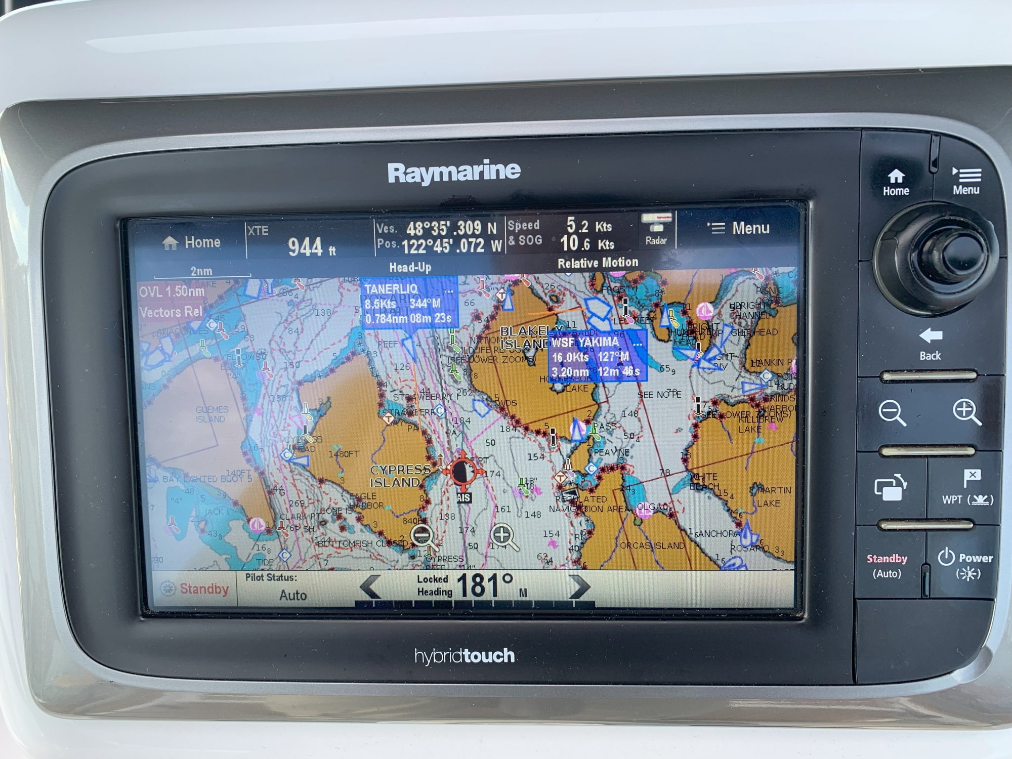

I also doubt that any difference between boat speed and SOG could have been that large to explain the discrepancy.
Scott this was taken not to far from Foswick's sailing grounds. Not through a pass or narrows where current can run much higher than the 5.4 kts experienced here.
I suppose. But he said they "stopped". I don't know how you can "stop" in 5 knot current and not know that you are moving enough to significantly affect apparent wind. Also, he says they were motoring at 6.5 knots. If he was motoring against a 5 knot current, wouldn't that be something significant to add to the mystery? Who does that anyway under normal circumstances ... motoring against a 5 knot current on a sailboat? I suspect that is something to avoid. I'm assuming they were motoring in negligible current. But, of course, not knowing the habits of sailors in this location, I could be misunderstanding.
