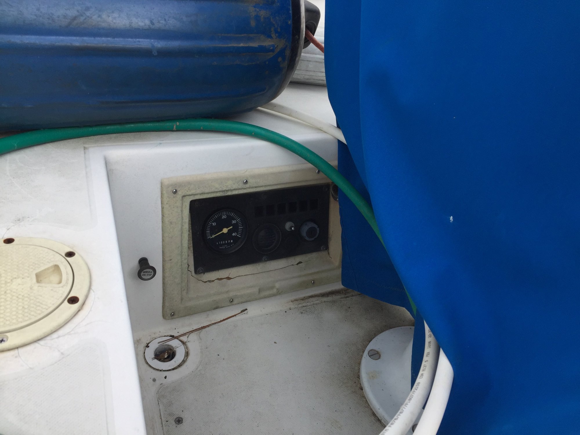

I know the instrument cluster/panel where the switch is located is damaged and looks like crap , for starters.

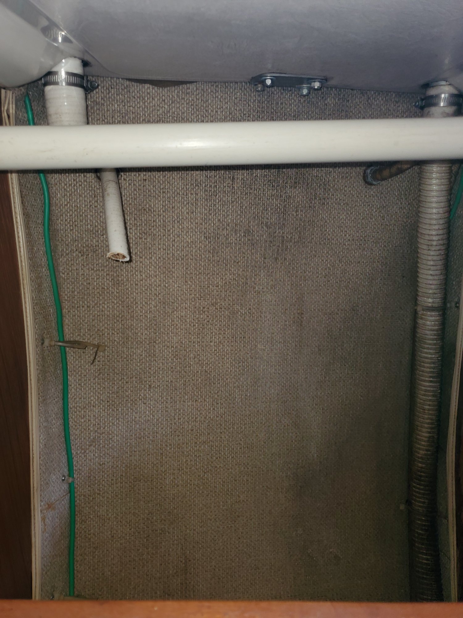

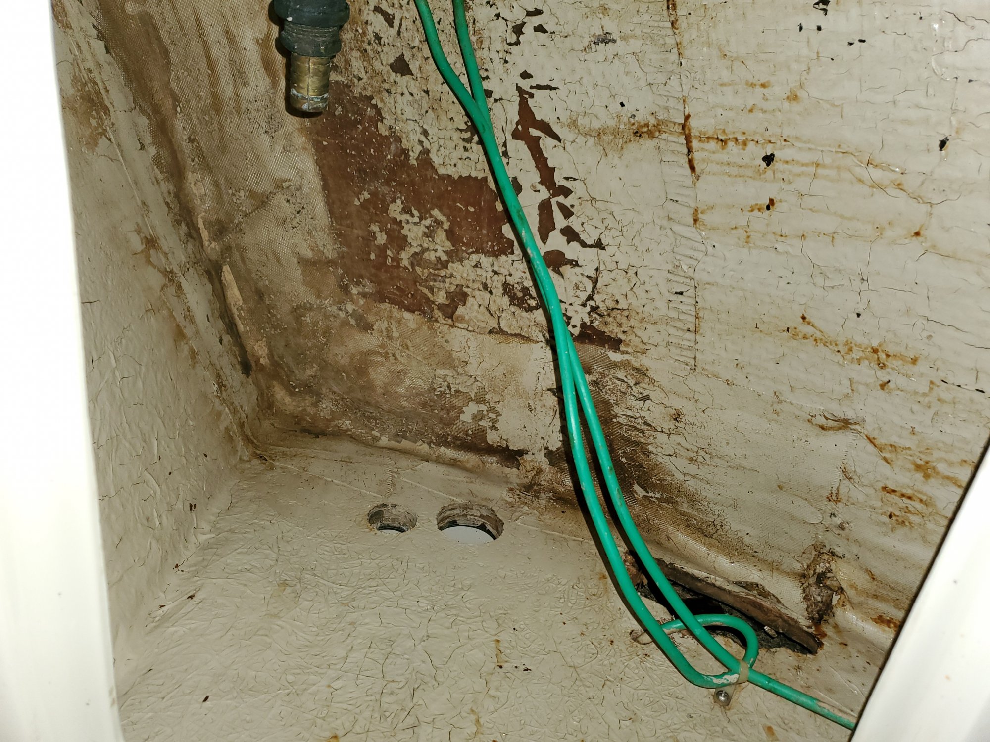

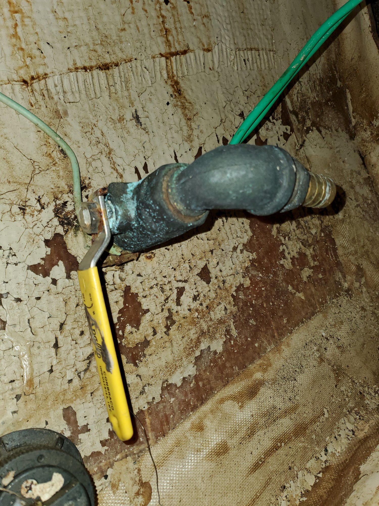

First , it appears there are two fresh water tanks under seats on saloon. One of the previous owners removed the head , cut lines and I think removed the waste tank. I'm thinking it would have been under the v-birth. looking for pics of the way the plumbing and tank should be...

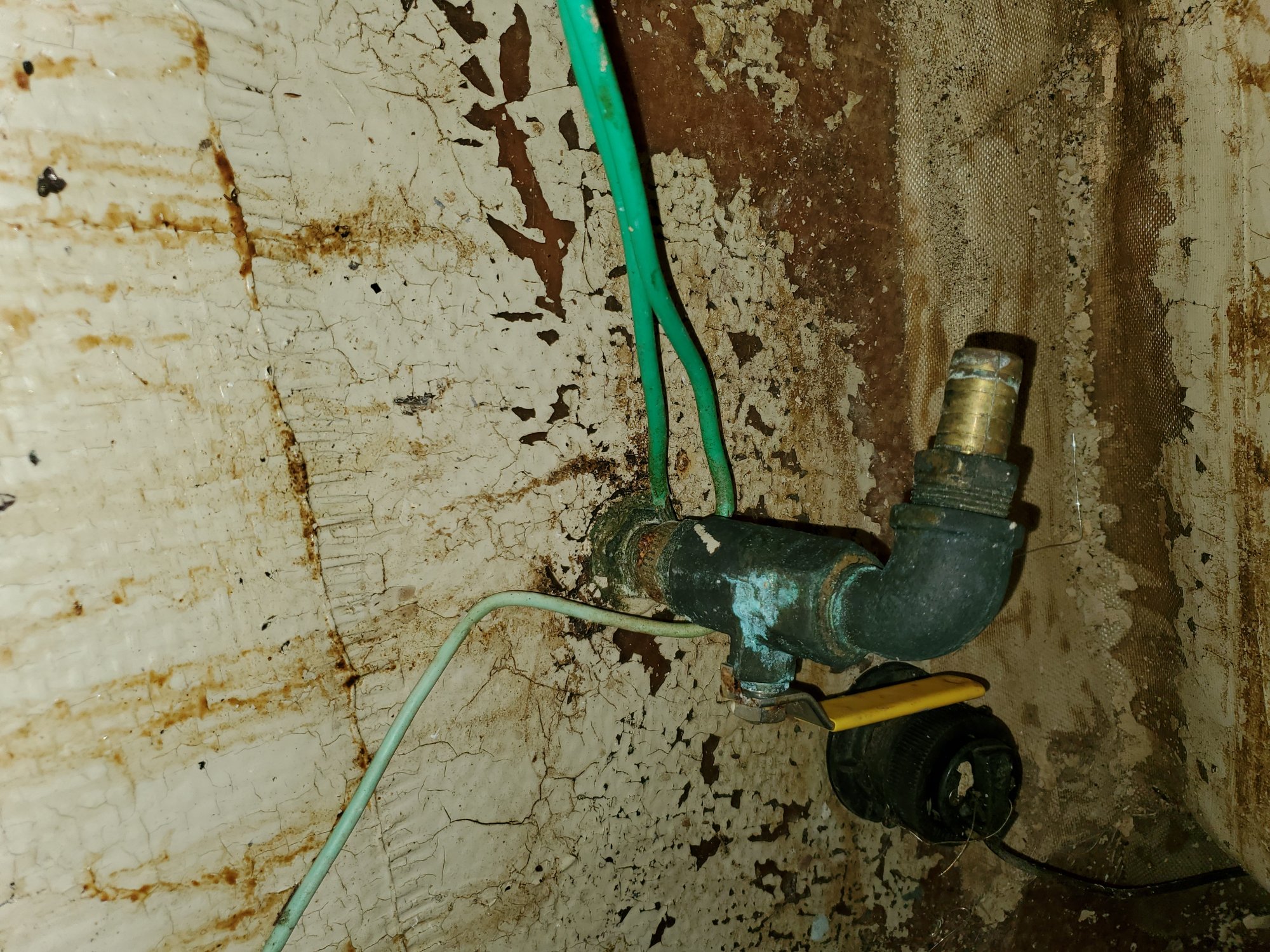

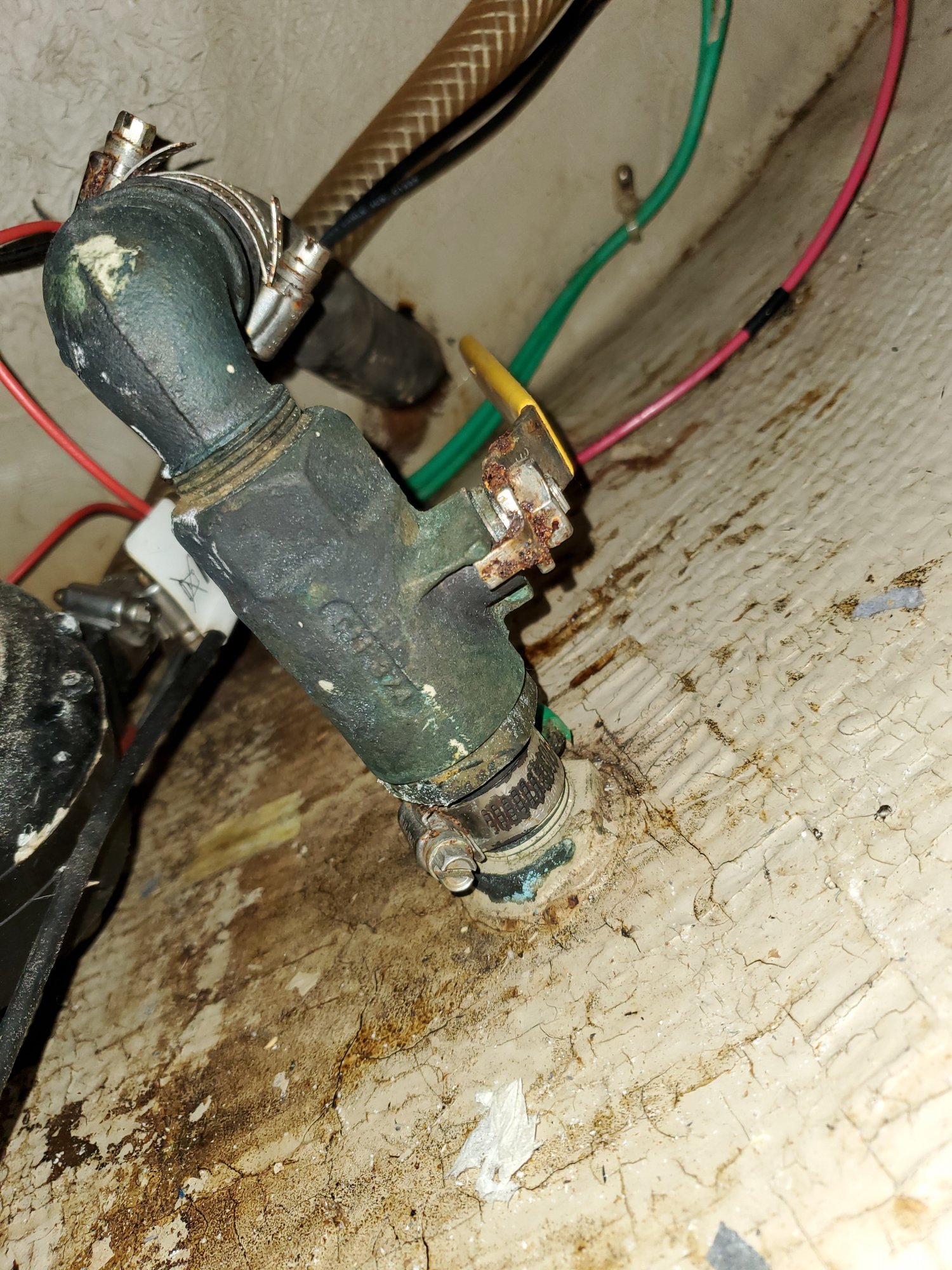

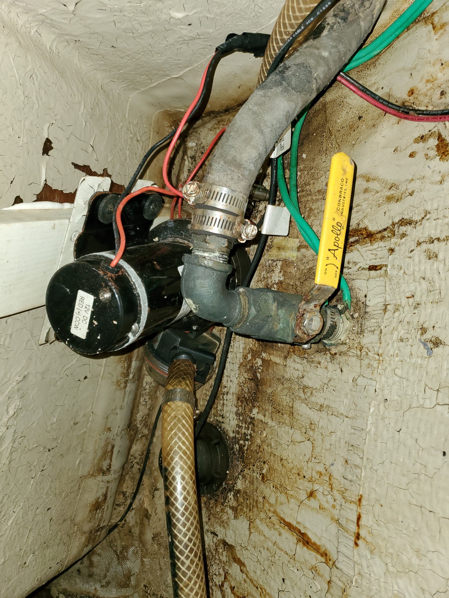

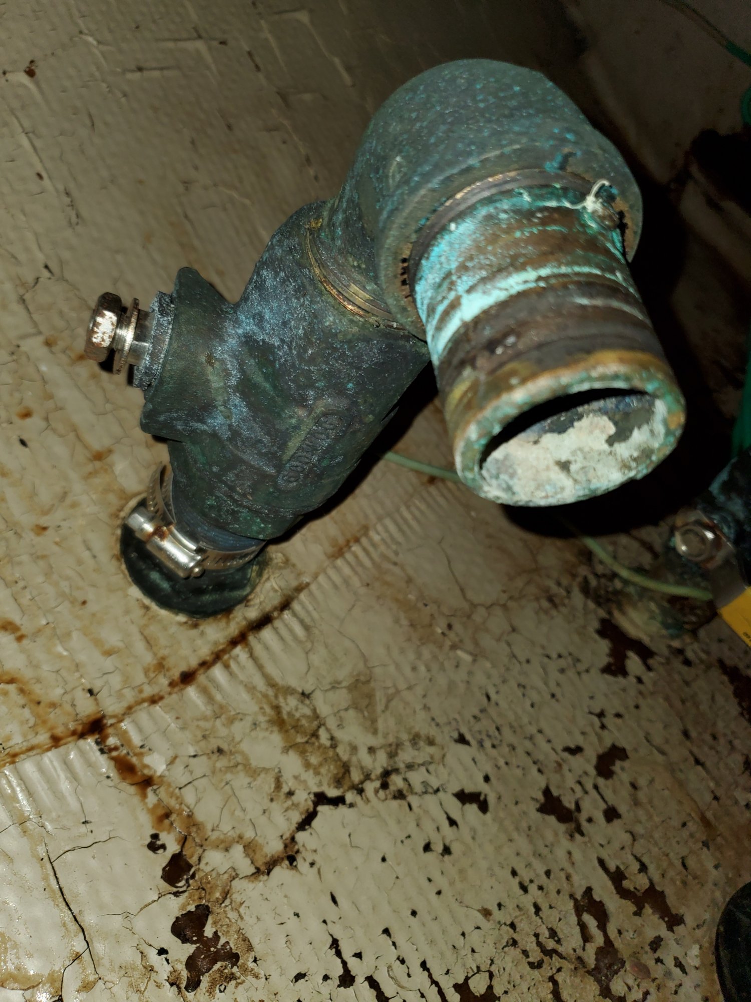

Secondly, do the through hulls and seacocks look ok to you guys? I think they do but I'm new to this.

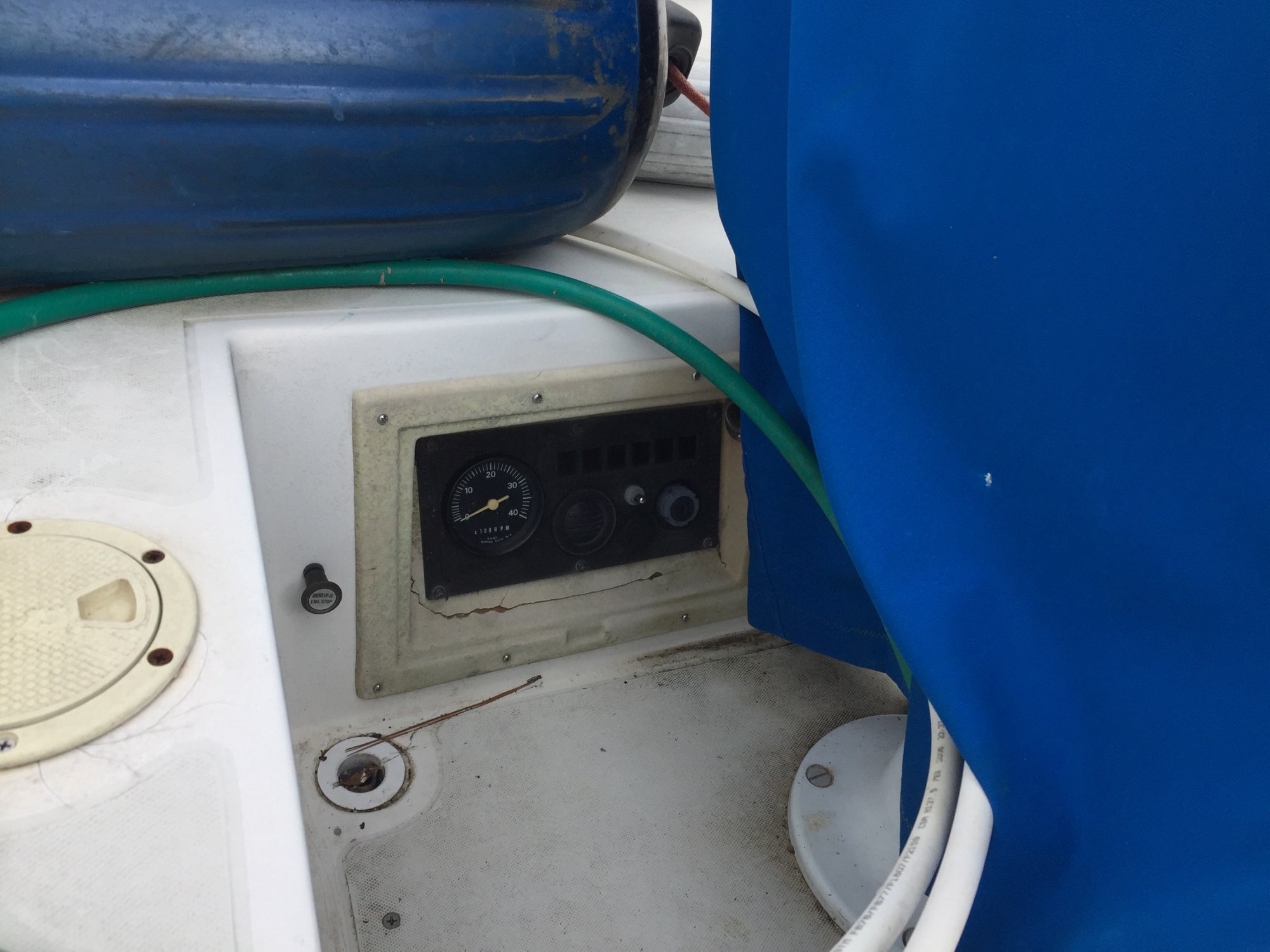

Any idea what the toggle switch does on the engine panel? I was able to start the Yanmar without touching it.

that's a very nice looking vote. that should be your glow plug/heater and may be warm enough that it started without it. I'd use it at least some on cold starts. I have a diesel in a humvee and it has it built into switch. if its warm the light goes off quickly but if cold you dont start it without waiting until light goes out.

No! There are no glow plugs on that engine!
The toggle switch (down position) is for testing the alarms (oil pressure, over temp, charge). It also turns on or off the light for the tachometer display (up position).
Strange , PO on mine told me to hold before starting. Alarm came on when I turned key to first place.
Nov 22, 2011
1,303
Ericson 26-2 San Pedro, CA
The PO is wrong.
When you turn the key on you hear the oil pressure buzzer because there is obviously no oil pressure until the engine starts. Once the engine starts the alarm should stop pretty quickly.
The switch on the panel is for testing all the alarm buzzers, as I mentioned above.
Again, there are NO glow plugs on a Yanmar 1GM. Trust me on that.

  • (Although your picture is not totally clear, it appears that the engine panel has a push button switch immediately below the toggle switch. The next steps assume that is so; if not, let me know.)
  • Turn the key switch to the right. You should hear the oil pressure buzzer go off.
  • Push the start button to the left of the key switch. The engine should crank.
  • Let go of the button when the engine starts. The oil pressure buzzer should stop.
(Note: If you start the engine with the throttle up high, once the engine gets up to speed you should be ready to throttle it back down to a reasonable idle speed rather than letting it race too high. If you only have the throttle cracked about 1/3 open, it may be that when it starts it will be idling at a reasonable speed already. Just be prepared to adjust the idle after the engine fires off.)

I missed the mention of the toggle switch, the first time I read through the attached. On second reading, page 24, step 2, I see that the toggle is used as Alan Gomes said. My setup doesn't seem to have a control which mimics the "Engine Warm-up knob".

Actually, it appears I got that backwards as far as the direction of toggle switch goes: the DOWN position illuminates the tachometer whereas the UP position tests out the alarm buzzers. (I just double checked the diagram in the manual.) The main point is the same, though, and it would be obvious in any case once you tried it. Regardless, there is no glow plug on that engine.
