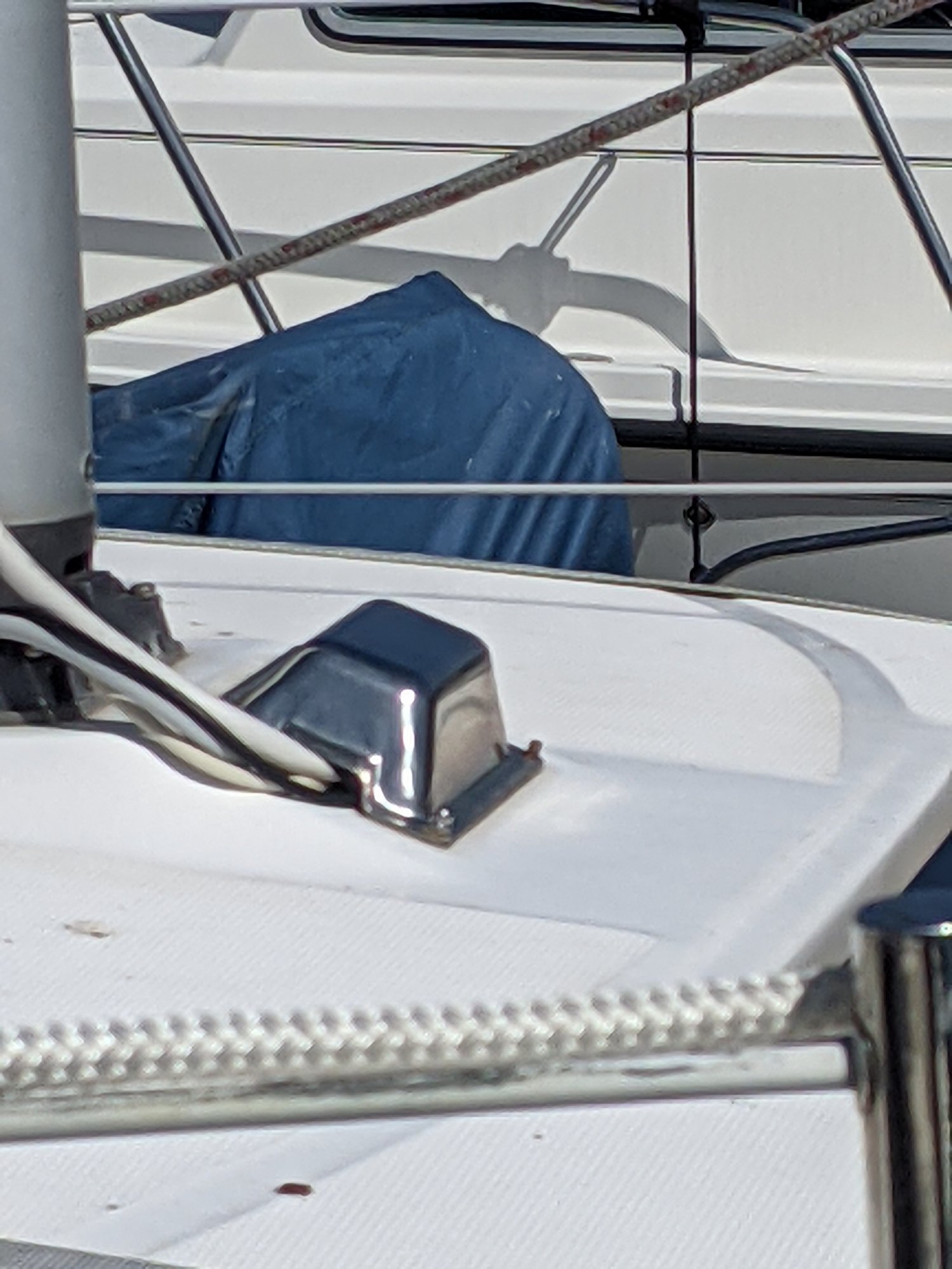

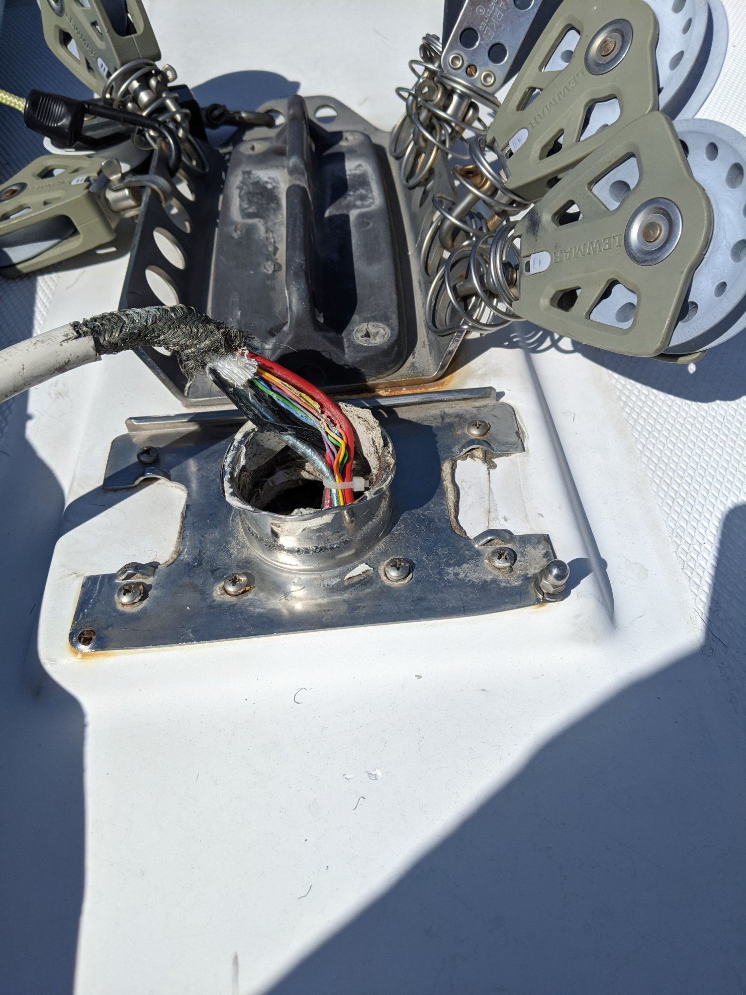

Has anyone removed the thru deck cable port box from their Hunter? Looks like it was standard across many models in the early 2000's. It was from a Swedish company Elvabro that does not seem to be active anymore. SBO website doesn't show it as an available part, though I do have an email into them.
Mine was damaged in a dismasting and if I can't replace the top piece, I will need to remove the bottom plate and it looks like it is adhered to the deck with some form of sealant. If you have removed yours, would love to know how you loosened the base plate.
Thanks to all!
24,949
There are a numbers of different cable glands that can address your need.
Here is a link to ScanStrut deck seals.
  • Helpful
Likes: ggrizzard
senang
Oct 21, 2009
318
hunter 38 Monaco
For loosening the base plate or other 3M 5200 devils product there is:
• Anti-Bond 2015 from JWB Environment Inc. USA (copied from my notes). Soak and let react for some time, redo if big penetrating surface.
