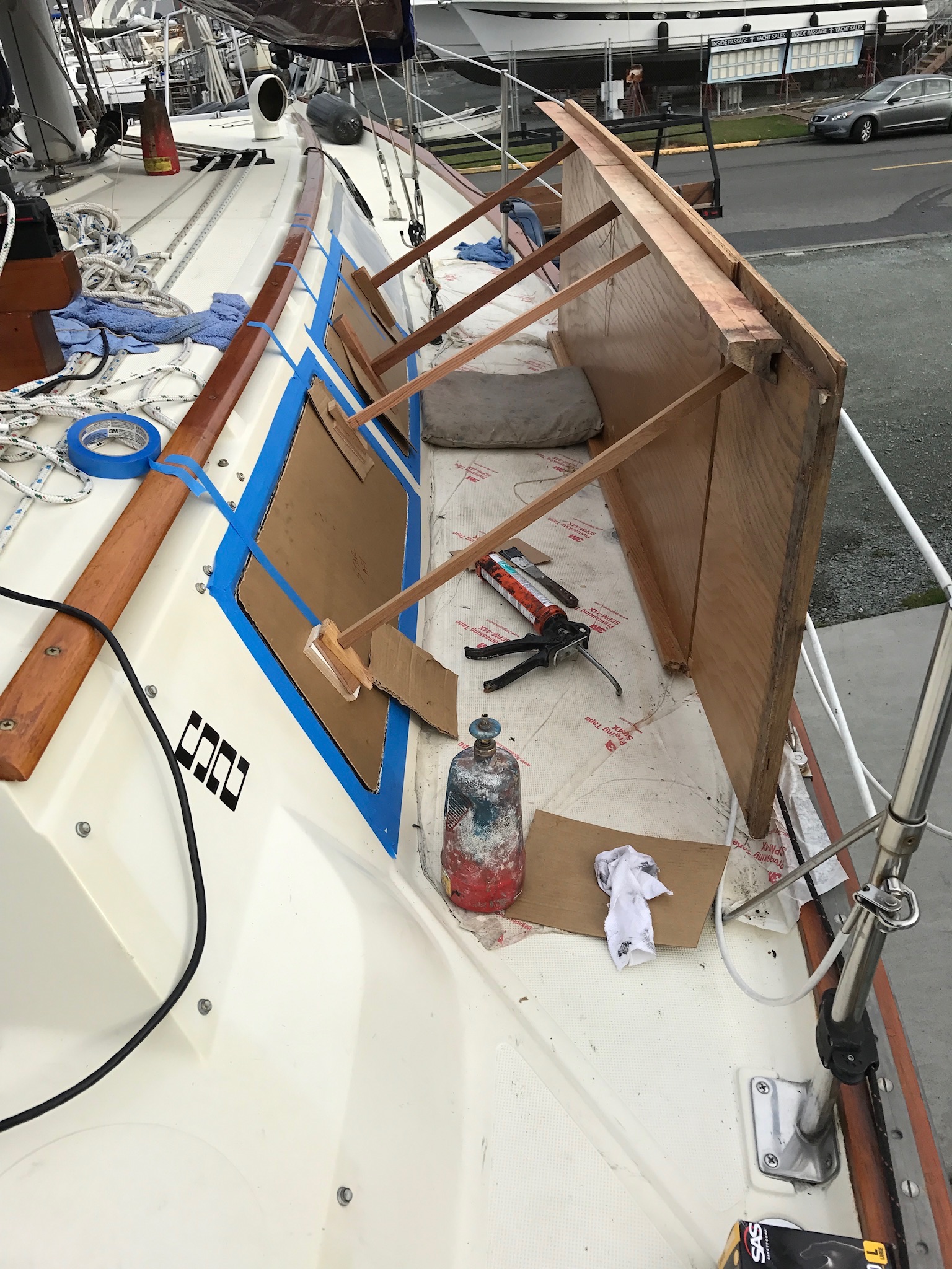

Jan 25, 2011
2,439
S2 11.0A Anacortes, WA
Well, how come you didn't tell me this 5 yrs ago! Ha! Just got through bedding in six new windows with 795. I think the times when Sika was used, they just taped up the windows to cabin side. This last time, (different yard) we put some plywood just inside the lifelines and used it as a platform to apply pressure to the windows with a length of wood and wedges until it kicked. Not to much pressure so as to let the window float...I think it worked out great. The shipwright who helped out stated he has has failures with Sika.
