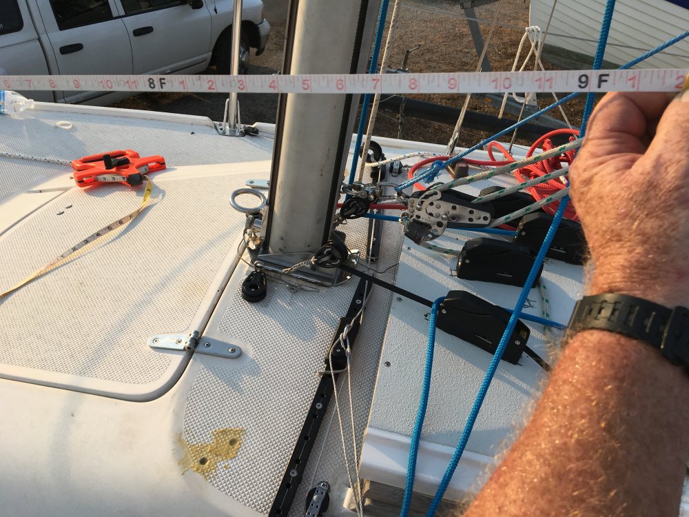

Just add cam cleats where Slarti indicated. Easy. Common on many boats like this, including the F-24.
Self tailing is nice, but you'll need the cleats anyway, since you don't keep the tails in the tailer preparing for tacks or in gusty conditions.
I'm really not a big fan of self-tailers on smaller boats. They almost get in the way. Bigger boats, yes, but I still had cam cleats for the above reasons.

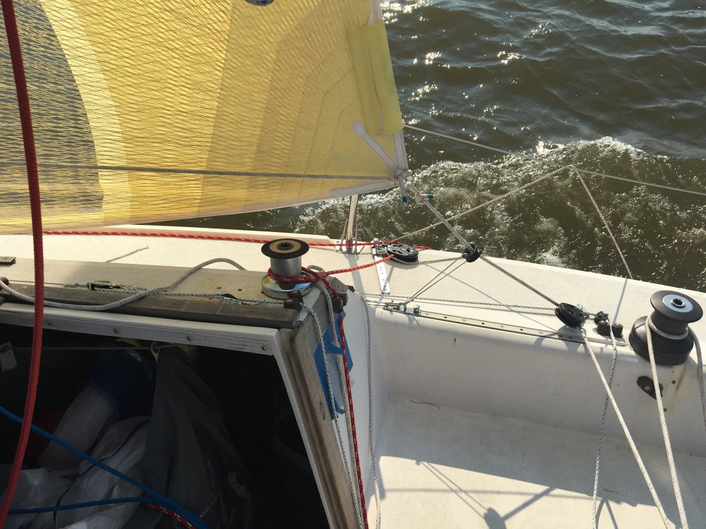

I'm considering adding cabin top tracks and have the same question as delling3 though I somehow missed the answer. When using the cabin top tracks is it a common practice to cleat the jib sheet at the cabin top? Or is the sheet routed to the cockpit winches, perhaps through a genoa car? I typically would not have the crew to manage sheets terminated on the cabin top.

^^ From the jib clew, through the genoa car, to the winch. The cleats are located on the cabin bulkhead below the winch as shown in post 3, self-tailer or not.
Really, you do not need crew. Single up the sheet as described below, put a turn on the new tack side. Just push the helm over, release the windward sheet with a tug as soon as it break, and quickly haul in on the new side. It helps if you leave the traveler low on the new tack, so that it does not want to round up. YOu only release the helm for a few seconds, but you can steer with a foot or knee if need be.
IF you time it right, there should be no grinding on the new side. Haul at the right time and you get it tight before the wind hits it. Timing is everything. Practice perfecting this with two people first.
When using a self-tailer the tail does not need to be in the cam cleat. That said, the jib can be eased more quickly if the tail is NOT in the self-tailer, only in the cleat. Also, in preparation for tacking you will pop the tail out of either and remove all but one turn, for faster release.
(The jib and winch set-up on an F-24 is virtually identical.)

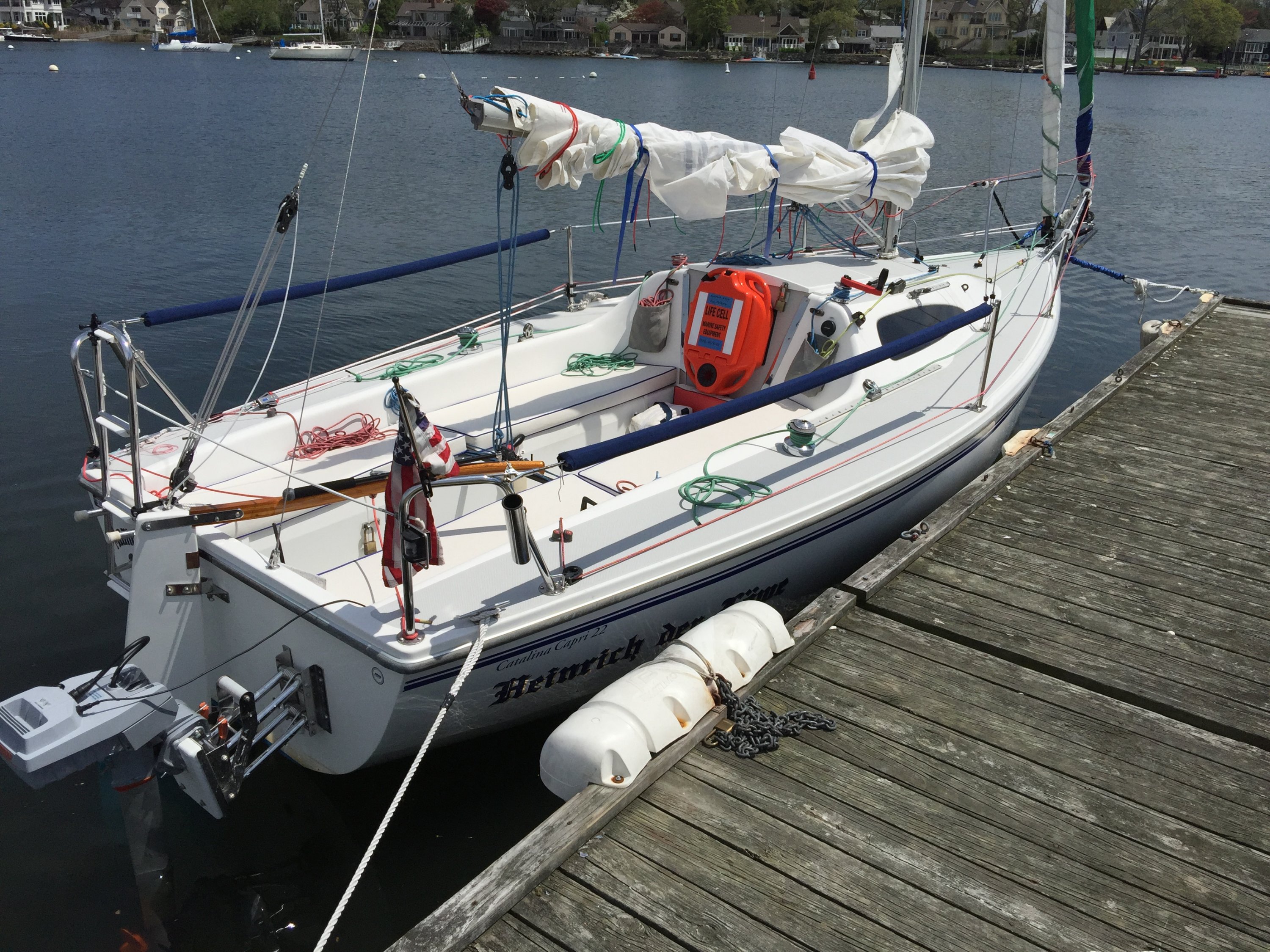

Catalina Capri 22 39 Seneca, SC
@odj22sailor,
Awesome! Your 2nd photo shows the exact setup I plan to try before adding a cabin top track and as illustrated by the photo the track may not be so useful anyway.
