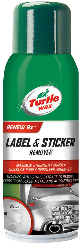

Tried multiple products on mine and none worked well until I tried this stuff. It works great.

Was planning to use a heat gun & plastic decal removing blade to remove mine. Glad to hear that the turtle wax product works well. Ordered the replacement stripes directly thru Beneteau's online replacement parts system.
