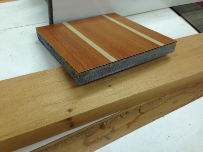

OK, I bought a few sheets of the laminate material used on our boat from Hunter's supplier, two 4x8 sheets of Coosa BlueWater 26 composite material. Here are the results of the experiment to find a suitable adhesive to bond the laminate to the composite. So far, so good!

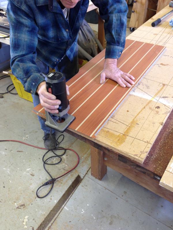

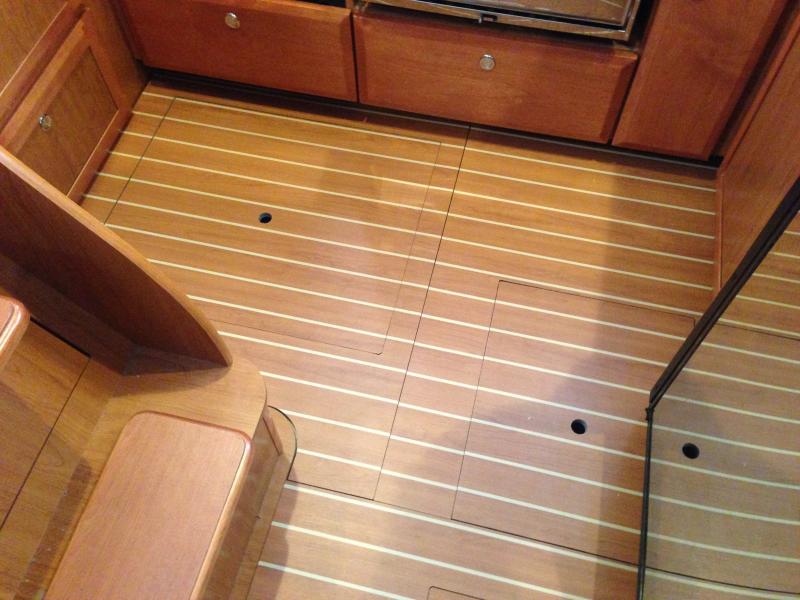

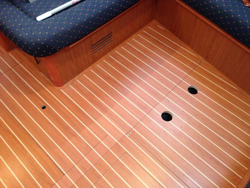

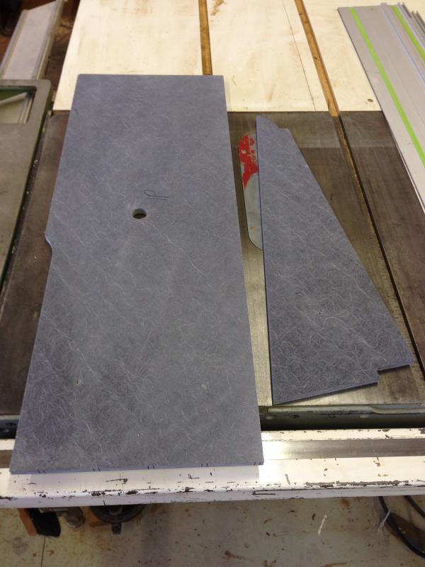

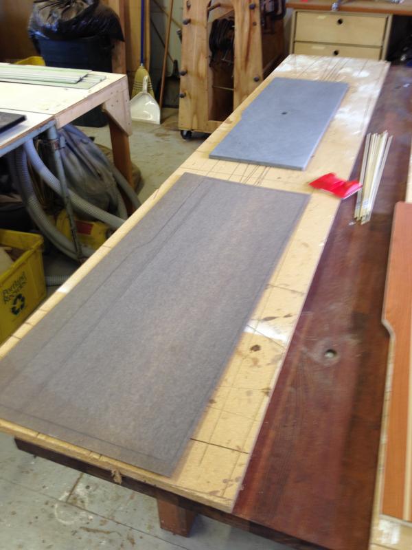

I picked up two 4x8 sheets of Coosa Bluewater 26, and managed to locate the mill that "built" the laminated plywood that Hunter used in our boat. That was the hard part. Hunter also kindly provided the CNC files for the flooring, which helped greatly. I did, however, learn that there is a fair amount of hand-fitting that went into the flooring of our boat. The CNC world translated to reality does not always work.
I've included some photos of the project in various stages, and also thought it would be worth noting a few takeaways.
- The composite material is pretty impressive. It is light and strong. It does have more flex than plywood, so I'm unsure at the moment whether it will work long-term for my removable hatch boards, but is absolutely great for the parts of the flooring that sit on plywood subflooring.
- The composite has a lot of fiberglass in it, so expect "splinters" if you work with the material without gloves.
- When routing the laminate edges, you have to be very careful when hitting an inside corner, as the router bit guide bearings tended to clog up with the laminate glue and didn't always freewheel like you'd expect and would become a bit of a cutting surface themselves.
- You have to be REALLY careful when countersinking the screw holes, as the drill wants to zip through the foam pretty quickly if you apply too much pressure.
All in all, it was a fun project and I think worked out well. Big thanks go to Jeff Sayler of Firehouse Boatworks here in Portland, who transformed my quirky project into reality.
<edit> The new pieces in the photos are those which don't have fasteners in the corners, as these photos were taken after fitting and before they were countersunk and screwed into place.
