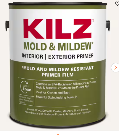

I had a persistent mildew odor in one of my boat restoration projects. After removing all of the headliner (carpet) and other soft materials, I performed a thorough deep cleaning. While that eliminated most of the smell, there was still a slight odor remaining. I then painted all of the hard surfaces with:
This stuff is great For mildew smells !!!. Not sure how it would work on ....:poop::beer:
