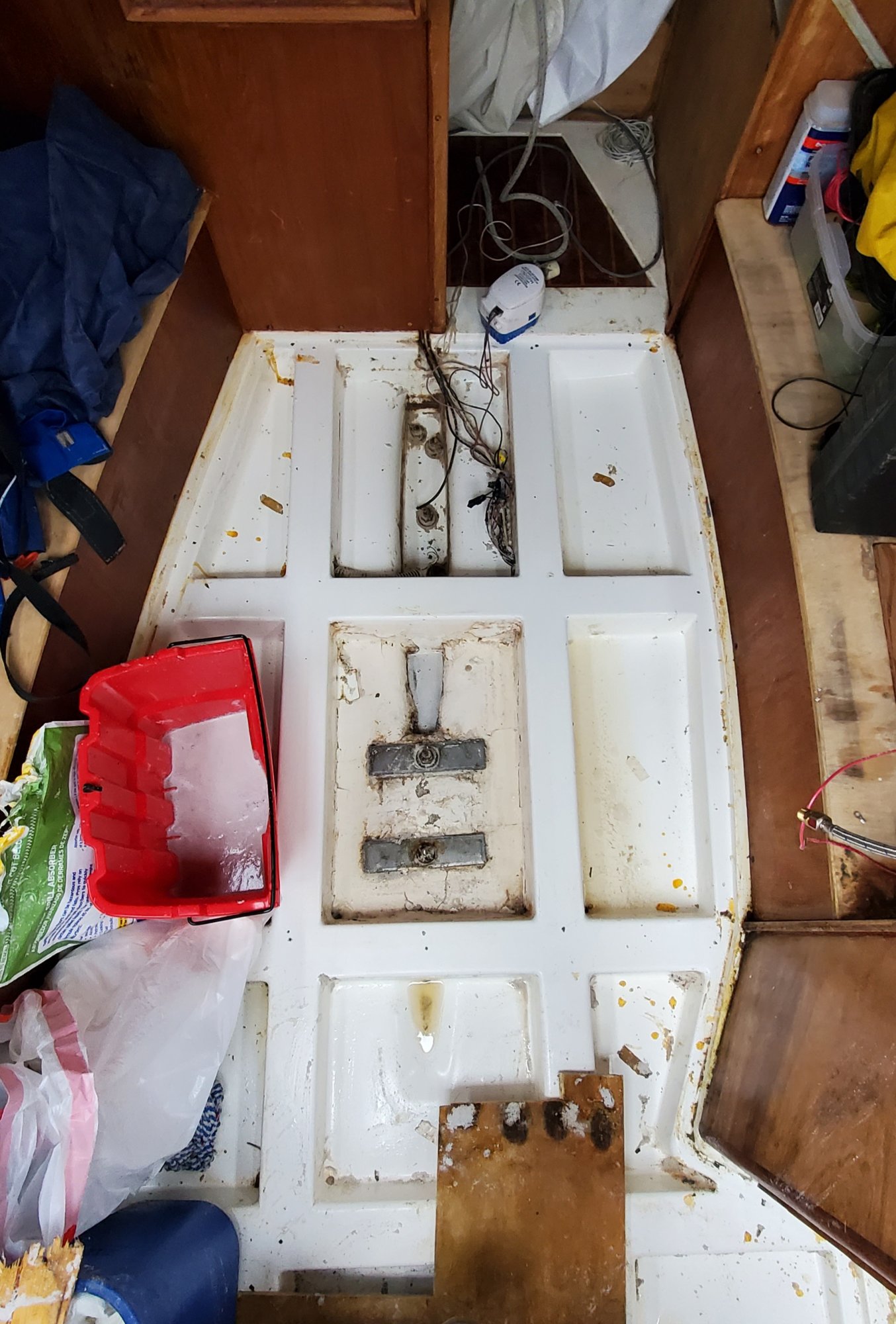

Could you take a look at this photo. Bilge liner I'm mentioning is like this. Doesn't seem like fiberglass to me. It's like a plastic mold right?

My H23 has a floor that looks like that (different shape of course) and it's gel coated fiberglass. Does the white color appear to be a rather thin layer on top of a sort of clear grey base, where you see larger chips? If so, it's almost certainly fiberglass with gel coat. The only boats from Hunter that I've heard use true plastic were some of the day sailers. Crazy Dave will know for sure.

Ok thank you. I've hesitated pulling off any chips but I think I need to in order to see if fiberglass is is behind it. I have to remove the chipping off parts anyway to repair it

The hull liner is fiberglass, it is part of the structure of the boat and helps to stiffen the hull and to keep the sides of the hull from collapsing towards the center. If there is a headliner, it too is fiberglass and it serves to look nice in the interior and to strengthen the deck and stiffen the boat.

It has been nearly 35-40 years ago watching the 26.5 being built at Hunter. The grid is part of the floor pan that is fiberglassed to the hull. The floor pan is fiberglass. The bilge area was then coated with white gel.
Since you are fixing the holes, cracks etc., remember that the bilge is a wet area. May I suggest using two part Water Tite epoxy in the bilge due to being a wet area as I found was the best epoxy to use but is expensive. As for painting, may I suggest using Krylon white spray paint formulated for plastic but you will need to Sand the surface first and wipe down with acetone. Wear protective gloves using acetone. Yes Krylon plastic paints do work. Get a color chart to match in the spray cans and mask off area

If using acetone, be prepared to change your gloves often. It slowly melts/degrades most disposable gloves. They feel thinner after some use but that's about it
