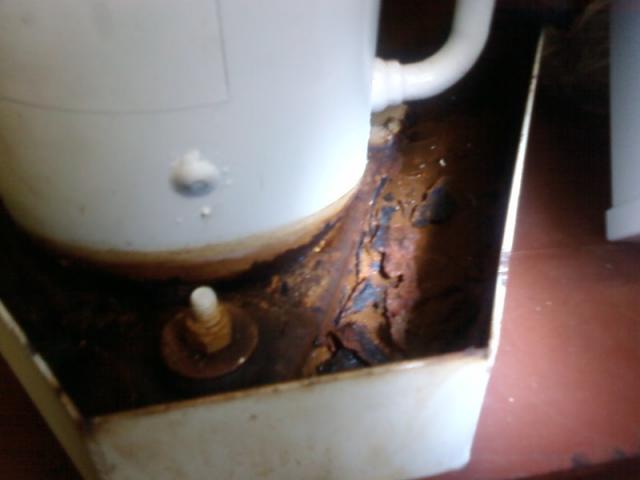

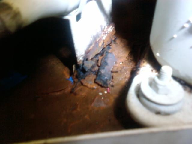

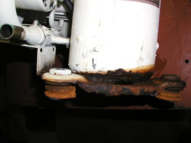

Finally got out to the boat today and sure enough there was no Freon in it.. Have it home now and looking it over.. Pics from phone cam are of the compressor bottom and the condenser bracket to the pan.. both mighty rusty, mostly from the pan not completely draining because of the 34's list to stbd.. There may be a pinhole from corrosion in the bottom of the compressor, but I'm going to pressure check it later to see where the leak actually is. More of this saga to follow.

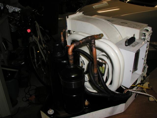

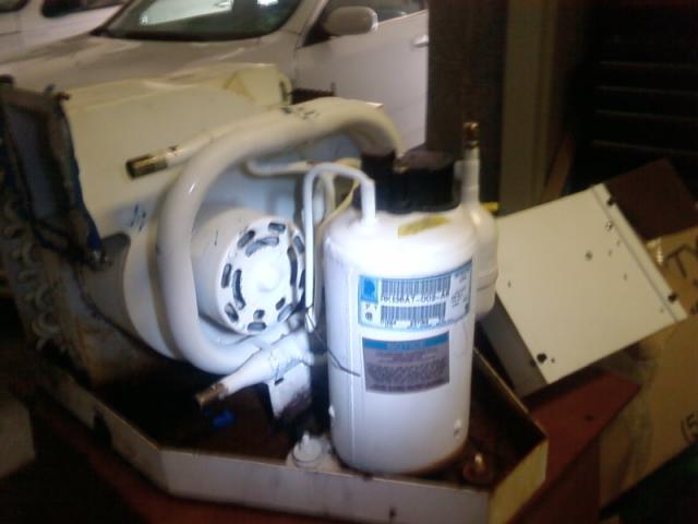

Ahhhhh.. Got the air conditioner back in the boat yesterday. The new compressor had a larger suction accumulator and so the re-installation was not straightforward. After 5 hours of working below at 92 F and 65% HumorDity It really felt good to get the cabin cooled and dry ! The old compressor case had holed through from corrosion.. I found the compressor oil in the bilge and cleaned it out.. If you have an AC unit, check the pan drainage to be sure that the water level is below the bottom of the compressor .. First picture shows the rusty compressor case from sitting in the pan water for 15 years. I shimmed the pan this time to get the water out from under the compressor. Pan was repaired with a partial new bottom plate and coated with the “Rhino” stuff that is used in pickup truck beds.. Cost to repair the unit was $620 (new compressor, compressor installation at shop, evacuation and pressure test and a recharge of F-22) versus a new unit at $2200 or so.. Uhhhh Pictures are reversed.. Old compressor is right side.
