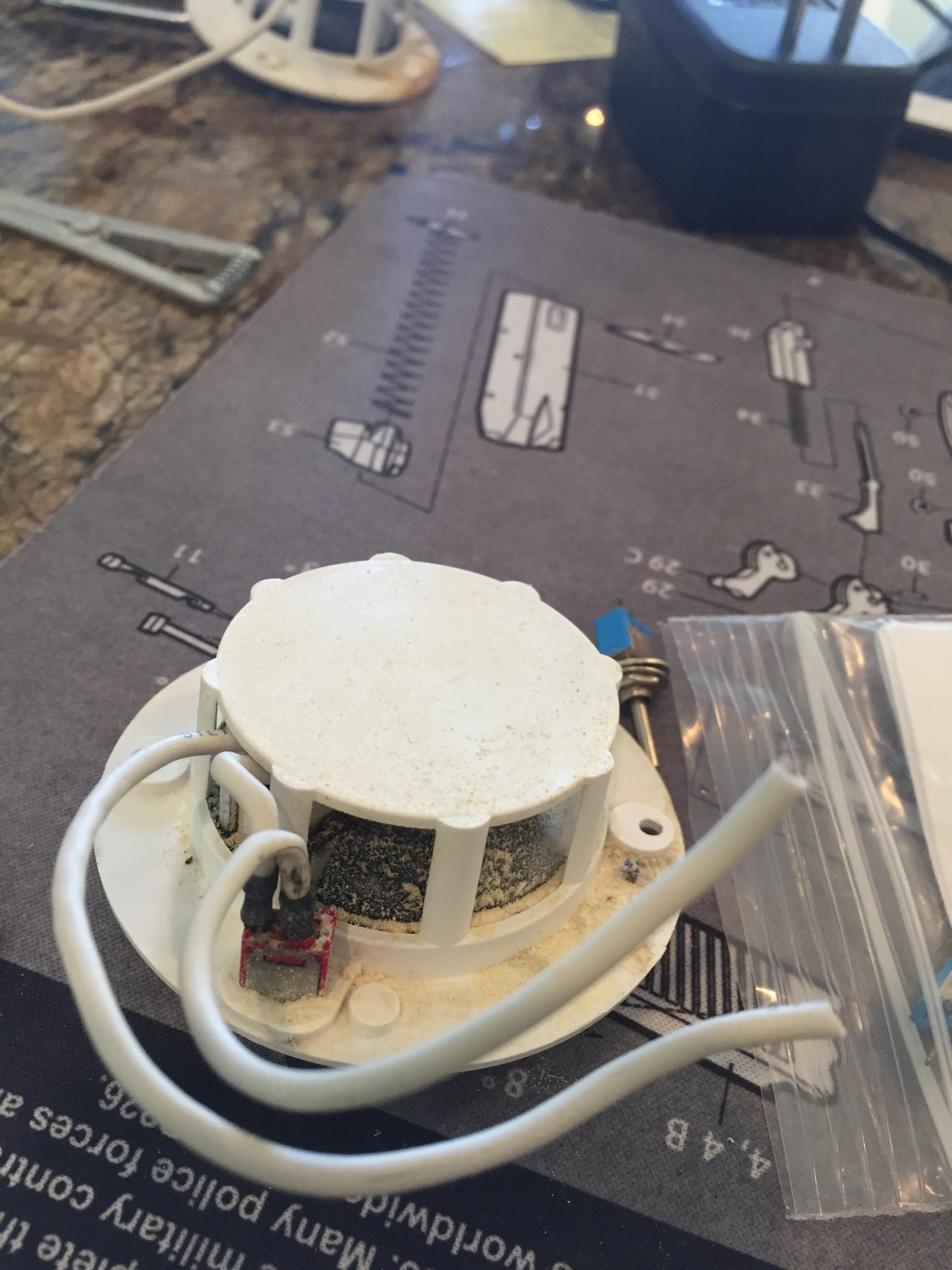

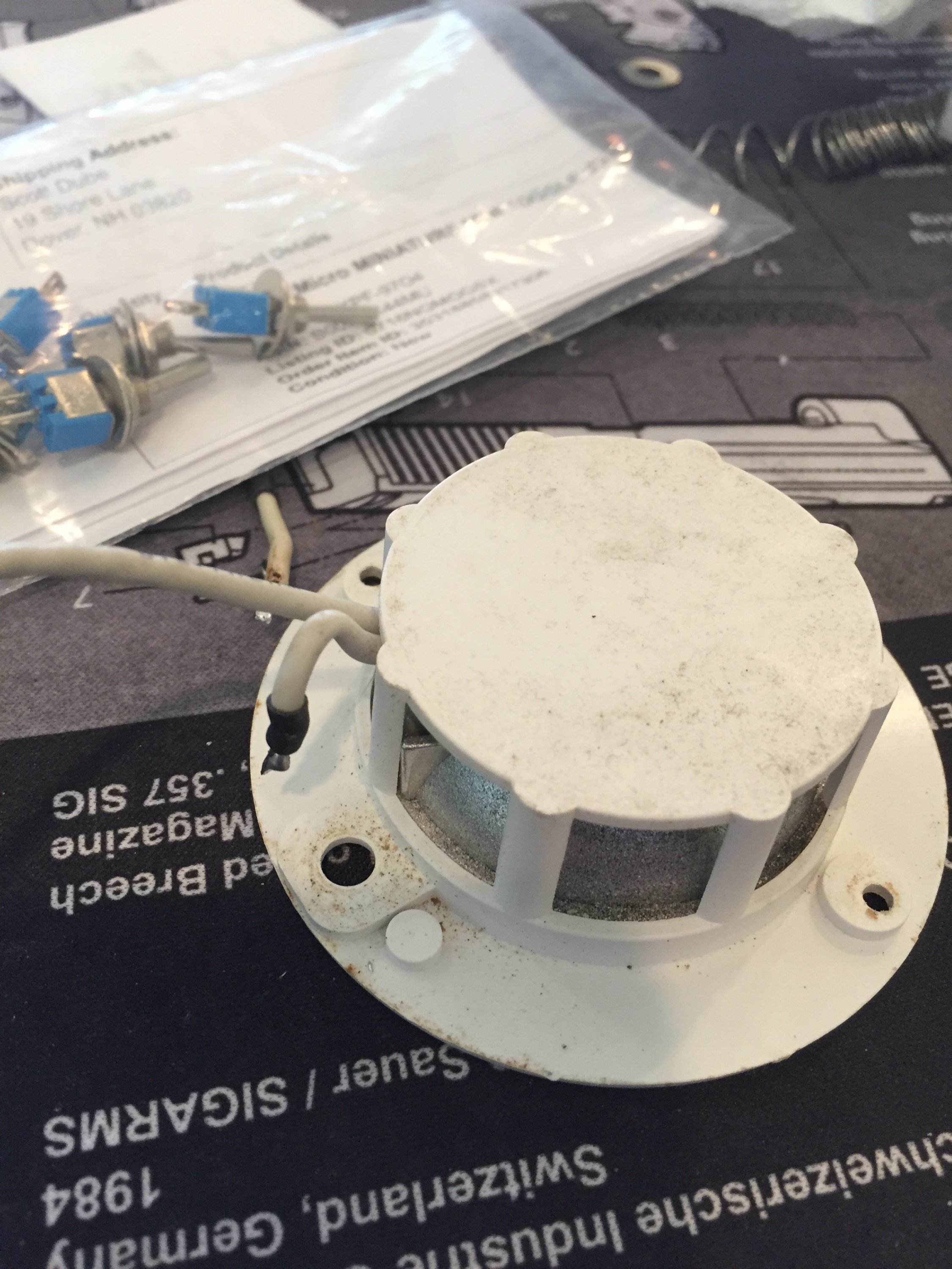

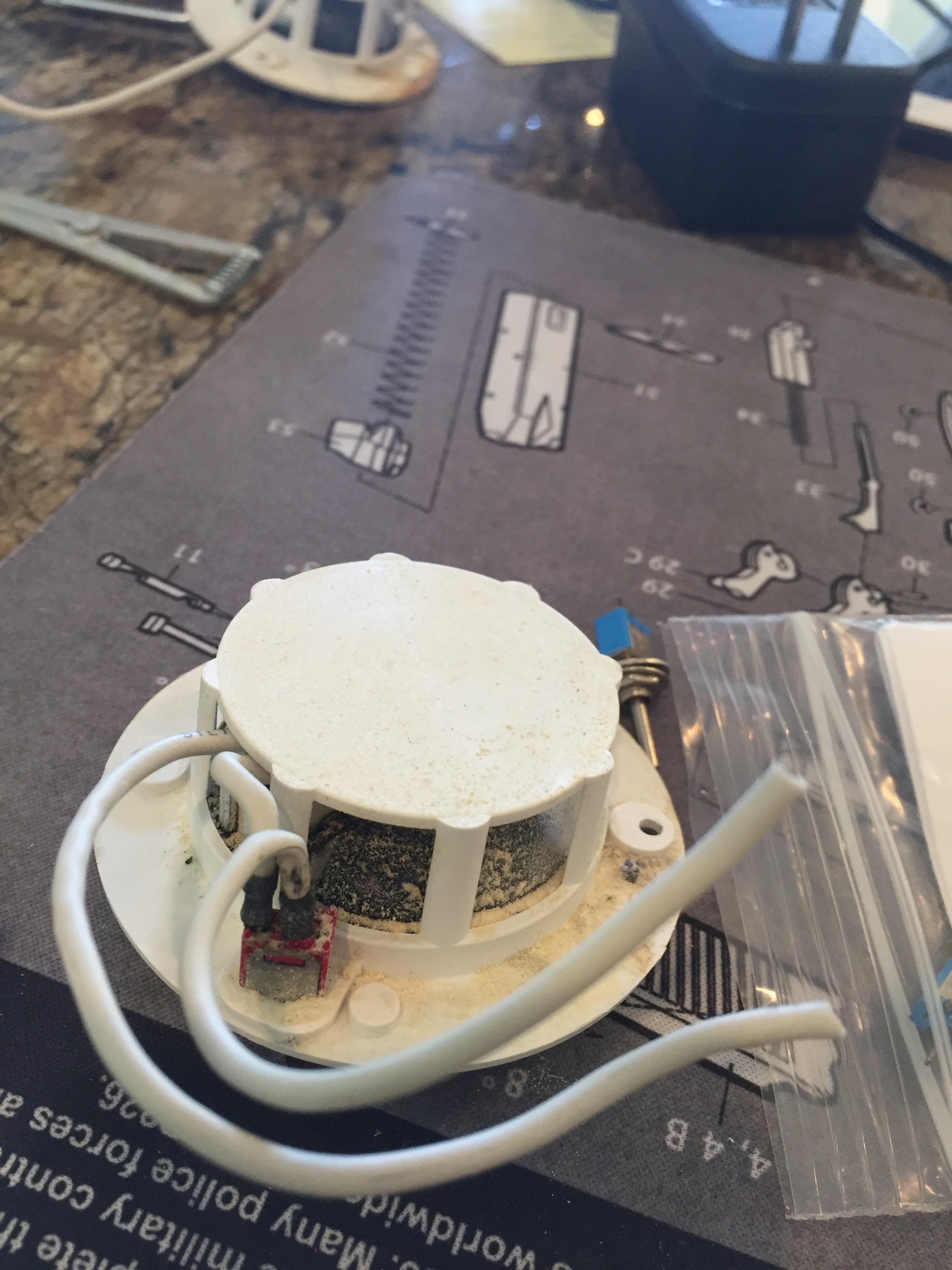

Over the years my cabin light switches have individually become intermittent then stop all together. After a season of not using the boat (last summer) this year most of them didn't work. In the past I have soldered new switches in, 1 offs not a big deal. But this year I had 10+ to do. I had been buying the switches at radio shack for nearly $5 a piece.

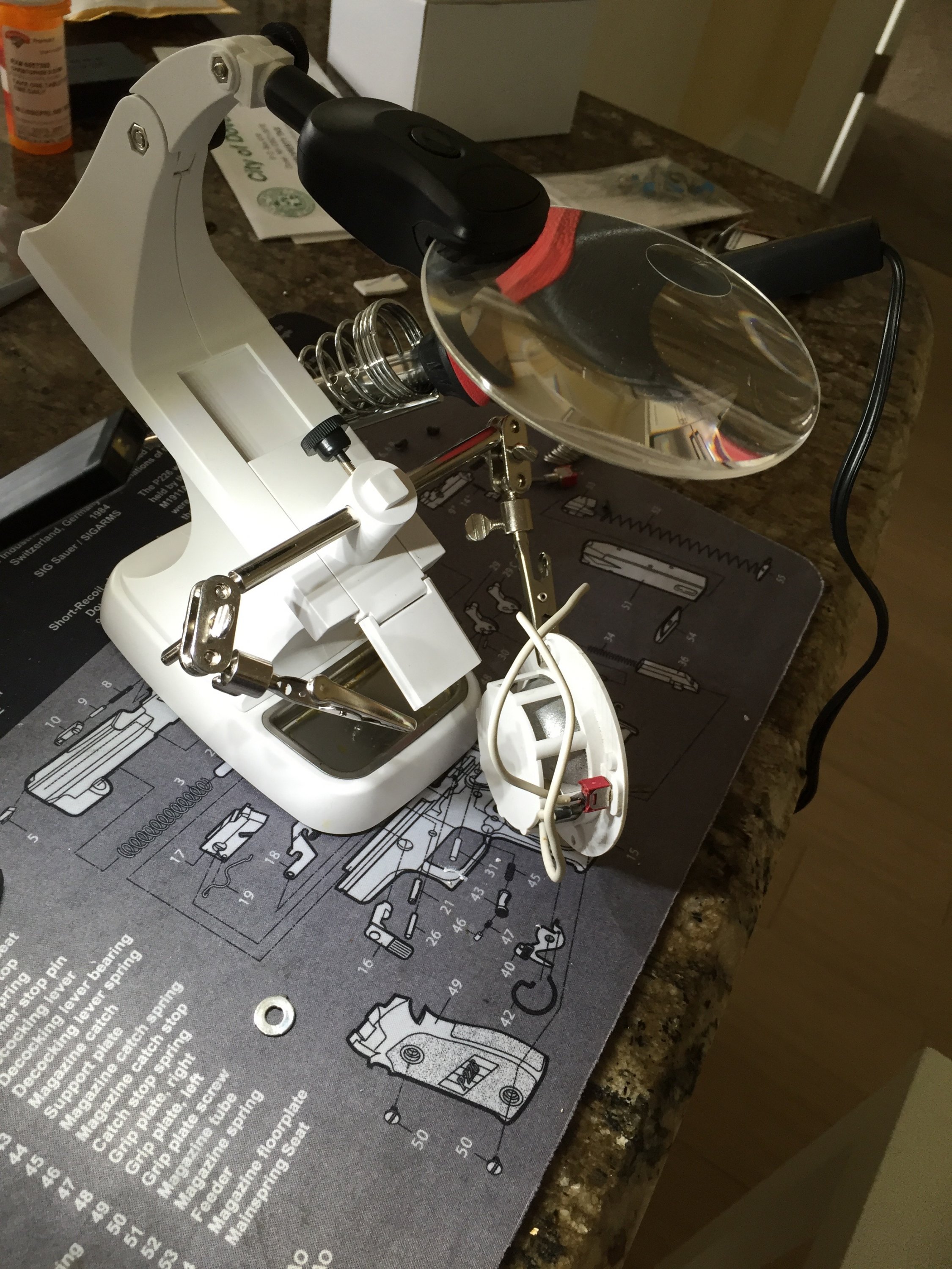

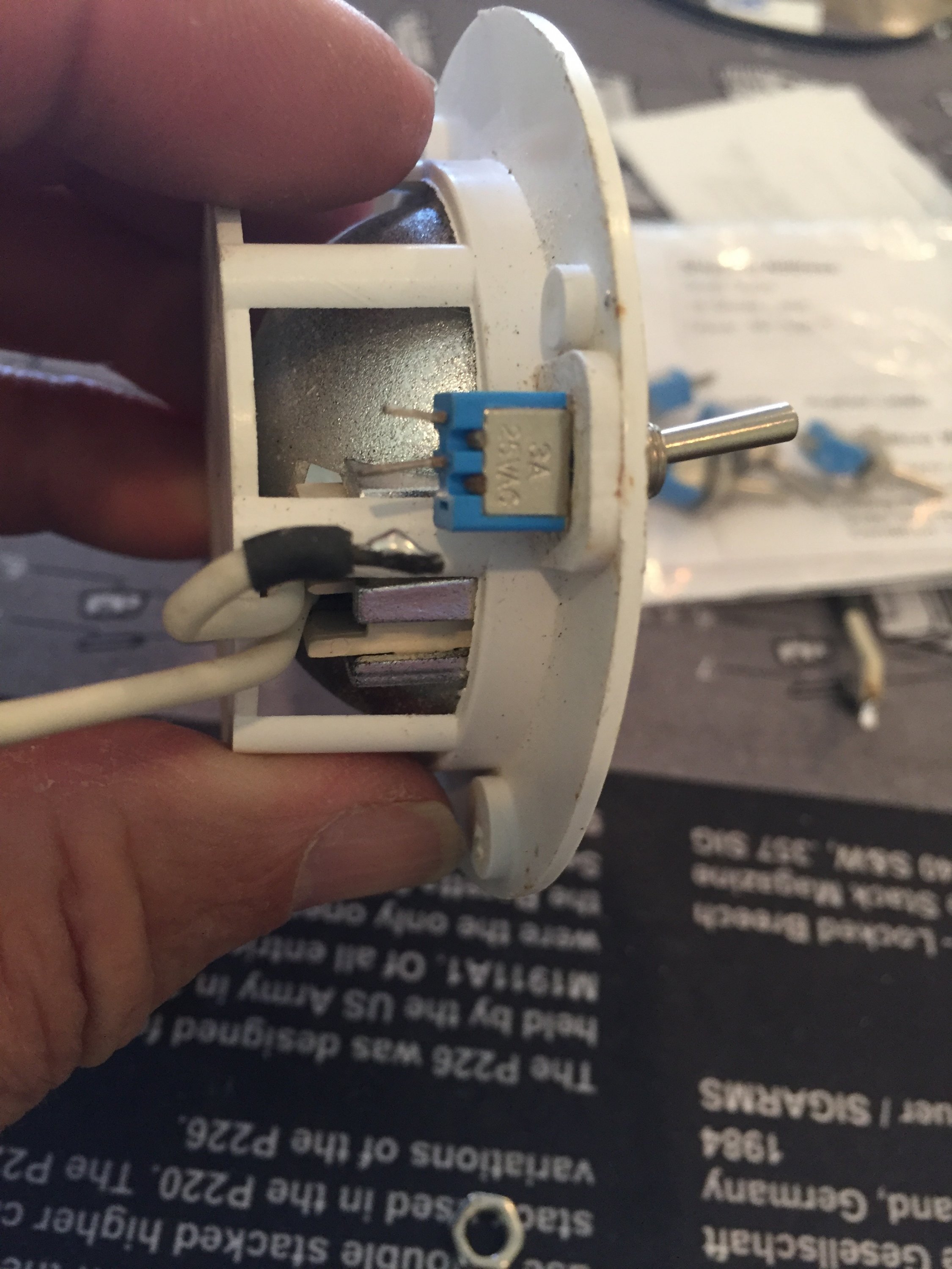

So this year I thought I would change the fixtures, then I priced them. I decided to look for switches again. I found Micro mini switches on Amazon. $5.88 for 10! add shipping $5. So I started pulling them out 3 or 4 at a time. These switches are a pain to solder because they are so small you have to be careful not to overheat them, it destroys them quickly. I just finished the last 3. I did ruin a couple of switches until I bought a set of helping hands, which I will have for future projects.
If you can solder and want to spend an extra hour on it you can avoid buying all new fixtures.
