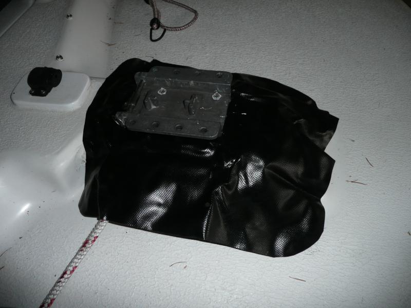

I pulled the compression post once to reseal the area under the mast base plate. It worked for a couple of years, then started leaking again. Decided with the amount of flex that must be going on there, I would always have a problem. So...
Have you noticed larger boats use a mast boot? I was trying to mimic that, but I use (double) blocks on each side of the mast base for halyards, outhaul and reefing lines. So I couldn’t figure out how to use those when they attach inside the boot. Then I struck on this idea. The base plate on my ‘98 H26 is two pieces. I removed the upper plate and put a layer of heavy (rubberized) material down on the lower plate, then screwed the upper plate back on. So it’s like a skirt. Using it this summer in a couple of heavy rain spells, it seemed to work.

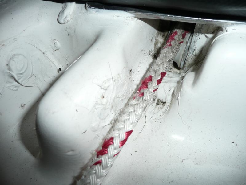

Also, on the side underneath the deck plate, where the centerboard haul line dives in. The compression post is notched out right there and the deck surrounds the rest. Impossible to get caulk in there. So, I “damned up” the bottom of the notch in the deck where the up haul line lays with 5200. Something to keep the water from just running down in there. So far, so good.

MaBell, do you remember what the rubberized material is called and where you got it. Great idea for a common problem. BrianW

I apologize, I can’t remember where I bought that. Could have been www.sailrite.com
I get stuff from there often.
It’s like a nylon mesh with a very heavy vinyl coating.
I used it to make a front cover (“bra”?) for my inflatable. The shorelines where we cruise are wickedly sharp with barnacles.
I think most anything would work. I used that because it’s weight keeps it laying flat.
