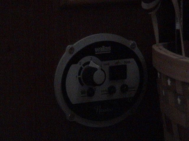

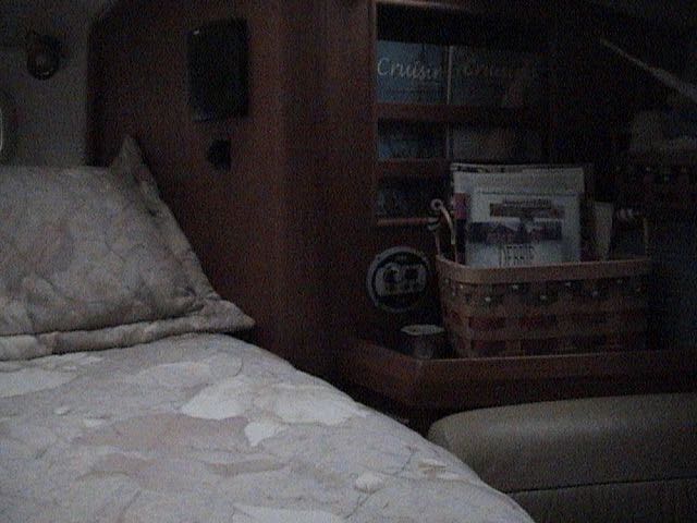

I like things simple. When I installed the Wallas 40D on our boat a few years ago the admiral and I talked about where to locate the thermostat. What we agreed on was the bulkhead right next to where she sleeps. Close to the furnace and easy to reach without getting out of bed.
So, at first light, she or I reach over and flip the switch and we go back for 40 more winks. The furnace turns itself on, does self diagnostics, begins to draw fuel, ignites and warms the boat. After the interior starts to become comfortable (about 30 minutes) we wake and start our day.
When it's really cold outside we will leave the furnace on all night on low so the warm up time in the morning is shorter.

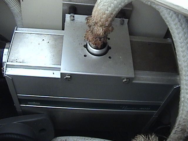

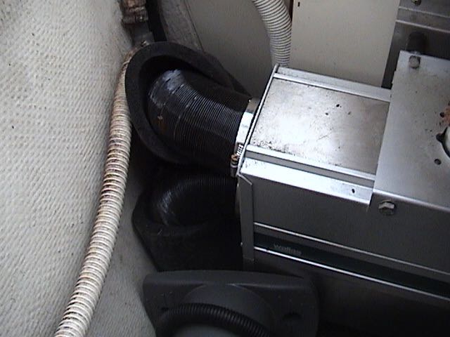

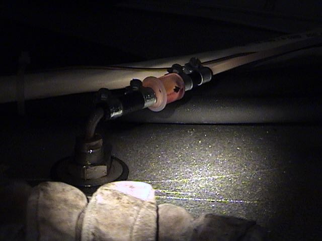

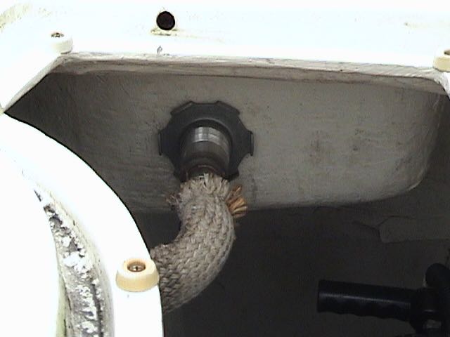

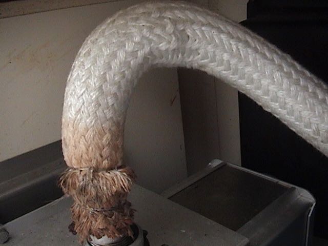

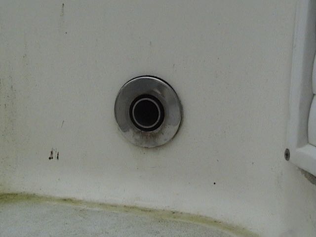

This weekend I drove to the boat to take some pictures of the Wallas 40D furnace that I installed in 2006. The admiral and I have enjoyed the comfort it produces on those cool and cold winter cruises around PNW waters.
The top two left pics show the exhaust stack hose with heat sock and a loop as advised by the manufacturer to prevent sea water ingress.
