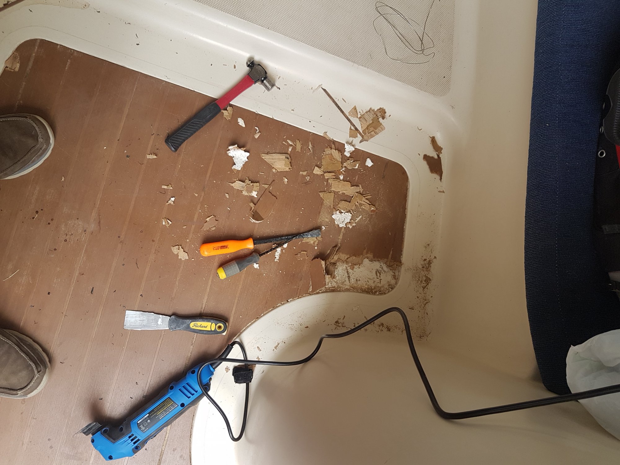

I just removed my floor. I had water sitting in it unknowingly and really damaged it. I tried some repairs but unfortunately it was too far gone. The floor was indeed 1/4" an was installed with either 5200 or more likely liquid nails. Either way, it's quite a chore to remove it. I purchased some cheap synthetic faux teak flooring from a Chinese web site. I'm happy with the quality of the product, just haven't installed it yet. Spring project. It came in a 4 x 8 foot roll and it cost $120 Canadian.

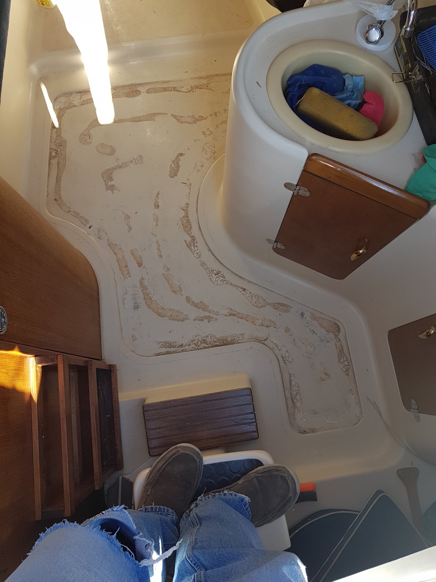

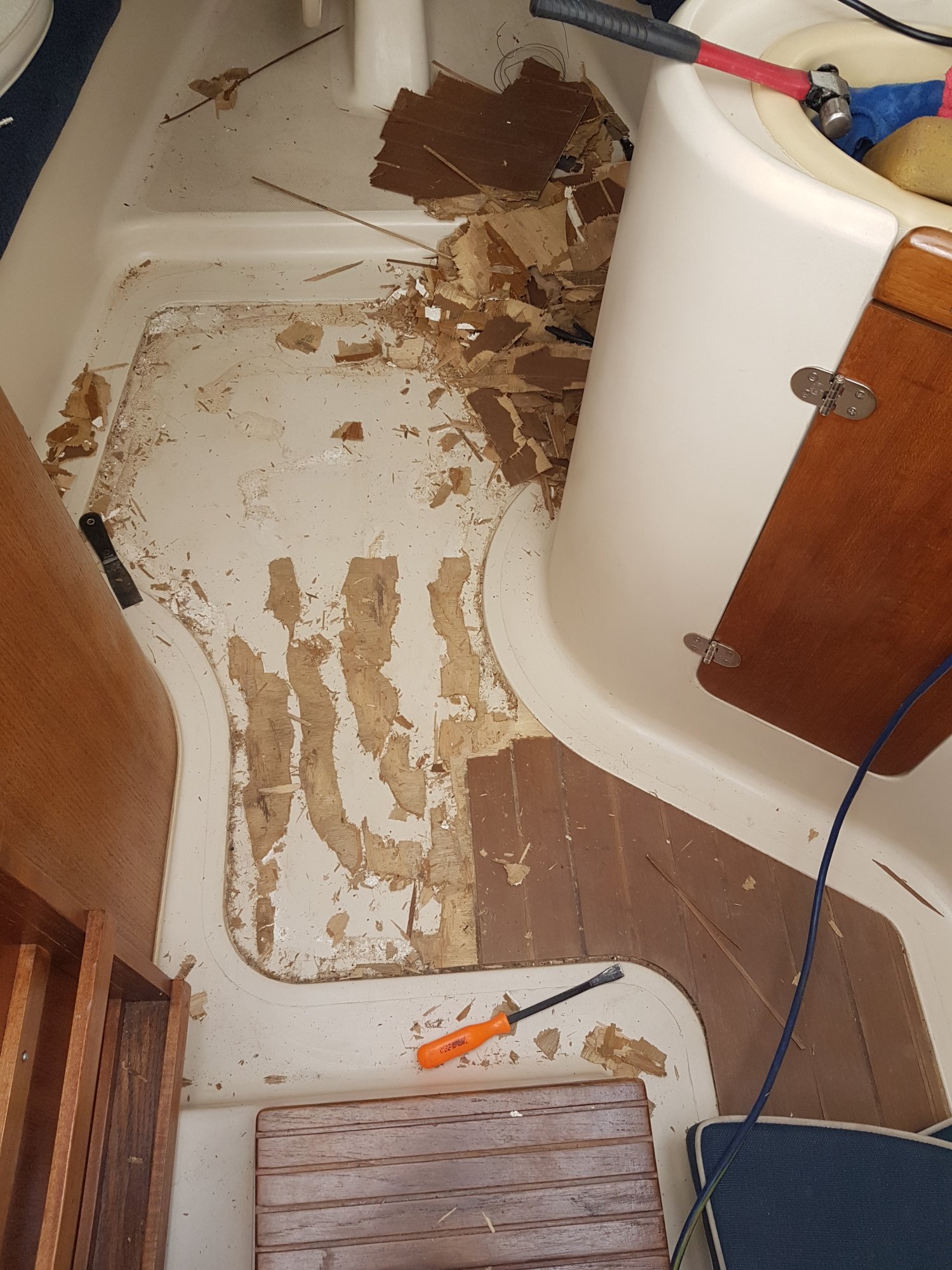

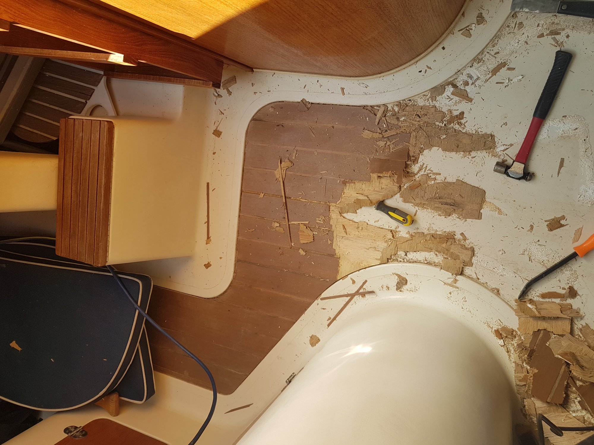

Figured out how to attach pics. Cant seem to do it from the phone app I don't think.
In the last pic you can see the remains of where the liquid nails was holding the floor down and how it was originally applied. Those were the real challenging areas to clean. I finally used a product called SC400 to clean up those hard areas and it worked really well. You can get it from Acklands in Canada. In all, it was much more difficult to do than I imagined, but feasible to do.
