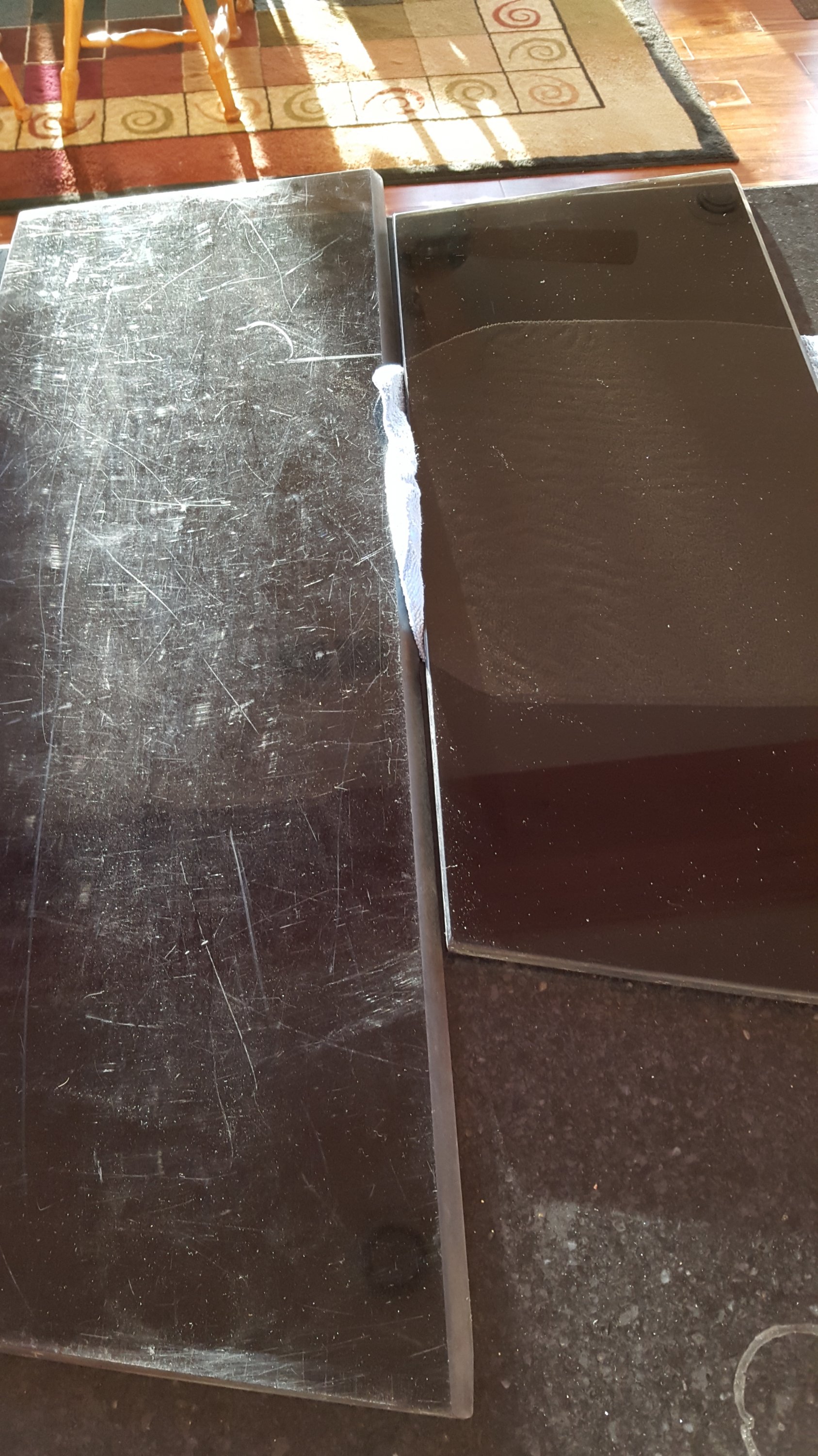

I used the Novus polish on mine. It was a lot of work but they do look much better. I started by wet sanding with very fine sandpaper to get the deeper scratches out. Here is one finished and one I hadn't started on yet....

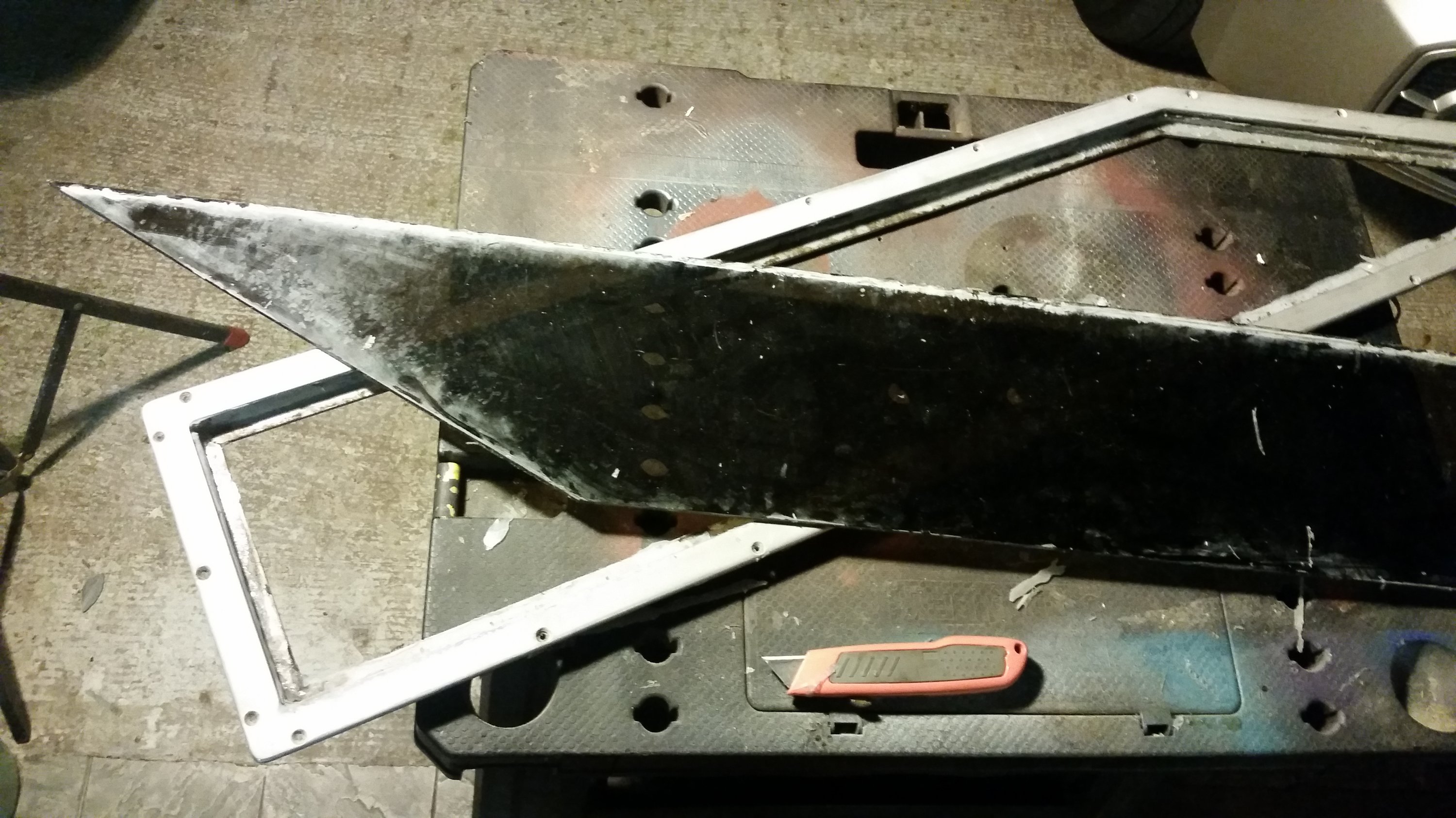

I did this to my large ports. The scratches weren't too deep, but lots of them
Started with 500 grit wet sand paper, then 1000, and 1500 grit. then 3m Compound, and Presta finishing polish on a rotary buffer.
Big improvement.
